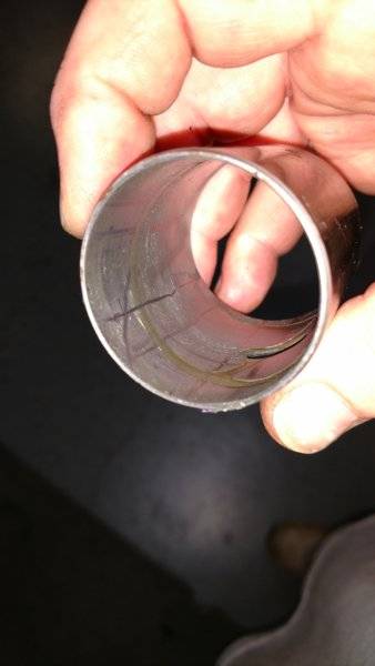

Bought though ebay. Don't if they have a supply of them. Think Ford C6 is the same but not postive.Well now that Fran posted the part number I won't have to remove the tail housing.![]()
Ran a driveshaft that was to short, a screw up.I've been rebuilding TFs for close to 50 years now and never needed to replace the extension housing bushing in the car. If it wasn't bad on the bench it will out last the trans rebuild and can be done the next time. Don't put the drive shaft yoke in dry (like some other things)!

Gotta make sure the oil hole is in the proper position when you drive the new one in, too.Well now that Fran posted the part number I won't have to remove the tail housing.![]()
