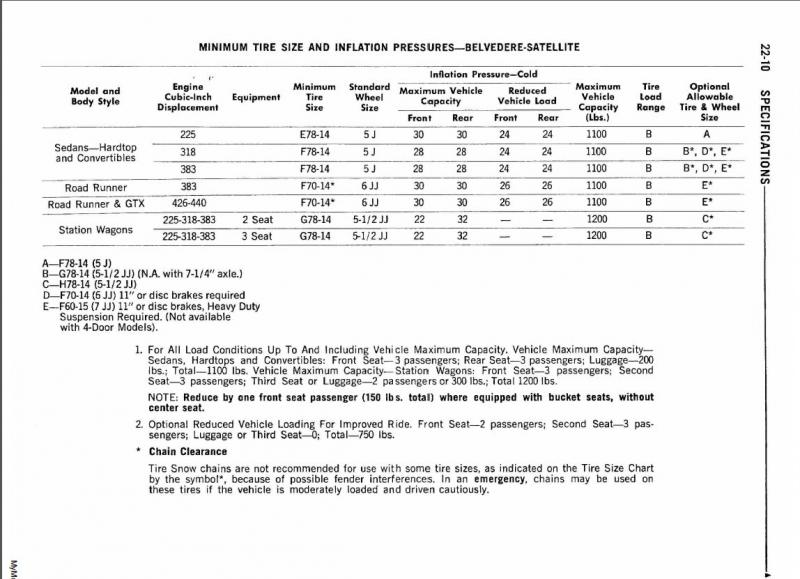

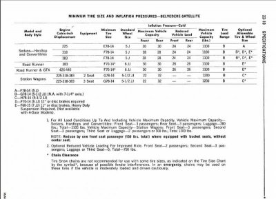

I only have the 1970 specs for standard sizes, which shows a 6" wide wheel. You could (and I would) use the optional 15" size listed at the bottom.

It looks like 215/65-15 would be the closest to fact dia and profile in a radial 15", as far as a redline.
I think?
The chart shows F60-15 as the optional tire. TIRE RACK gives the applicable modern tire as P235/60R15. But if they don't have this in a redline, your pick would be next.
