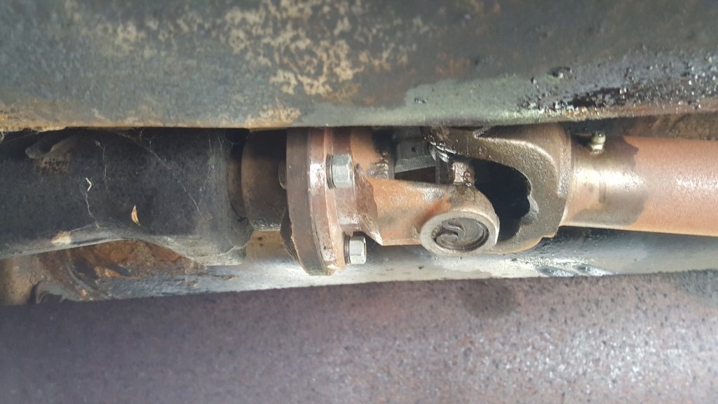

This is a 727 and a slip yoke correct? Has a bad lead right there in the pic and another where the shifter cable goes in.

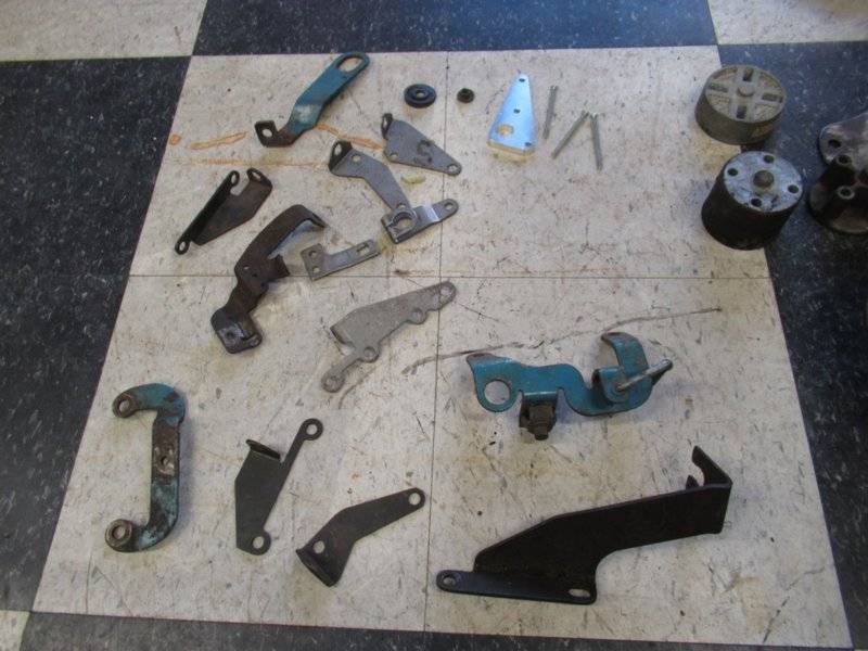

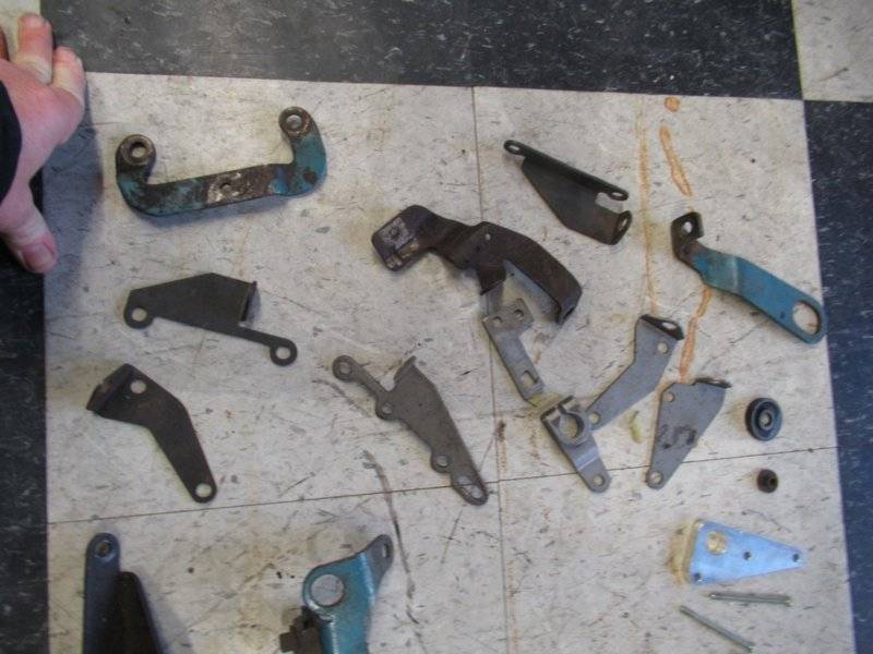

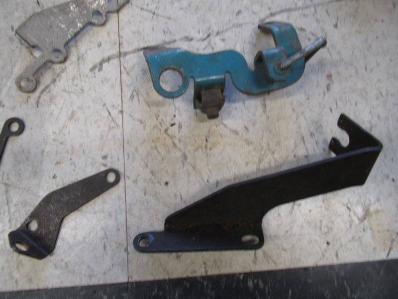

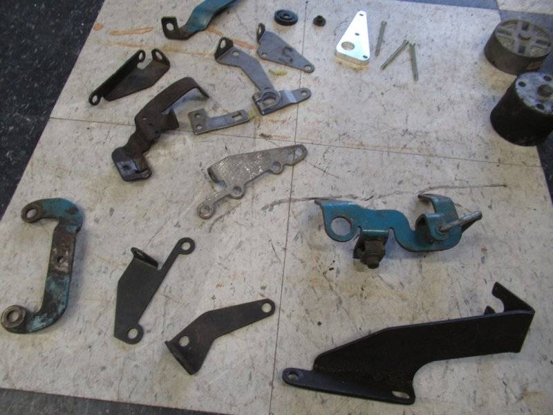

post a pic of the broken shift lever
what is the chassis and application you know floor or column etc 904-727
