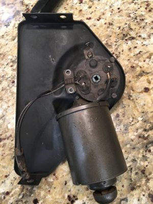

I hooked up a 12v power converter, that I use to test bulb fixtures, to my hideaway headlight motor, and all it did was buzz. I took it apart and sprayed all with electrical cleaner and then grease lubricated the worm drive, and interior sprocket. Still just buzzed.
Is 13.8 vdc, 3amp not enough to power this, or do I need to rebuild? Are there rebuild instructions? Anyone service these motors?
Thanks!!!
the concelead doors system gets a 15 or 20 amps ( can't recall ) breaker in line expecting maybe it sucks 10 amps, so no, I don't think a 3 amps source will be enough
If you turn the manual adjustment knob, does it turn freely? If it is not seized, it probably needs the proper current.

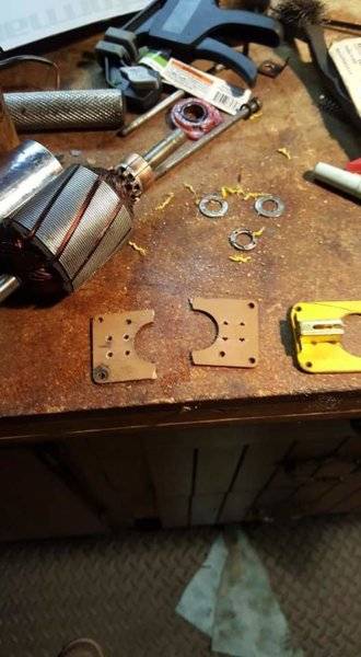

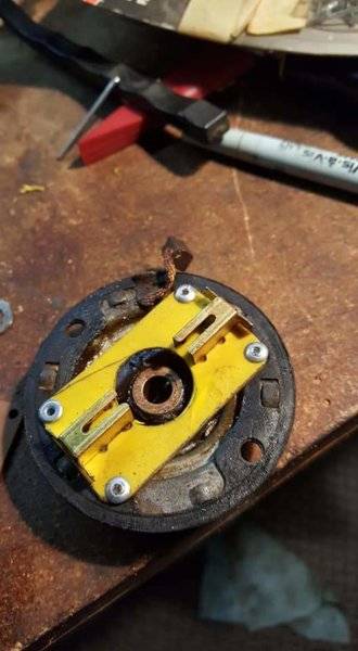

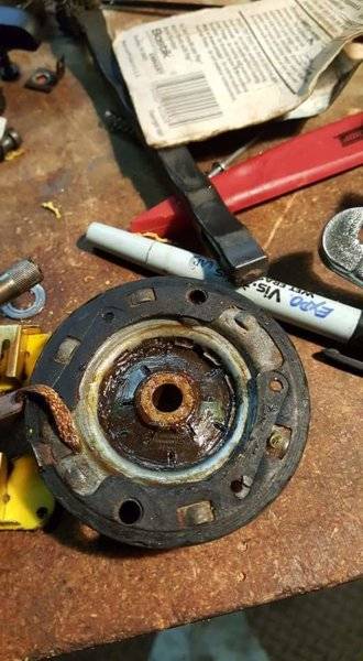

I had the same problem with mine. Was able to open with the knob, but still wouldn't function.
I took it apart and the lower bearing was seized to the shaft. I ended up breaking the brush plate getting the lower bearing out. I didn't ( drill out the rivets first) . So I made a brush plate out of plastic. I believe the original is bakelite. Cleaned the shaft where the brushes ride. And put it all back together and it worked.
View attachment 781002 View attachment 781003 View attachment 781004

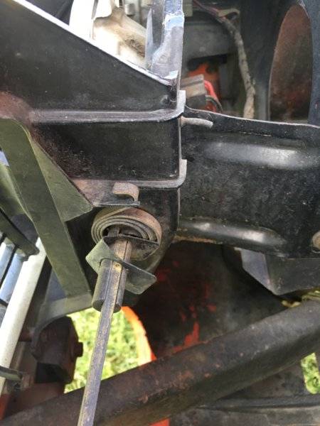

I guess the spring clip holds in the bronze bushing like in the top housing.
My spring seems sprung.

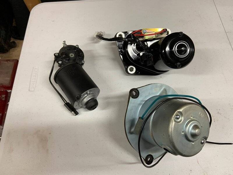

A fella on Facebook repairs and restores these. Topher McGinnis. Nice work.
I been told not to test the motor without proper torsion resistance. It is my understanding that you can damage internal gears and switches.
You can but just move it like a 1/4 turn each direction. I have tested them like this before without any harm. You can use a 9v, it slows it down.
Topher did mine not long ago. Nice work!
I would guesstimate $200-$250 as I paid a flat rate for all three.
