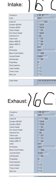

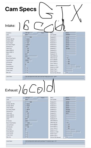

37* total a bit much if accurate and what are the cam spec's. dadsbee think mentioned going to slow for the gears your in. I call it cam lope.

Cam surge, I called it riding the cam back in the day, for lack of a better term. My problem was caused on purpose back then by wanting it faster and faster. To much cam, but I had a high 10 second 383 at the strip. My question is about the dyno sheet. Why did you stop at 6100 rpms as it was still making power?
I didn’t own it at that time, so I’m not sure.
I'm waiting to see this figured out. Was surprised with 4.30 gears you'd have cam lope. I had it with 246*@ .050 with 3.54's. Trying to think what it could be, Ignition?

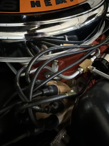

Ok, despite having Covid I pushed through some trouble shooting this morning, which wasn’t wise, I know. But, I believe that I may have found some of, if not all of the problem. First, I hooked the vacuum gauge and timing light up and let the car warm up, then I proceeded to back out the fuel/air mixture screws that were previously set to most vacuum plus a 1/4 more out, to 3/4 turn richer each, which to my surprise didn’t affect the vacuum much at all, but Note-The screws are sensitive when turned inward greater than the original setting. I then test drove it and it seemed to help quite a bit but something still wasn’t right, it was still surging or bucking. I then decided to test a drastic change in the timing, so I started by advancing it 8 degrees more and that made it surge worse when I test drove it. So, I retarded the timing 8 degrees from the original setting and that helped tremendously. There were two marks on the harmonic balance, one could barely be seen and the other clearly seen. I wrongfully assumed that the clearly marked spot was correct which was giving it too much timing and causing what I believe now to be a cam surge. I’ll add that I could hear the cam when before I couldn’t. I ran out of energy, but I will feel more confident when I can drive it more but I think that did it. I do have another question now, though. I am now setting at 12 degrees initial timing and my distributor is turned as far left as the vacuum advance will allow before hitting an intake bolt. I find that odd. I would think that 12 degrees would be somewhat close to the middle of the distributors range of motion. I’m curious where other distributors in 426 Hemi Engines are pointing now and if I could possibly be off a tooth. Please post a picture of your distributors direction and any thoughts. Thanks for everyone’s time!
Looks like you are headed in the right direction.
I wouldn't go by where someone else set there's. Sounds like your going in the right direction. Now make small adjustments one at a time.
