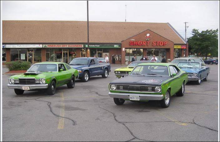

You can put a 275 series tire on that rim.
I had them on the back on my F-Body Runner for a short time and they looked just fine.

You have a BUNCH more room on the back of an F-body than on a 66-67 B-body.
I would have no problem with a 275 on a seven either. Heck, I've got a 16"wide tire on a 12"rim. The question is if a 275 will fit on that rim on that CAR!
