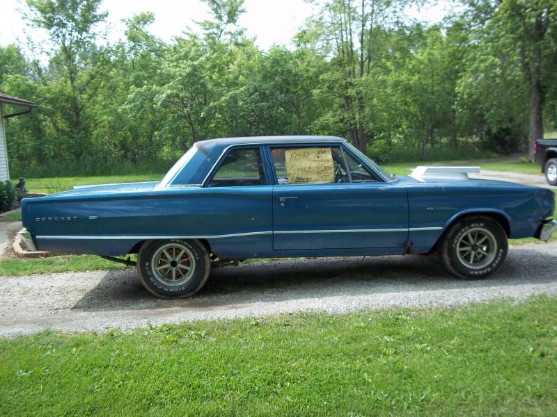

my car has 255/60R15's on the front right now and 285's on the back. No rub issues on either though the back is really close and after putting some new sheet metal the right side touches by 1/8" but I still need to cut down the lip around the opening since the new metal is wider there...but on the original metal there were no issues and I drove it that way (very very briefly lol)
But like I said, I am going with 255's on all 4 corners so that I can rotate as needed. I have no idea what the width is on my wheels though.
*don't mind the fender and hood scoop this was from the first day I got the car*
