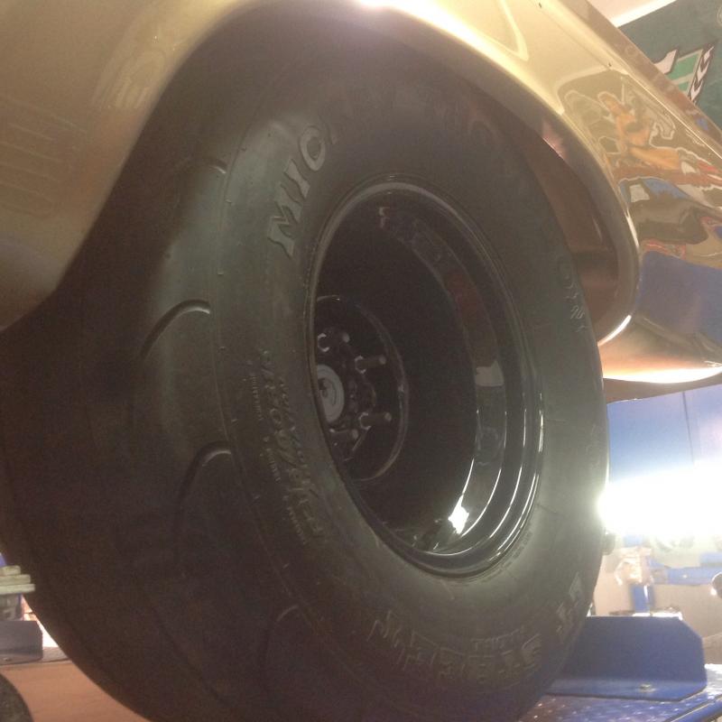

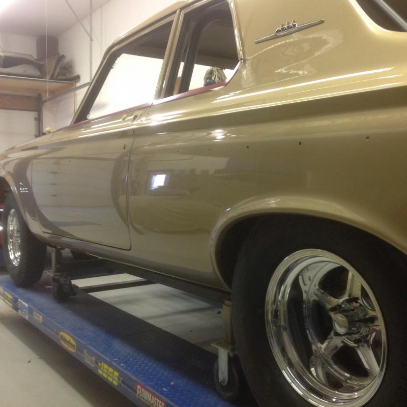

I bolted on the rear street lite wheels today. Not sure which is going to look better, the black 10" wheels or the 10" street lites. I think I'll have to take a pole!

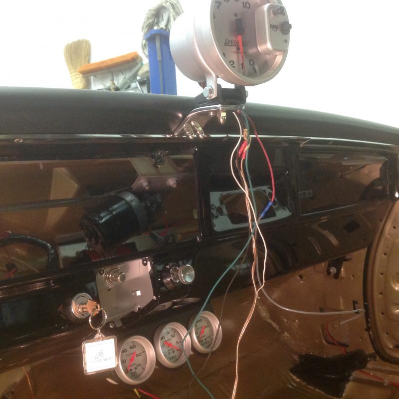

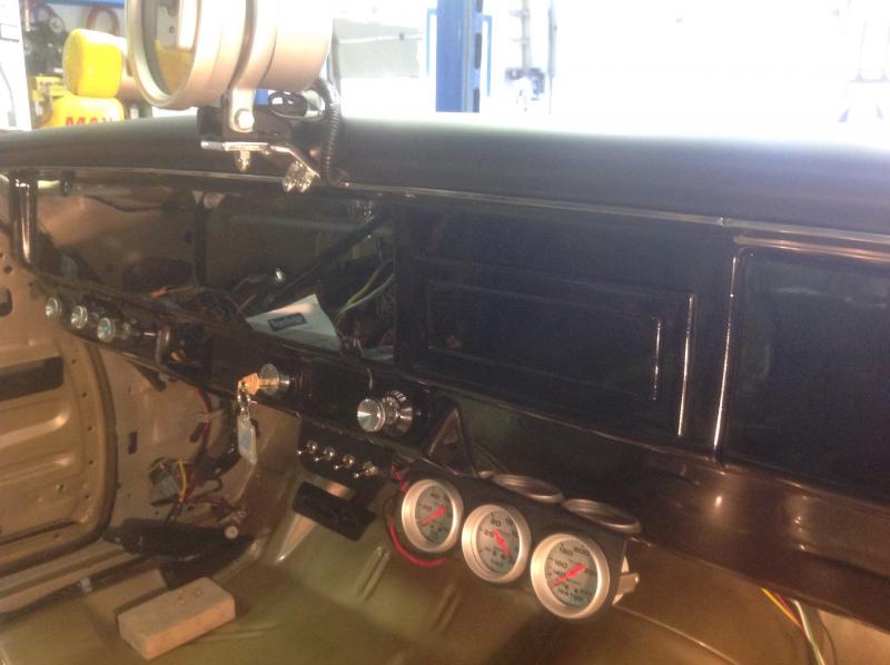

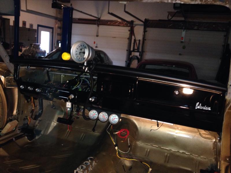

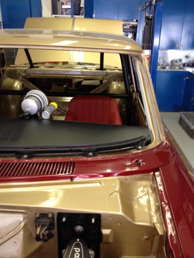

Decided on the tach going here and made a bracket to hold it securely and look in place with the rest.
The one bucket went into place to measure where the belt bracket needed to go. The colors are starting to come together for sure.
The tach and shift light look pretty good next to the matt black dash top. With the engine harnesses I turned them back inside. Cleans the compartment up and still somewhat of a stock look.
Once the dash pieces comes back from plastic chroming the dash can be finished off.

great looking looking build. Since you suggested a pole, I would stick with street lights but it depends on the look you are going for and the end choice is ultimately up to you. This is another one giving great inspiration.
Thanks for the input Super. Once I installed the stainless on the 1/4 it became obvious to me that the Steet lites are the choice. Without the side trim though both looked good.

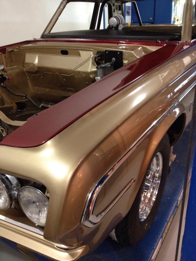

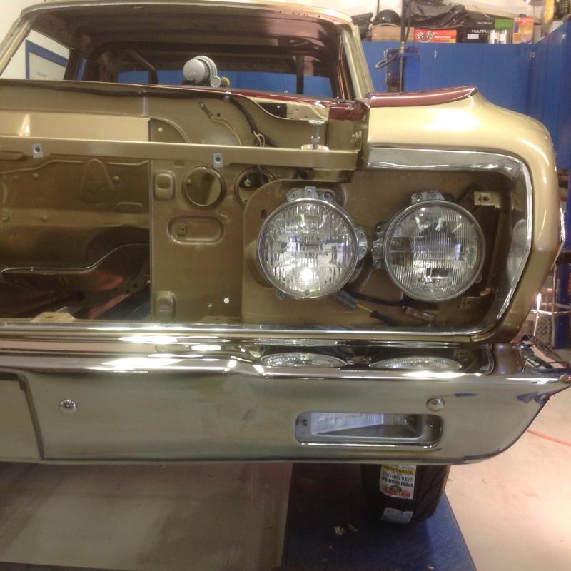

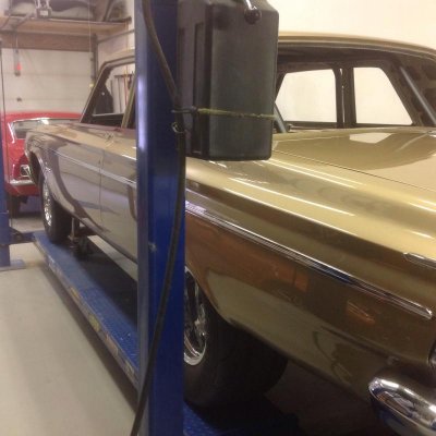

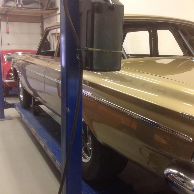

The front bumper and fender eyebrows went on today. The 64 is starting to get that completed look. image.jpg

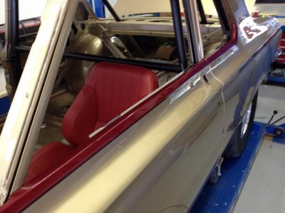

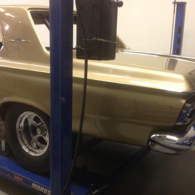

Do you have a full on side shot?

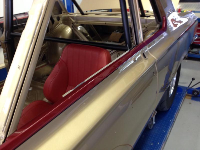

For sure Conv67, it is starting to come together. My parts shipment is sitting at my US shipping address now so a quick road trip on Saturday. And a wedge will be sitting in place within a few days!image.jpg

Today's plan was to make a toggle switch plate and get the switches installed.
A spare piece of aluminum on the bench fit the bill. Job complete. Once the bezels get back from re-chroming the dash will be done.

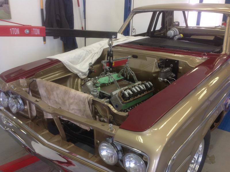

With the electrical out of the way I figured I might as well start getting the motor and trans ready to "finally" reinstall.
Time for things to go back into place.
Back in place and no mishaps!
Tomorrow is another day and things can start going into place. A nice stage to be at.

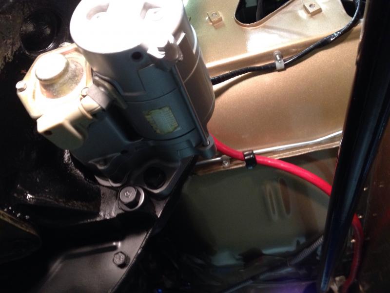

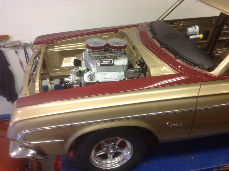

Some good progress on the 64 today. Engine is bolted in tight, starter in place and wiring to it is routed securely. Once that was in place I slid the new 2" TTI Headers into place. These have to be the nicest fitting headers that I have ever worked with. image.jpgimage.jpgimage.jpg
Nice stage to be at alright! She looks great. You've got a lot done in the last while. Won't be long now and you'll be burning rubber!
LOL Gdrill. Can't finish it up too soon, this is fun stuff and I want it to last.

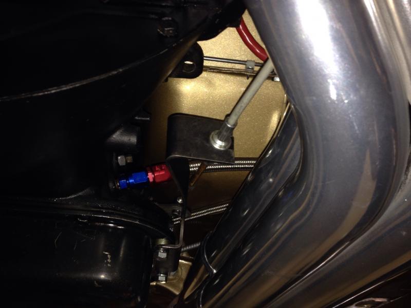

Got the Hurst quarter stick into place today, cable through the floor and trans bracket slightly modified so that the cable cleared the TTI's.

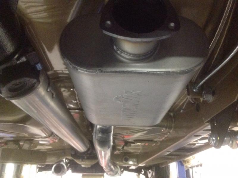

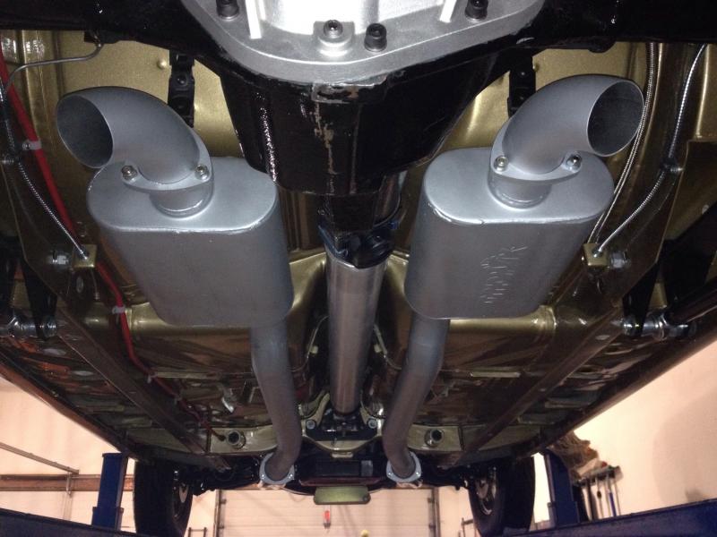

Picked up some 3" tubing and mandrel bend pieces today. Time to start fabricating the exhaust, which will be simple. Dyno Max 17221's that will dump just before the dana.

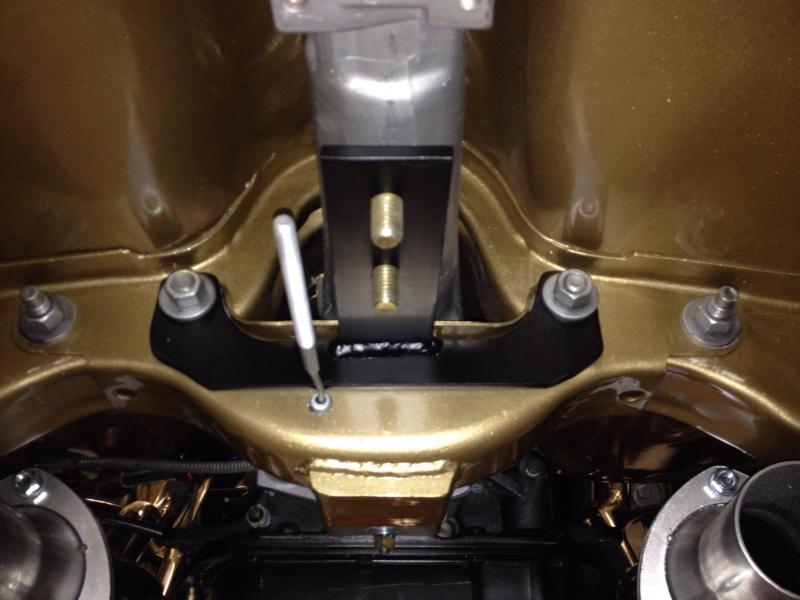

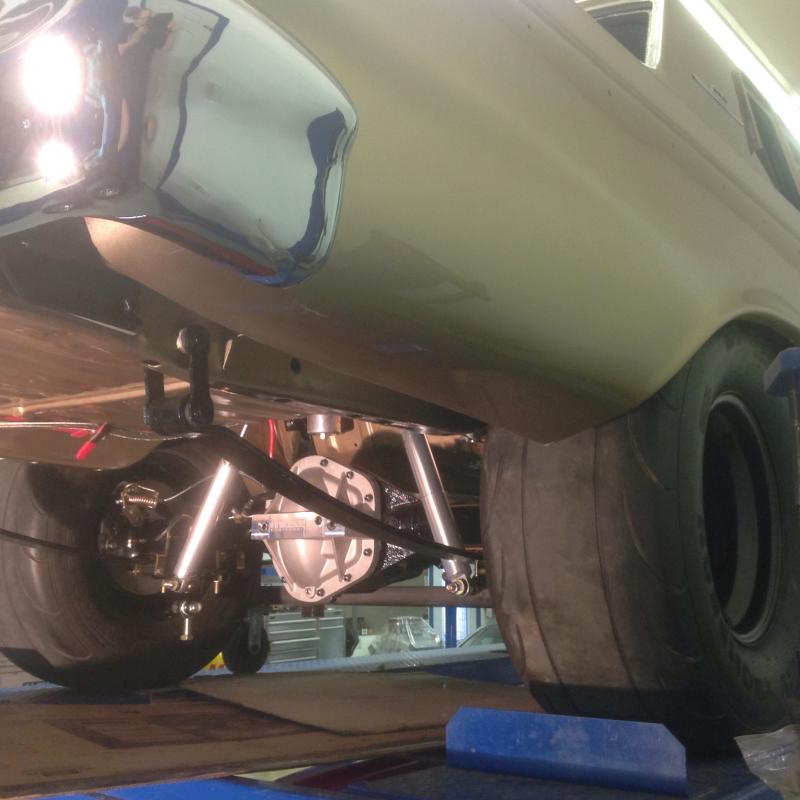

Good eye Kjalltrac. Yes it has the newer K frame. Lots of room at the right front corner of the oil pan and tight at the firewall. Along with that comes a modified trans mount.
You can see where I boxed the front and it holds a 1-bolt mount and I'm starting to build a driveshaft hoop that comes off of the rear.

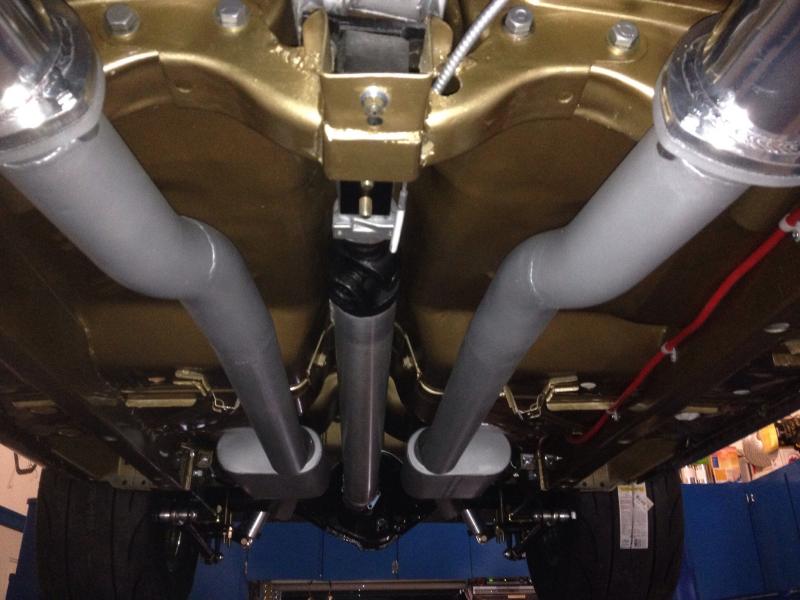

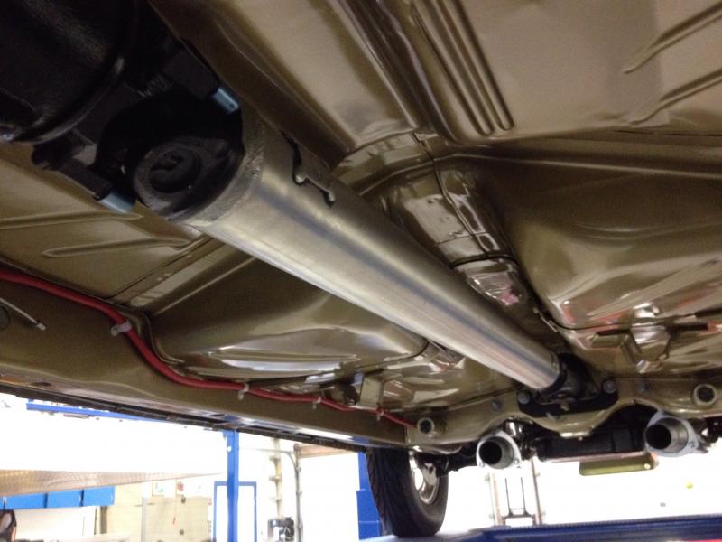

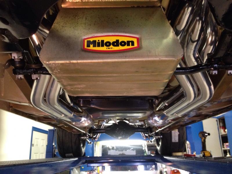

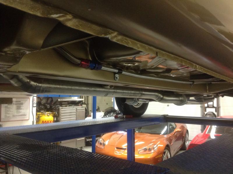

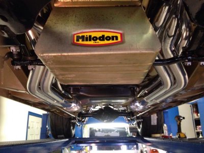

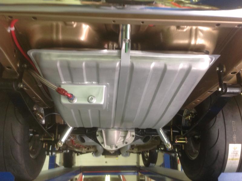

As for today's progress I got the fuel tank sump done and only one side of the exhaust fab'd up. Most of the day was friends stopping in and that was all good too. image.jpgimage.jpg

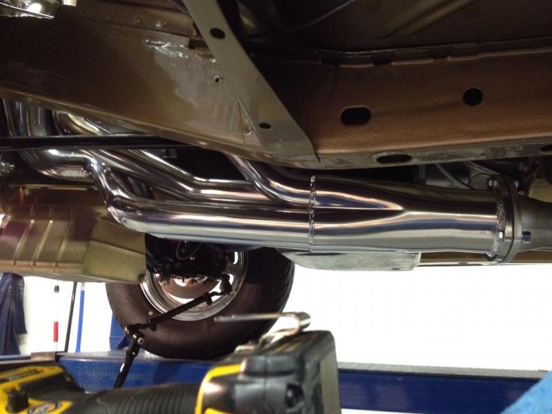

Exhaust system is done. 2 / 3.5" TTIs, 3" pipes through Dynomax 17221's and dumped. 6 of pipe, 2 180 degree mandrel bent pipes, 4 flanges and some cutting welding and grinding. image.jpgimage.jpg

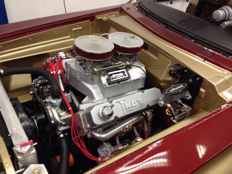

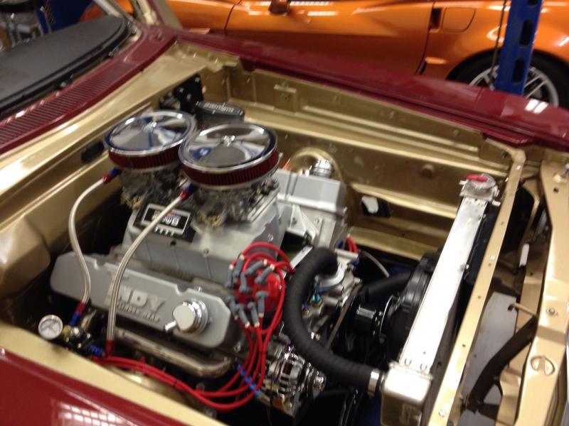

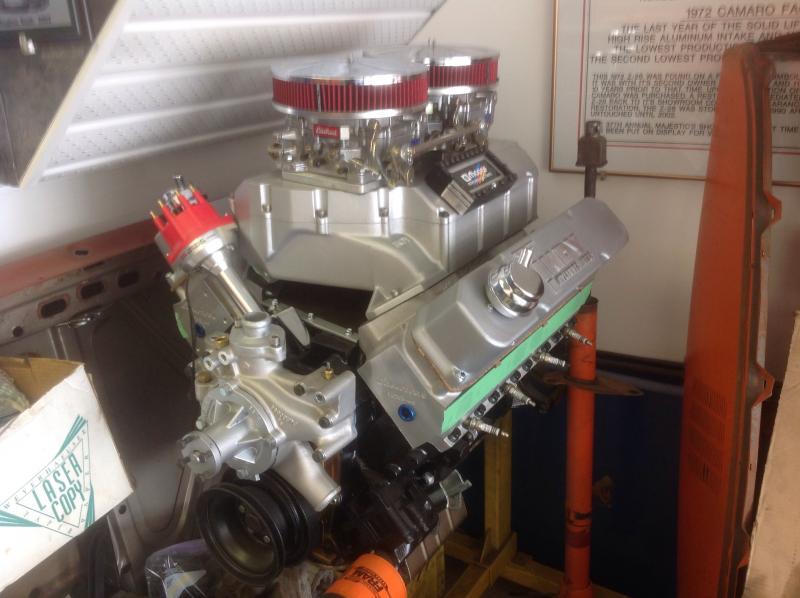

It's been a few days since I have made any updates but there has been lots going on. The 526 is ready for the fluids and to fire up!
The underside is complete too with the fuel tank going up into place today.

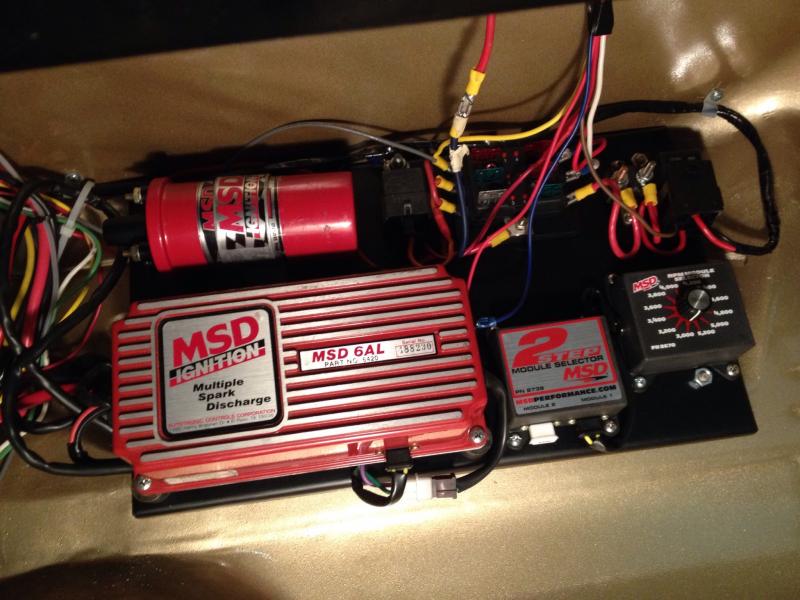

Finished up wiring the 2 step to the trans brake, the line lock and some other loose ends today too. It's a bit busy but all easy to get at.
What an incredible build, this car is stunning and looking mean as hell. That Hemi sure sets off the engine bay with that refrigerator looking intake haha "Love it"!
