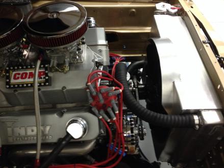

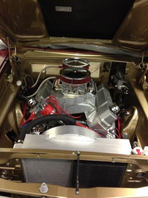

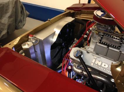

It's been several months since I posted on the Plymouth, mostly because the project is pretty much complete and it was time to enjoy. Recently I did fabricate a shroud for the fan though. I started out with an electric fan but I was seeing temps getting up in the 200 to 210 range. I switched over to a 19" clutch fan and the temp never got past 185. I'm expecting it to run even cooler with the new shroud. The next item on the agenda is to either have a custom cam ground for this stroker or build another short block with more compression. If anyone has some specs on a solid roller cam that will let this 526 with 10.5CR breath shoot them my way. image.jpgimage.jpgimage.jpg
Very nice work on the shroud.
