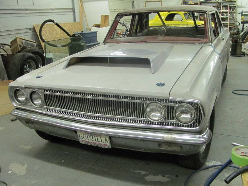

Did a little more work on the 65 car . Got all the grill and bumper mounted starting to look like a car again . The hood gave me a fit , it's on but will need more work . The passenger headlight bezel will be restored soon .Just wanted to see everything together . Front plate and plate bezel says Big Green and Mean , Godzilla . Good name for it . Will paint it A shade of tropical green , much brighter green than Lime green . Both fenders will be changed out later , they have a long bow in them that I could not get out . Thanks John

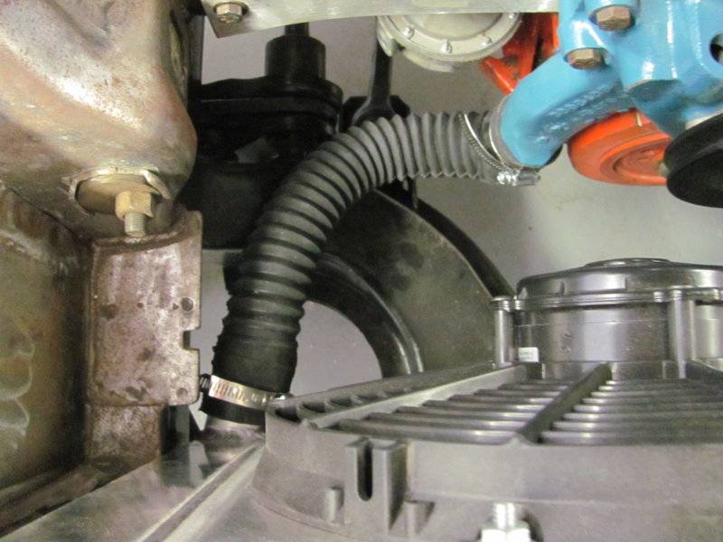

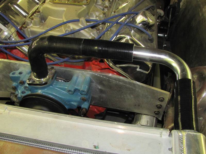

Did a little more work on the car . took measurements and ordered lower and upper hoses for radiator . bottom hose I used a convoluted hose with wire in it . that would help keep the lower hose from being sucked in and restricting water flow . On the upper hose I ordered several pieces from Speedway motors . using metal and silicon hoses I was able to get a good fit . Will work well and looks clean .

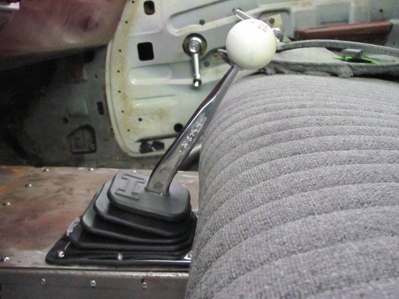

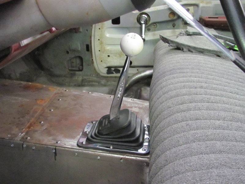

but I found and replaced the 6 inch shifter handle on the Hurst push down shifter I have in the car , you would always have to lean forward to shift to first or third . I replaced it with a 8 inch stick with a curve in it to move it back closer to the seat . The new stick works great , no more having to lean forward to shift , just lay your hand down and change gears . First pic is old shifter and handle , second one with it in first gear and last one shifter in in the second gear position . works great .

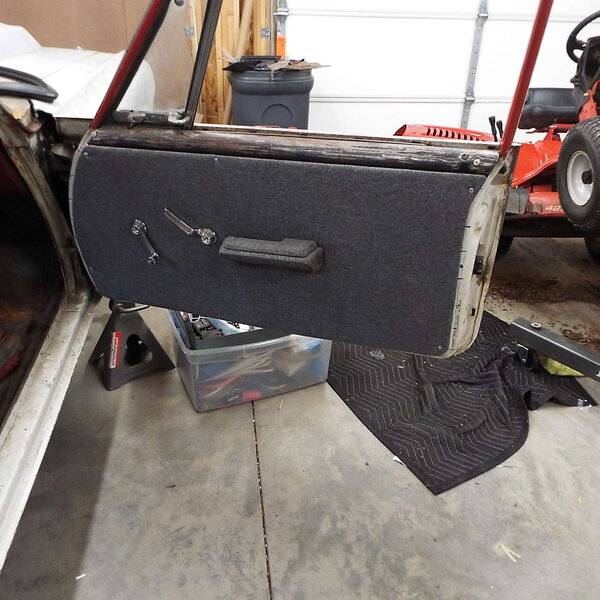

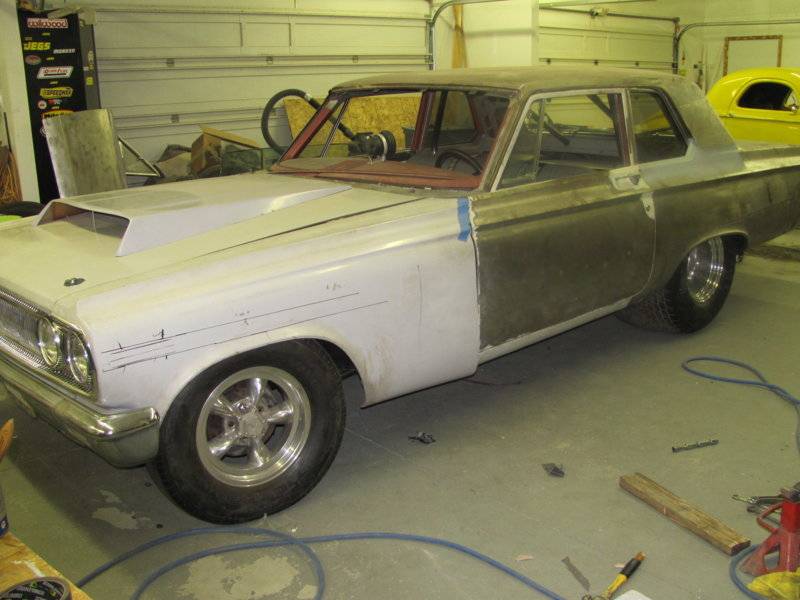

Ok . Got the new garage sorted out and started to do some small things . Having to finish the garage the 65 sat on my trailer . the tarp leaked and the top was a black rusty mess . I sanded for 2 days and put 3 coats of etching primer on it . Starting on the rear right side sanding and coating with primer . Ordered a 30 inch block sander to do the lower quarters , to get them smooth . Did a little inside work , covering hard board with foam and the gray and black tweed the seat is covered in . both door panels, the panels over the tubs and the package tray . I am going to use a black headliner with black arm rests with chrome bases . Headliner goes in before the windows .. right now it's 90 and very humid .....
Did a little more work on the 65 car . Got all the grill and bumper mounted starting to look like a car again . The hood gave me a fit , it's on but will need more work . The passenger headlight bezel will be restored soon .Just wanted to see everything together . Front plate and plate bezel says Big Green and Mean , Godzilla . Good name for it . Will paint it A shade of tropical green , much brighter green than Lime green . Both fenders will be changed out later , they have a long bow in them that I could not get out . Thanks JohnView attachment 754719 View attachment 754720

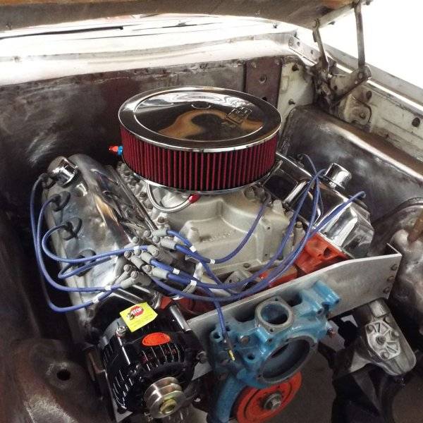

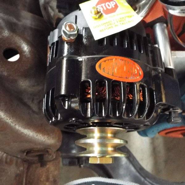

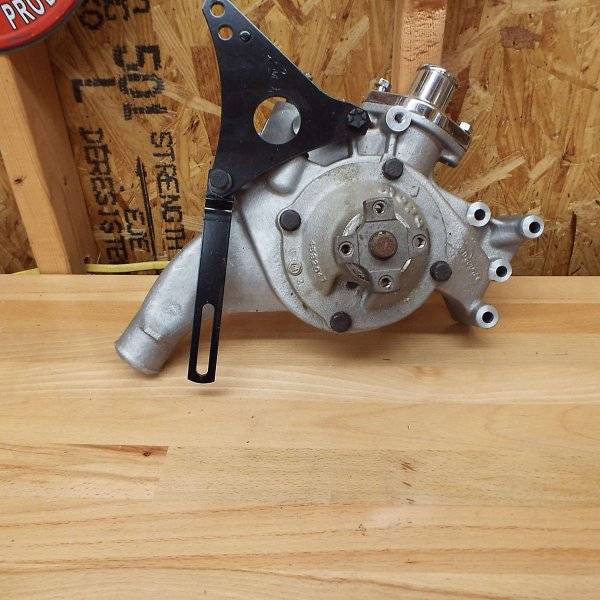

Ok, I was able to start ordering parts. Got a Powermaster 165amp alt. has to cut the motorplate to get it to fit, Ron Francis wireworks kit, going to rewire the whole car. Quickfuel pump 130gph and will use #10 hose. Fram fuel filter. Picked up a aluminum water pump housing from 440 source , will use water pump that came with crate Hemi. Ordered a Milodon oil pan and it's been on backorder for 4 months. Got a windage tray that will fit the new pan. A new mini starter and all new gaskets. New valve cover breathers for the HEMI valve covers . Have new fenders being made .

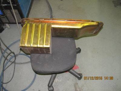

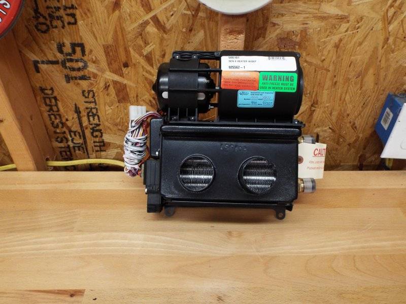

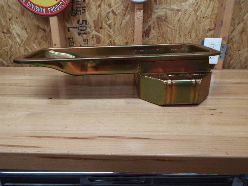

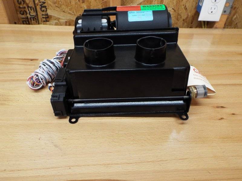

Well I ordered more parts that will be needed, knowing that it will be driven when the weather is cold, I picked up a Vintage Air heater and defroster comb All the old stuff was thrown away years ago. I also ordered a new oil pan that was 5.5 inches deep, the one I have was for a 4x4 deep sump and was 8 inches deep only about 3 inches of ground clearance, and only lost 1 qt of oil capacity, 8 qt versus 7 qt plus oil filter. It took 6 months to get it from Milodon and am still waiting for pickup and dipstick, on backorder. more parts to come, tried to order a new set of radial pro street tires and my order was canceled twice, due to no stock, talked with Hoosier and they do not know they will make another run of them. First pic is the deep pan and then the new one. It has doors that trap the oil in the back and will keep the pickup in oil.

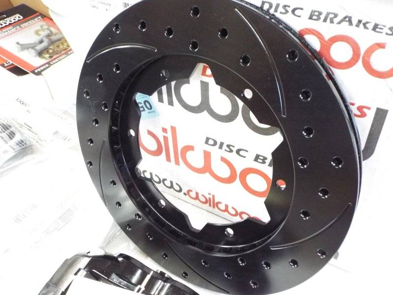

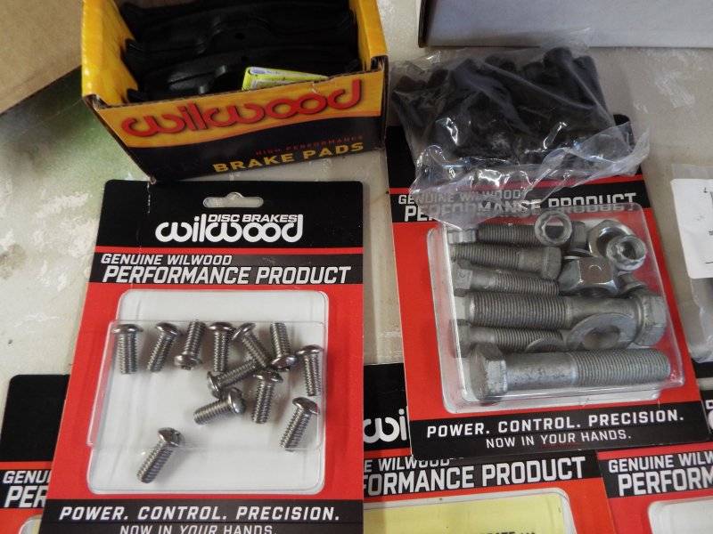

Still waiting for the oil pickup for the new Milodon pan, ordered a dipstick tube straight from Milodon, took 3 months and they finally shipped last week. Ordered new tires from Jegs 5 months ago, took my money on the order and still tells me next month! Picked up my new fenders from Sledcity Fiberglass in Ohio. When we got back from our trip I had knee surgery which put working on the car off for a while. Last week I started to work on the fenders. Ordered front brakes for it from Wilwood, unpacked and everthing looks great. More from them to come!

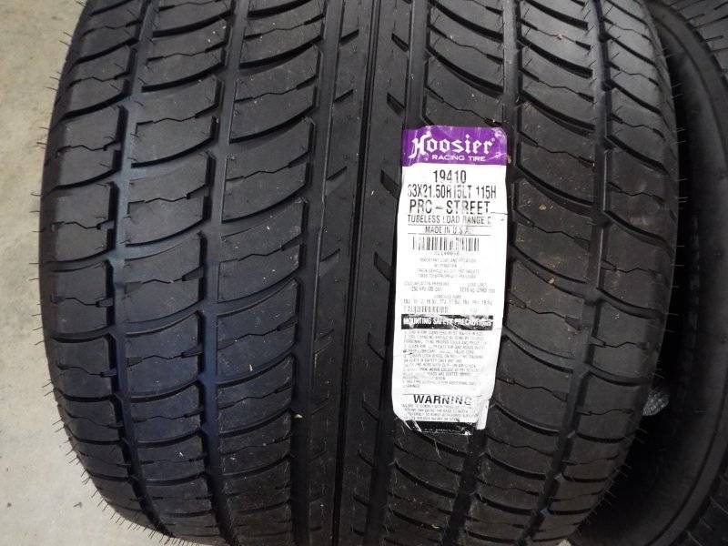

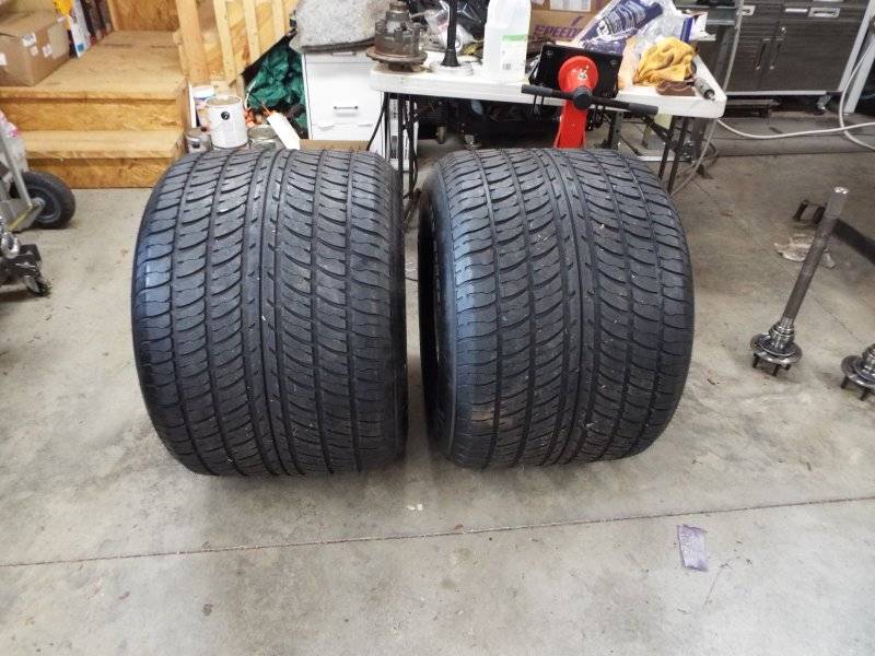

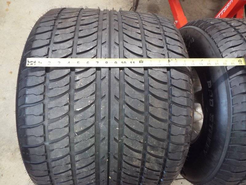

Received a text that my new tires were being shipped. The old ones on the car are so old that they have started to dry rot and Cracked in the treads new ones are 33x21.5x15 Hoosier Pro Street Radials . One more piece of the puzzle !

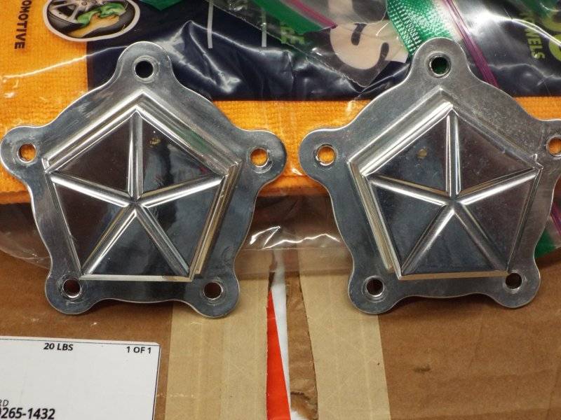

Ok , worked on getting the old tires off, it was hard to do by hand but with a little luck and a few choice words they are off. I am working on polishing them and the center caps back to being shiny again before mounting the new tires on. th wheels are 15x18 and look like aluminum commodes.

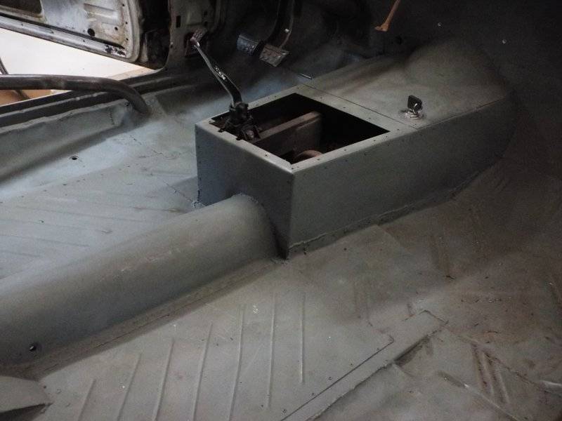

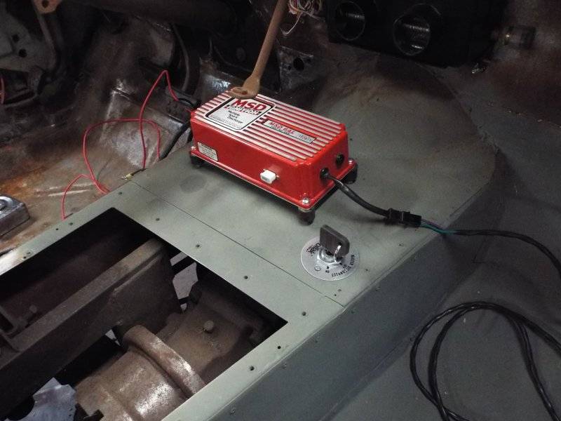

ALSO POISHING THE CENTER CAPS , WORKING ON INSTALLING THE HEATER AND DEFROSTER UNDER THE DASH. SANDED THE FLOOR TO REMOVE THE RUST AND PUT 3 COATS OF PRINER IN THEM. INSTALLED A POWER CUT OFF SWITCH ON THE SHIFTER HUMP, ALSO WILL PUT THE MSD6 UNIT ON IT, THIS WAY IT WILL BE AWAY FROM THE HEAT UNDER THE HOOD .
Got the tires mounted and seated, Guys at Mavis tire made it look simple. Also ordered a new dana 60 with axles from Mosier and it looks great, called a couple of Shops to get it set up and was told $900.00 to do the job. WOW last one for me was in AZ about 4 years ago $350.00, Atlanta shops will not get my business ! Will haul it to my friend George in N.C. and get him to do it for me. Tires are 33x21.5x15 tread width 17 inches and 22 inches wide side wall to side wall on a 15x18 wide wheel

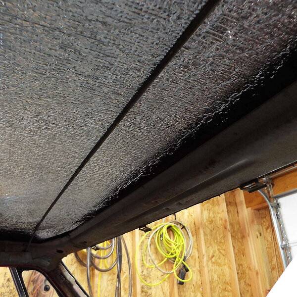

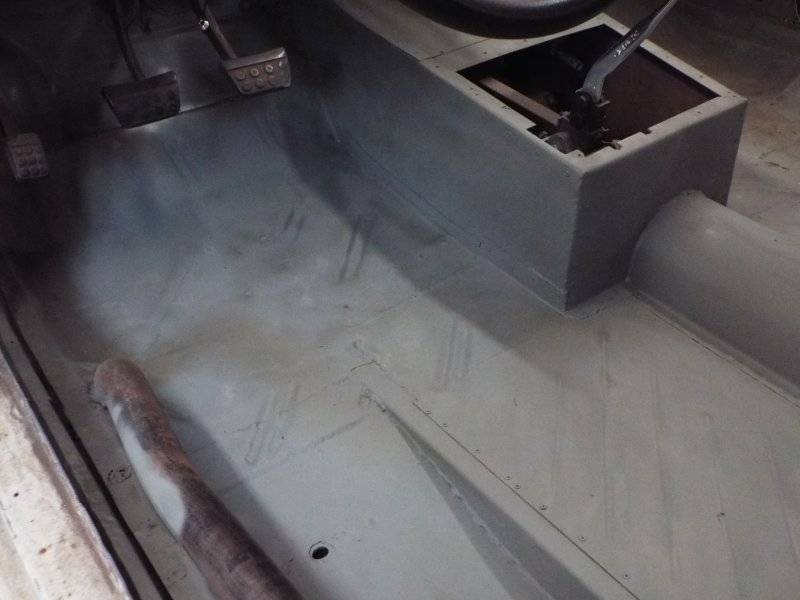

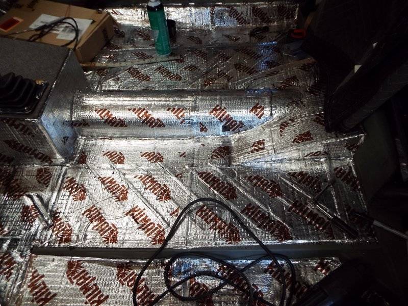

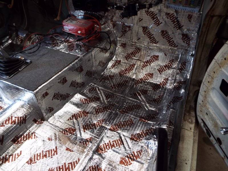

Started to work inside first, I know that is not the best way to do it but it's cold here to paint. Put the heater and defroster in place, put the fuse panel in place, covered up the floor with kilmat sound and heat killer. It's hard work for a old man but if has to be done. Took the dash apart and started to polish the pieces Carolina Custom made for me years ago. Will start sanding the dash for primer soon.
