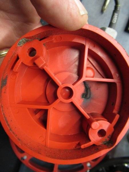

Forgive me for being naive but what am I looking at?
Methinks...that's the inside, of a distributor cap.

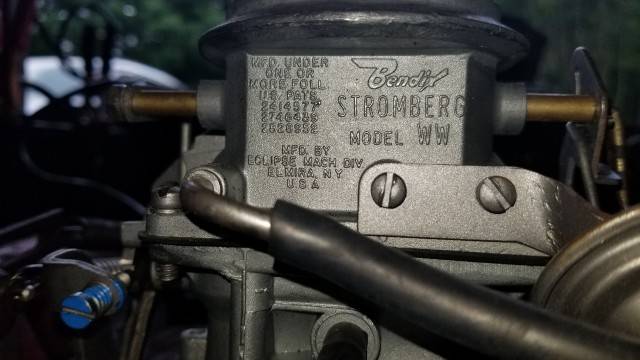

I've attached a picture of the identification plate on the carb in case it helps anyone.
https://www.carbkitsource.com/tech/Stromberg/StrombergWW.html

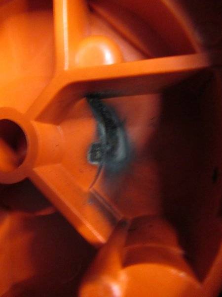

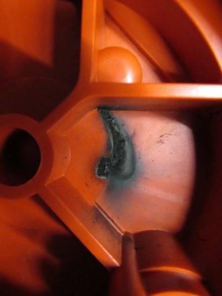

My car died on the way to a club meeting and I was able to roll into a parking lot.Cranked and cranked,,,,,ran for a few seconds and died.Checked all the normal things but I'm ABnormal:rolleyes:.Pulled the coil wire off the distributor and checked for spark and that was good.Pulled a plug wire and checked and the spark was so weak I could hardly see it.Cap looked good,made sure the the springy tab was touching the cap and nothing.
Called my daughter to give me a ride back to my garage to get my rollback. When I finally pulled the rotor off you see what I found,the spark was going through the cap to the distributor shaft:cursin:
This sounds like what mine's doing, but I posted a pic of the cap and it looks great. No burn marks at all.
