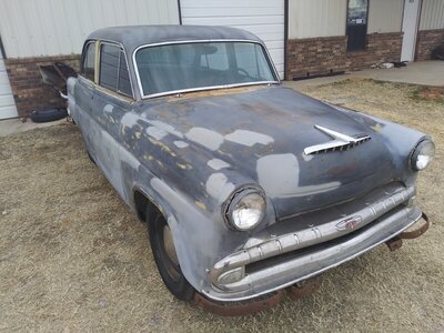

Been wrenching on the Hudson the past two weeks. Deciding if I want to go electric with it! I have no compression in two holes, and 60# or less in the other four. Pulling the head off this weekend to check for bent or stuck valves, ring damage, or hoping just a blown head gasket. I know it ran six years ago, I heard it.

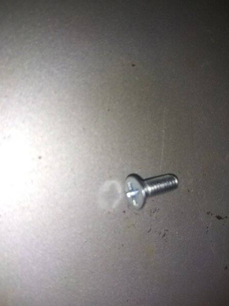

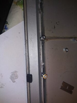

A little more on the console. The console door I'm working is is super-nice; save for the hinge studs. All were missing but one. So, I got some screws the same length as the stud, plus nuts and some epoxy, and glued them where the old studs had broken off. Glued all that up tonight. I'll see if this brilliant solution works or not after work tomorrow. If everything bolts up and holds, then its on to painting the top silver and black.
I verified the studs were going to work by attaching the hinge, off the console. I decided to let it sit until tomorrow, to ensure the epoxy is going to hold. Then, attach to the console to test; then paint and final installation.
