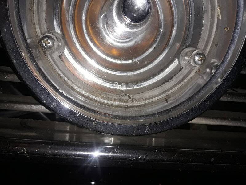

If your interested they re-pop front hood trim. I put a pair of NOS signal lens on my car with a little (3/32") clear RTV. Put under button on outside, to prevent the vibration from cracking lens. One cracked other still OK.
No need for new hood trim Fran, no dents in it and as for the signal lenses, I think I will take them back off and do similar...as that center rattles and I'm terrified to try and tighten it any further than Trim Parts did during their assembly.

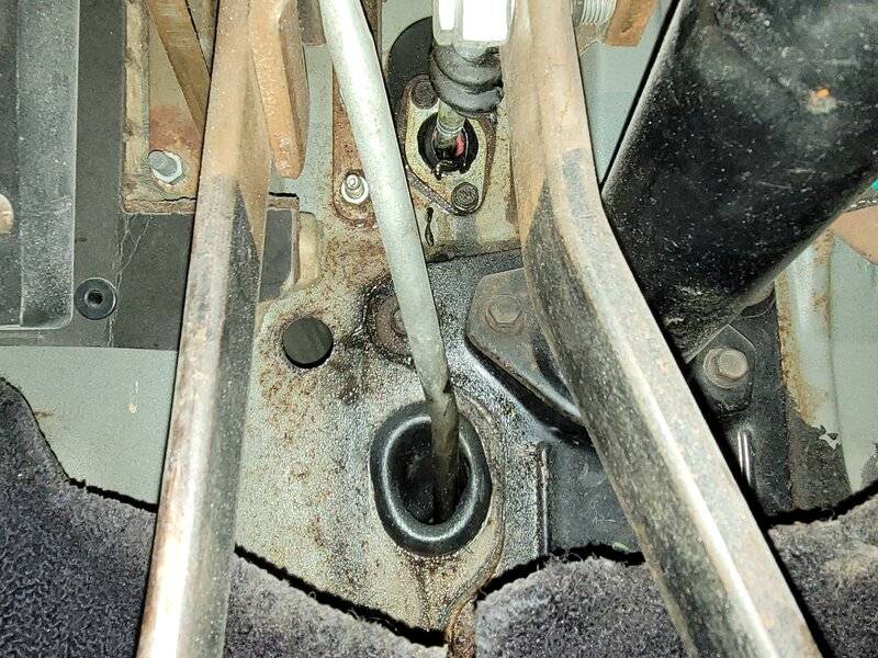

Also,I would have a look at the master cylinder from interior side to make sure there is no leak inside vehicle. Just a thought.
BINGO ! Thanks!

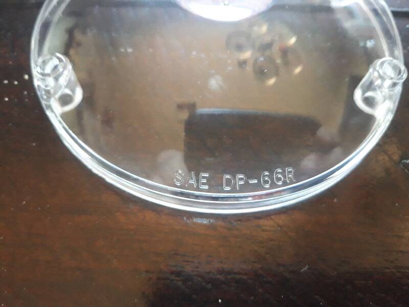

I did buy a set of the repops for that someday just in case I need them . Pics of both for review / reference
I have given thoughts to buy a couple NOS,,,,Also just in case . They are not that hard to find

Got to thinking about the signal light lenses rattling when I was putting them in and tried to snug them up, then Fran's comment out his "little dab'll do ya". Took them back out and apart intending to tighten them up some more.
Then I took the originals apart and found the chrome dome has foam in the back and the retaining nut has a rubber insert.

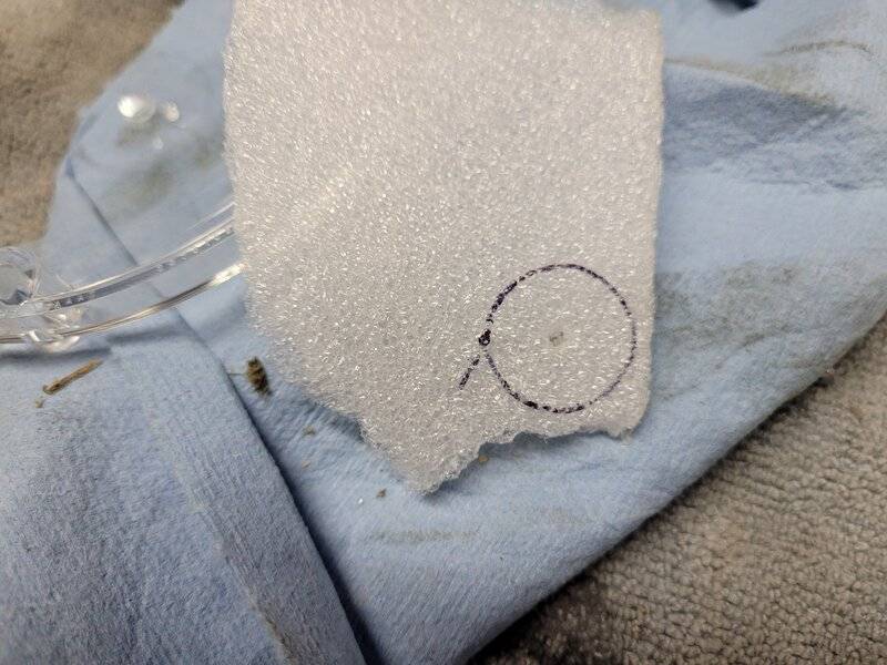

Found some appropriate foam.
Marked for cutting.

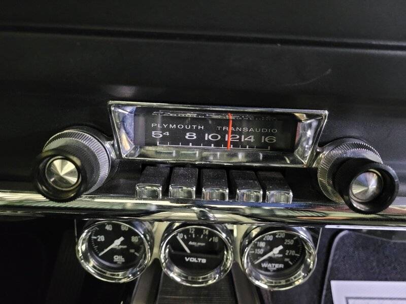

Nice original radio, even works!!

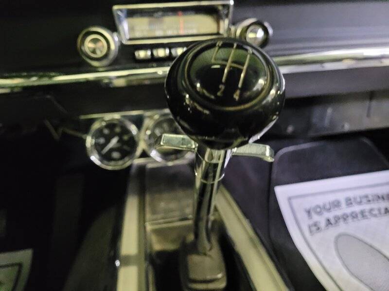

Original Inland shifter with the reverse lock out feature. Sloppy as **** they are, but it's correct vs a Hurst.
