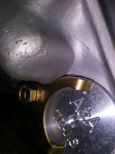

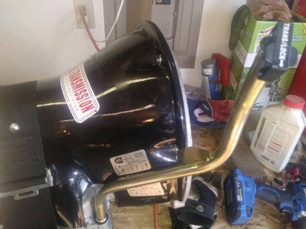

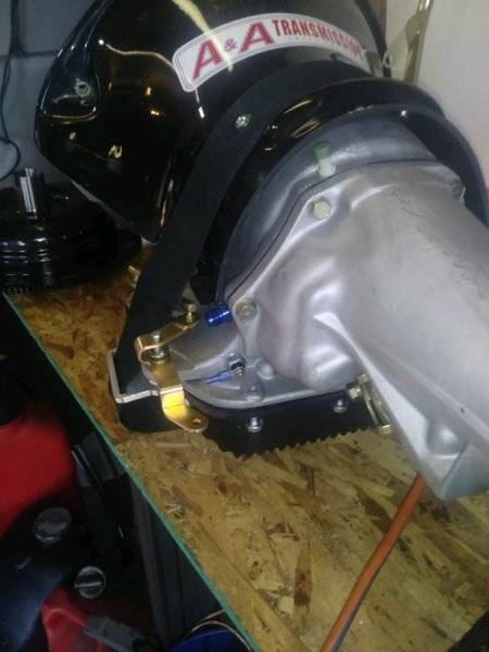

Been a while since I did an update or worked on the car, trans is on the way, also got an alternator from a friend here on FBBO. Only thing left to do is install master cylinder and new front brake lines then I’ll get her fired up.
looks like a good trans, watching for the ignition...
I bought it 2nd hand, never been run. Had a member go check it out for me and he says it all checked out, the guy is retired military so that made me feel better about it. Should be here early next week, if it is what the invoice says it is I got a nice trans.
I hope it works out man.
Got some good advice from a couple members so i used PayPal with buyer protection and my credit card, so I should be good but I’d rather the trans just be what it’s supposed to be and not go through the hassle. Worst comes to worst I have an address........

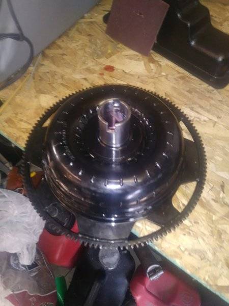

You’ll want a 9.5” body converter over that 8” in your tank. I gained almost 5MPH switching.
I was thinking I might switch out to a different TC, wasn’t sure which size I should go with. I think this one may have a bit too much stall for me anyway, 5500
