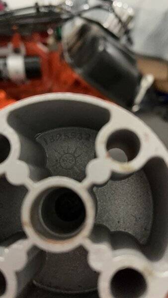

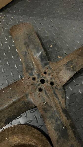

Picked up a fan and correct spacer
Wow! Nice find. I'm going to be starting on a 66 Belvedere II sometime soon.

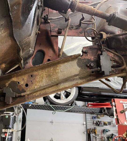

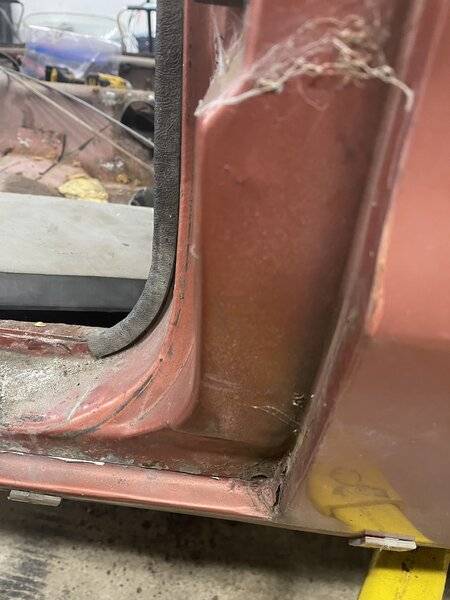

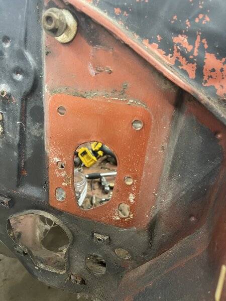

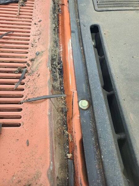

Got the car on the hoist to strip it down for the rotisserie
Car has original paint on it so I wanted to take some pictures to document the factory overspray etc
Great pics, thanks. Sir, a newbie here, so I see undercoating in the wheel wells as well as what appears to be black paint. Same in the engine bay, so , was the engine bay painted that way from the factory or was it painted maybe by a previous owner. I am aware the factory painted black around the headlights and rad. opening over the original color, but not the whole bay area...thanks...
Yeah
Someone just threw some rattle can paint on there

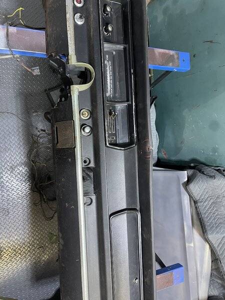

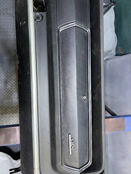

Time to try my hand at cleaning up the dash
I have all new trim, plastic and dash pad
Here is the starting point:
Doing some paint testing today to match the original texture and colour
I have seen most of the posts about good paint to use - tried a spot with “satin black”
And that was way too shiney
Don’t hesitate to have a paint shop mix you some up, some can even put it in an aerosol can if that’s a problem. Paint colors are listed in the FSM for a reference on your part numbers... Looking good!
