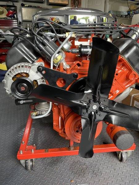

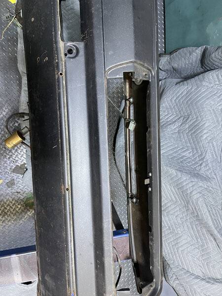

Some more parts on the engine

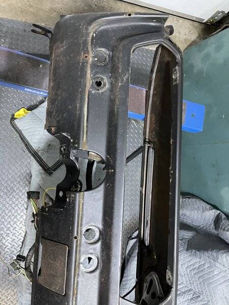

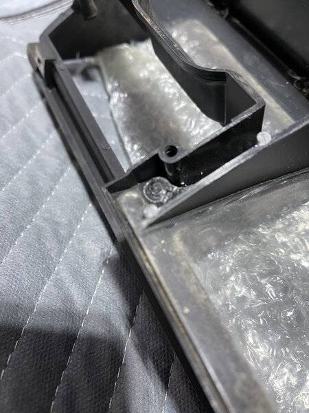

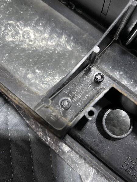

Having a bit of an issue trying to figure out how to remove the old lens from the cluster as I want to reuse it in the new guage cluster I bought. Seems there is melted tabs in my way !

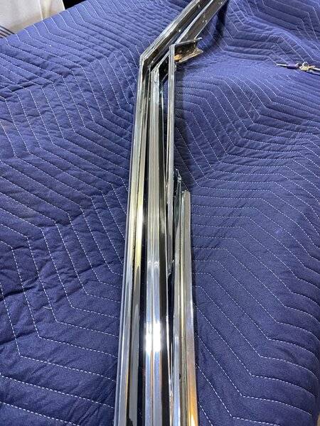

he charged me $50 to do these

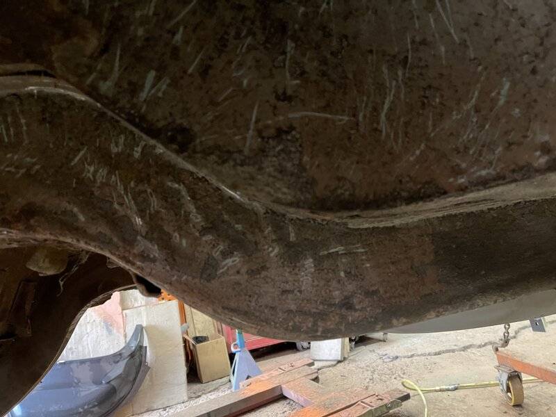

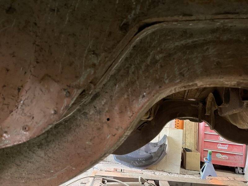

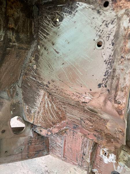

repo metal : passenger side floor pan, driver side rear footwell, trunk pan (some bubbles coming up under one frame rail so might as well put a new pan instead of cutting and welding) and new shock towers (only one has a rust spot but will change both) . Also needs a hole patched on one rear frame rail under the gas filler neck and a spot in the front inner side that needs fixing, also changing the torsion bar cross member (since it has a small soft spot on top where the floor pan was bad right over it )
also scraped some of the sound deadener off the car. You can see the dip colour and nice rear frame rails
