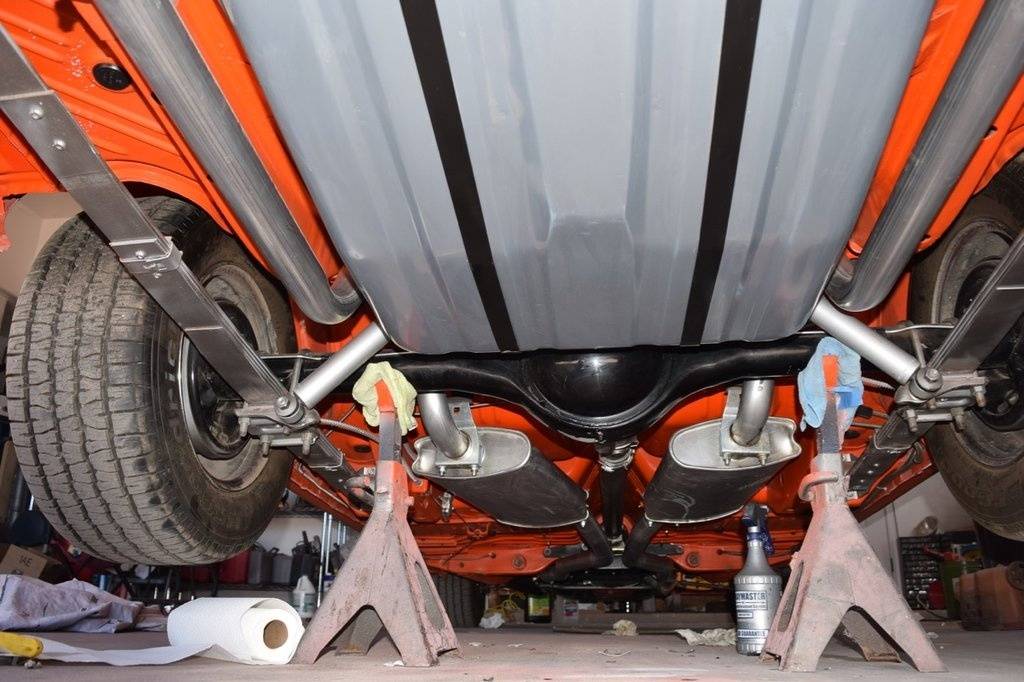

Tried to work on the vibration some. Jacked up on stands and ran it at 3000 RPM in Drive. I rotated the bands a bit at a time until the mufflers got hot and burned my arm. Swore and called it close enough. It is smooth enough that I will drive it at 75 on the freeway now but it is still not quite right.

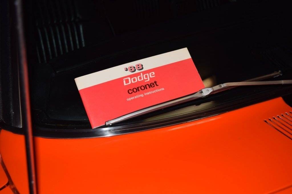

Sometimes just the little things are all I need to be happy :) Absolutely mint original condition with the perfect yellowing of the pages.

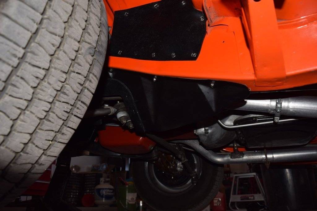

Been driving more than working on it these days. I did get the starter shield and front strut shields restored and installed.
She also now has the correct wire routing into the left fender since the crash in the 1970's. The factory replacement fender did not have the right hole and a missing plug. Took me months to find a plug but I finally did and I drilled the 2" hole and ran the wires the way the factory intended.

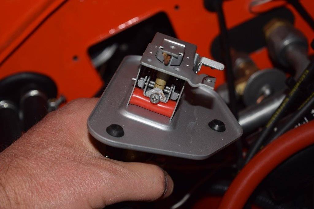

I was having cooling and heater problems. I finally pulled out the valve I had restored and found that when it is hot the spring in this goofy valve gets really weak and the water pump was pushing the value shut and the temperature control did nothing. This is clearly a mechanical engineers PhD thesis of mechanical feedback loops... Since the expansion part of the value is cut off I stuffed a piece of hose under the lever so it would actually work as a fulcrum against the spring instead of moving away from the expansion piston (that does not work). Now the lever has control over the value all the time.
I also did the final fine tuning of the driveshaft balance. I added 2 hose clamps last week and made it better. I added another after jacking it up on stands.
It runs about 3000 rpm at 75 so that is where I started. I slowly moved the third clamp around the tube in 1/2" increments and found the sweet spot. It is amazing the sensitivity of this. I had to get the clamp screw to within one half of the width of the screw bulge for the best result. Basically about 1/4" increments you can feel the difference. Took it for a short run at 80 and it seems smooth as silk (need to get on the freeway to really prove it out but it feels way better).
