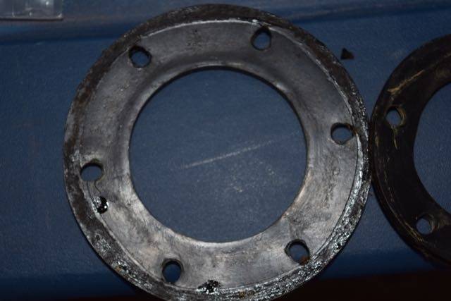

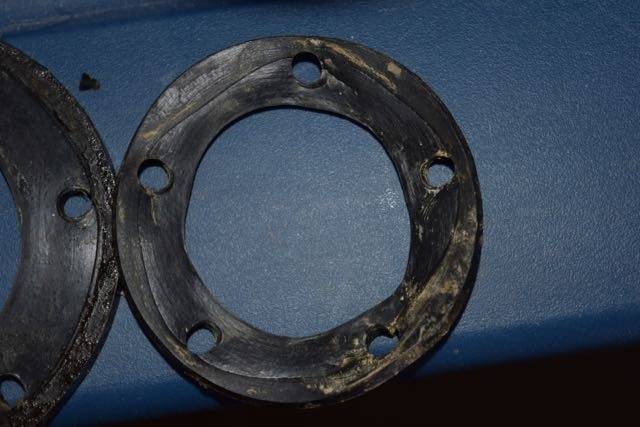

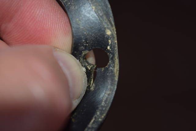

Finally dug into my fuel tank issues. Ordered a Mustang GT 5.0 pump from Summit for several reasons, one being it should be more matched for my 318 from a flow. I went with a Carter based on some opinions. Well I opened it it today and guess what. The damn thing is a Walbro rebranded and it is the higher flow rate than the one I currently have.... Well I already had the tank out so I pulled out the sending unit and pump since I had another idea about the pump noise when hot and the gaskets leaked anyway from day one with a full tank. The parts came with neoprene gaskets and the general consensus on the web is they suck with some fuel blends (California was discussed a lot). Well it think Arizona is similar. In 2 months the gaskets were already deteriorating....
They also has crushed to the point where the screws were loose too. I used Permatex Aircraft Sealer on them per the instructions which is likely why they were not leaking worse. I installed the cork/rubber gaskets from Tanks Inc and they are much better. You can torque the bolts down and they get tight and not questionable with the gasket being squishy like the neoprene ones.
View attachment 436395 View attachment 436396

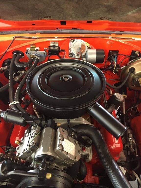

Spent the day in the heat playing with the air cleaner. I bought a '67 cleaner from a member here to modify for the FiTech throttle body. I cut out the base to 5 1/8" and add a 3/4" extension with scrap steel and a welder. The welding sucks but it won't fall off.
I had to put 2 small notches to clear the fuel fitting and I think I will leave them open like shown. The snorkel is only for a 2 barrel so this will allow a bit more air to be available.

I really want to make this work but the bevel it too tall. Need to decide if I dare try to to crush it flatter or not....
This has really stopped some of the low speed droning. It is so much more quiet under the hood now. I like it ...
Engine bay looks great, Jim...Great job on the air cleaner...what is it about a buck twenty there? 101 here today...
