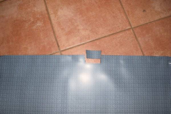

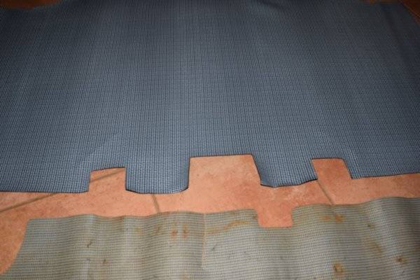

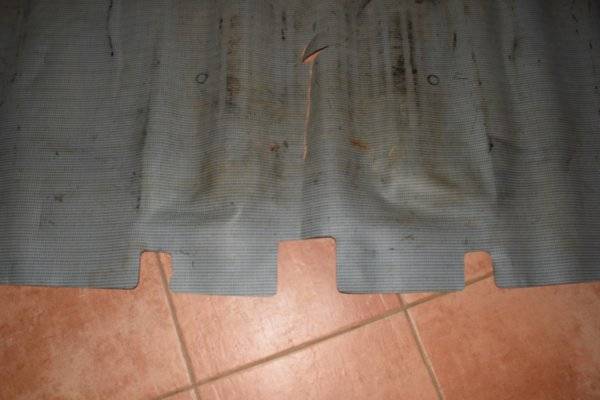

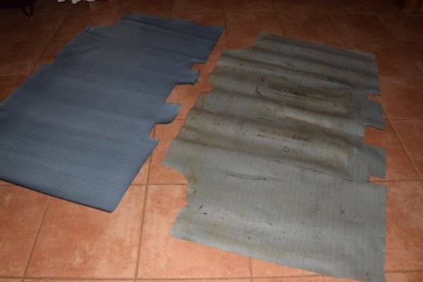

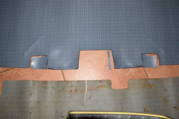

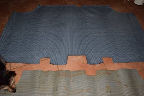

I had the bug to do something to the Coronet. I have always hated the felt table cloth trunk liner so I bought a more accurate rubber one from OER. Both of them are not quite right for a Coronet. I had to do a few custom cuts to make it fit based on the original that was in the car.

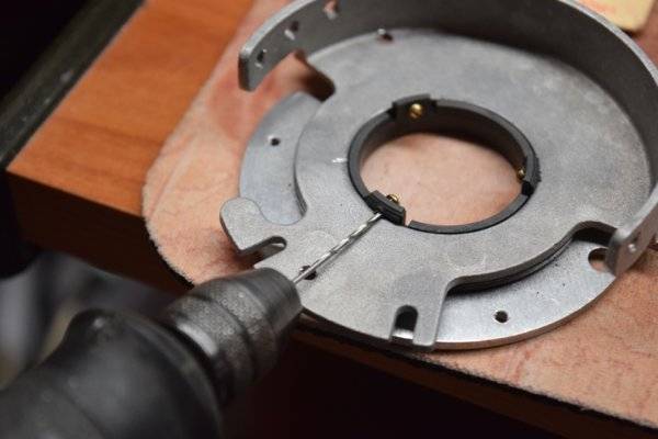

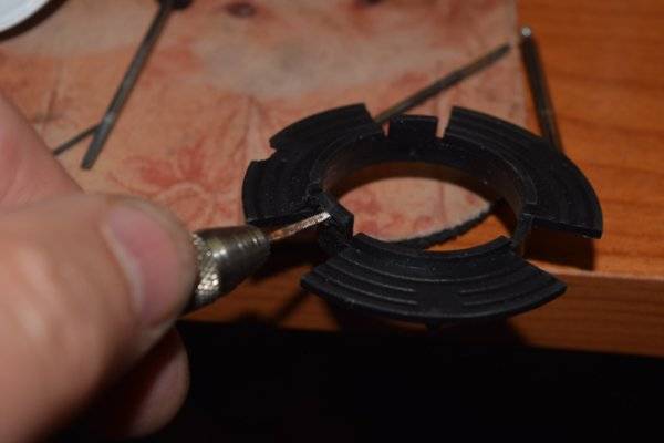

I was not going to let the Pertronix III beat me. The mechanical parts of the ignitor III are junk. The plastic and pot metal has poor tolerances and the pickup moves all over the place. The vacuum advance would use some of its throw to just rock the plate and not move it radially. They sent me a new plate for another reason and I decided I needed to make it better. I used a dremel to remove the melted plastic to remove the plastic so I could installed some 2-56 brass screws to allow me to tighten up the plate.

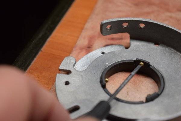

I then used a small drill for a pilot hole in each clip tab, installed, so I could tap the hole for the brass screws.

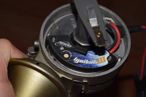

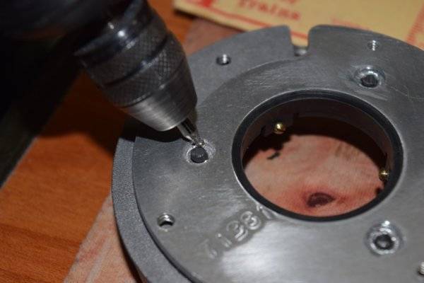

Next I tapped the holes.
I then installed the brass screws and adjusted them so the plate would slip but not rock or wobble and put some plastic compatible oil on the mating surfaces.
Now the vacuum advance movement is all translated into rotation. If the rain ever starts I will get it back together and see how she works!
Got it installed and the timing is now rock solid. Vacuum advance is about 16 degrees, much better.

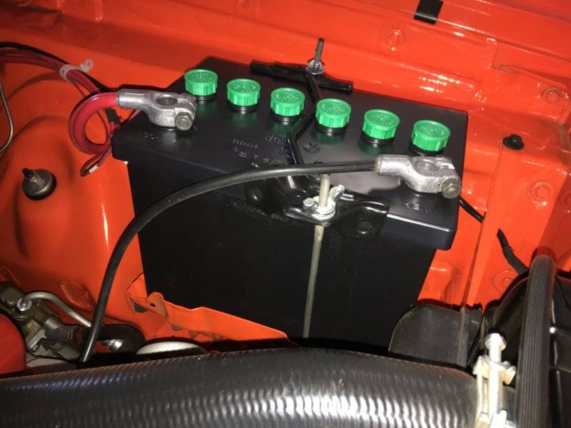

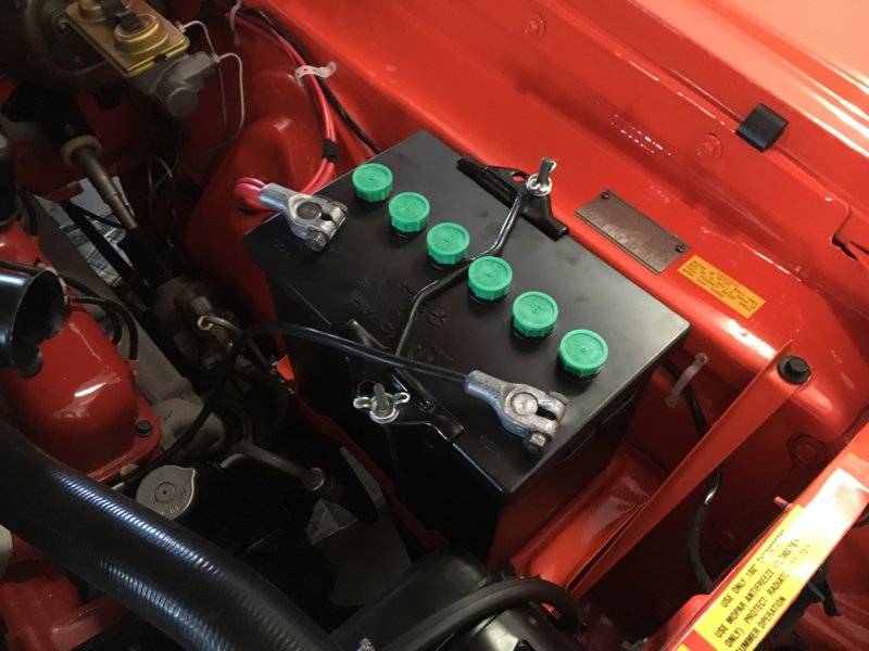

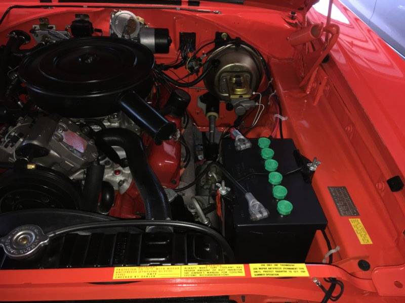

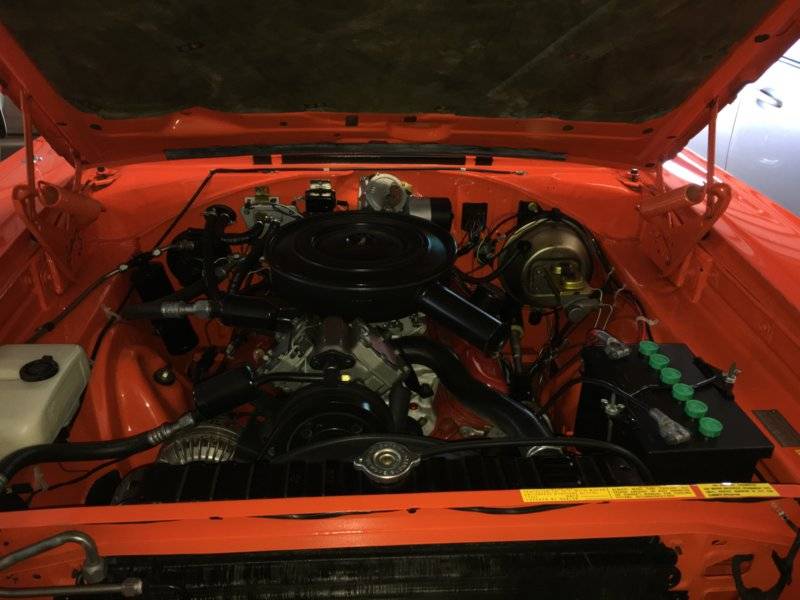

Got my Battery Topper to cover my Deka maintenance free battery with the correct green cap group 24. Way cool and really finished the engine compartment.
www.batterytoppers.com
