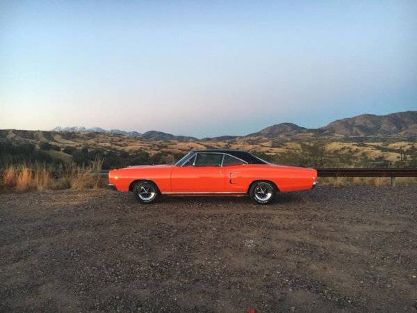

1968 Coronet 500 Project
Jim it sat for more like 15,lol. 2 jobs and then retirement hit so now have the time. Actually been on the road last summer&this year.Now getting a repaint.
Hopefully it is not in Paint Jail.... Now I see the interest in my thread :)
It’s only been a week lol. I’m original owner so I at least know what’s been changed/modified. Jeff

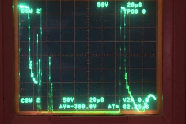

Getting my blanking on.... Bit more testing and I’ll throw in the Pertronix III and blank out the double pulse! It needs a bit longer blanking at low RPM too there are a few jitter there that I think it catching a trigger on the back edge of the firing pulse now and again.

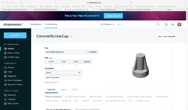

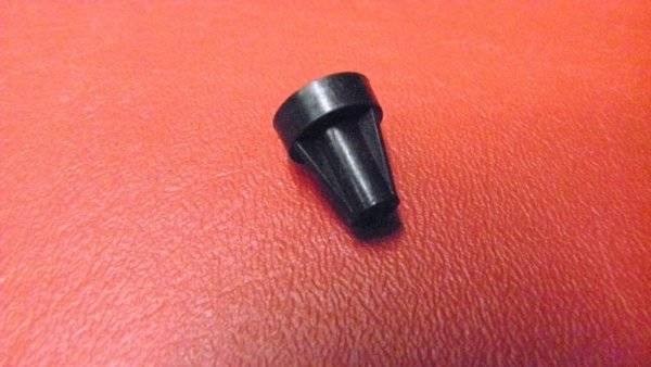

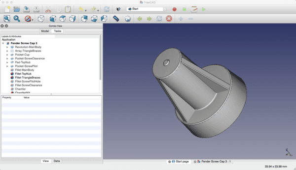

Experiment time. I have not been able to find the caps that go on the screws for the fender headlight splash shields. A Coronet Facebook group guy sent me one original so I made a model (first time) and have 4 coming from Shapeways (3D printed) in 2 different materials. We will see how they come out!

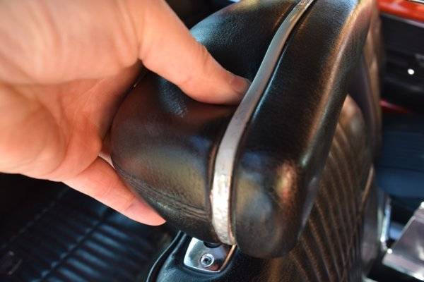

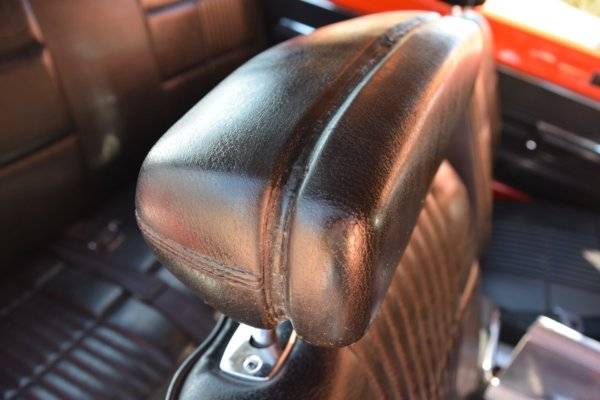

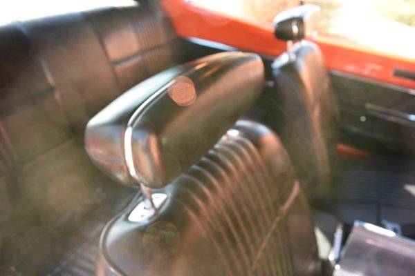

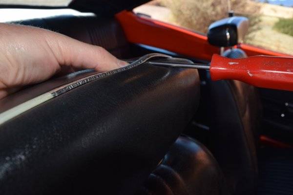

Finally installed the new Legendary Interiors headrest chrome. Best to leave it in the sun to get the vinyl soft then press down. You will be able to find a few spots that the glue is not very strong. Slide a screwdriver through then work your way along pressing the vinyl away from the screw drivers vs pulling the chrome off. Wipe down with Acetone and stick the new ones on. They have double back tape.... not real sticky... may need to glue them with better glue on the ends.

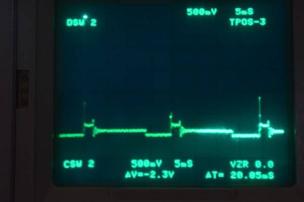

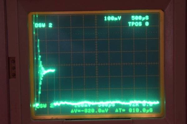

Lets see how the Pertronix III works. Its dwell is about 6ms at idle.
What is interesting how they handle when it is reved up..... They actually turn the switch on BEFORE the flame is extinguished in the cylinder! This will maximize the current for the next ignition cycle.... interesting.... I would not have tried to do that....

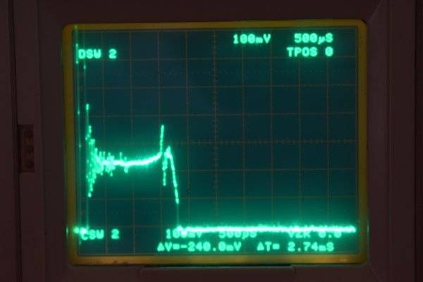

Next I wanted to see the difference between the system with and without the factory inline ballast resistor.
The first one is with the resistor out of the circuit so if you do the math the circuit is trying for 12A peak and the resulting double firing. I am going to guess the integrated circuit that they use limits the current to about 6A-7A based on the devices I have looked at.

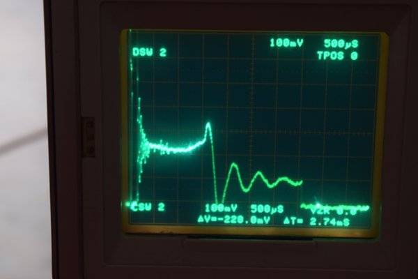

I then put the resistor back in and the math says it should max out around 5A-6A so there is not that much lost from the resistor out. You can see the area under the curve of the first firing line is a little lower than the first so about 2/3 the joules to fire the A/F mixture. Still WAY more than the points gave.
The resistor will drastically reduce the stress on the Penrtonix switch and the factory coil. I am going for reliability and not blazing performance. I don't see the difference in performance so the resistor is staying in for now.
