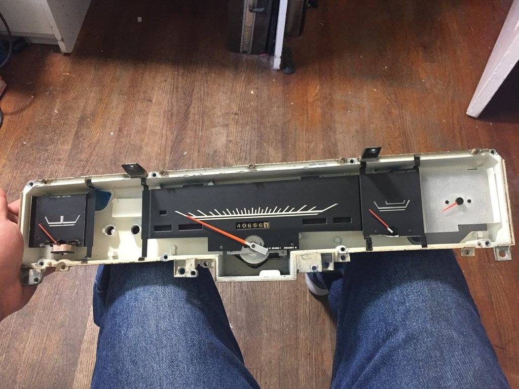

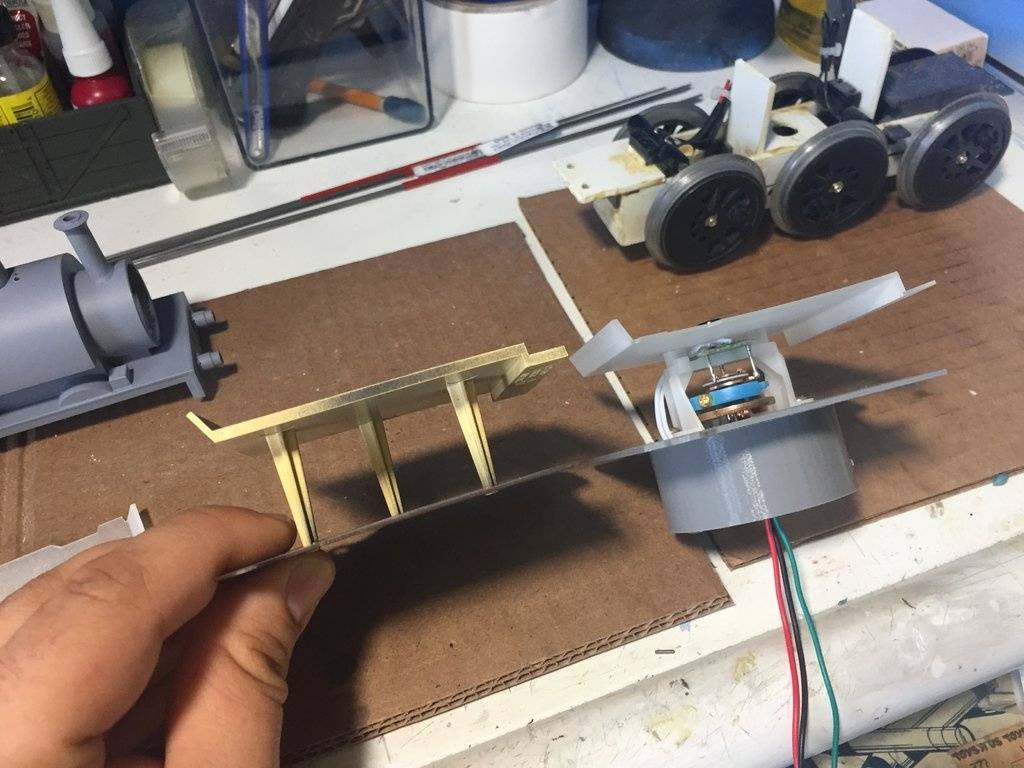

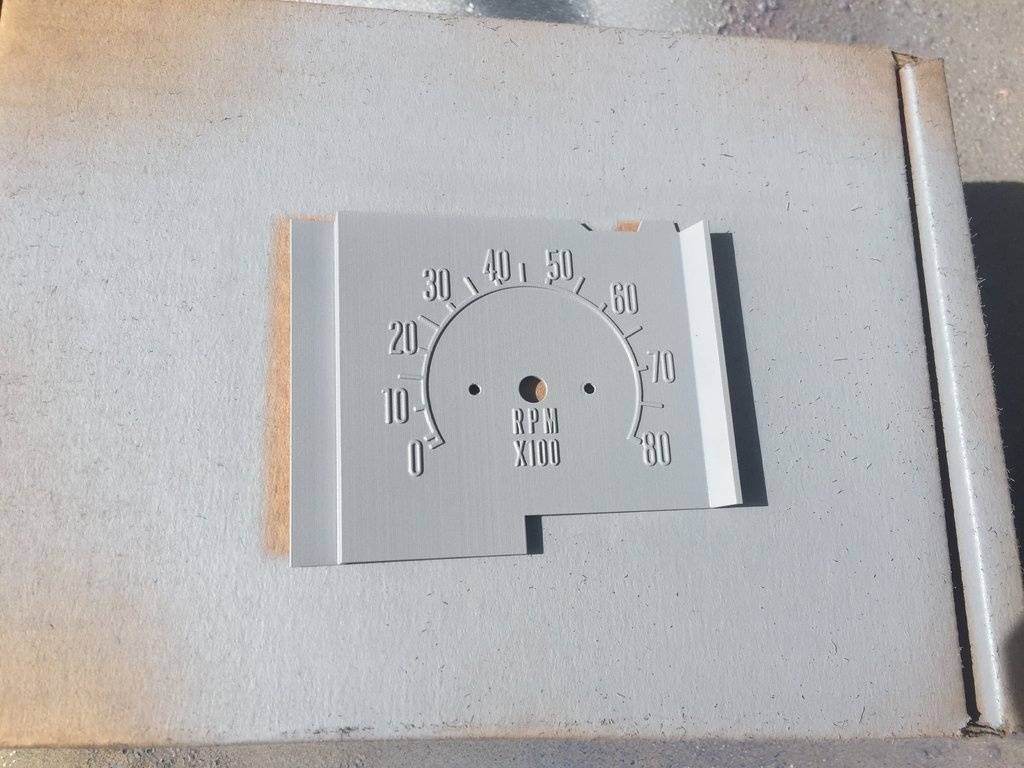

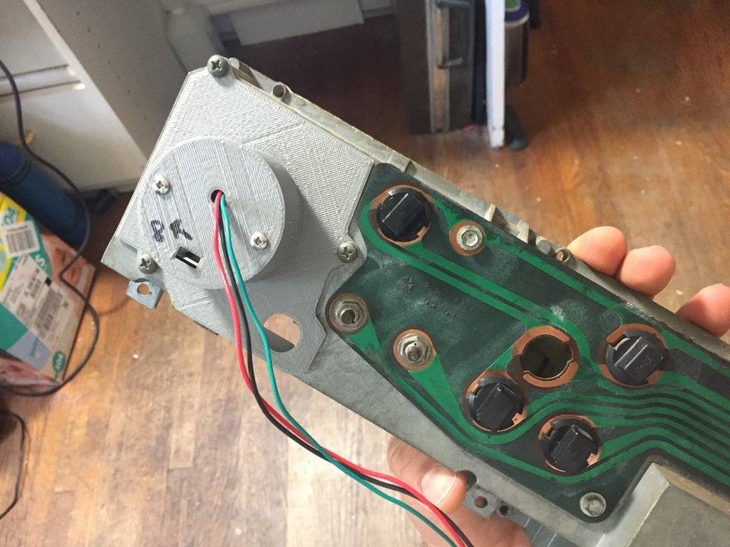

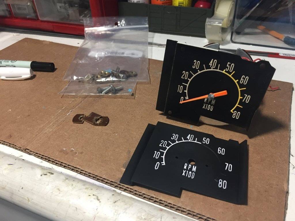

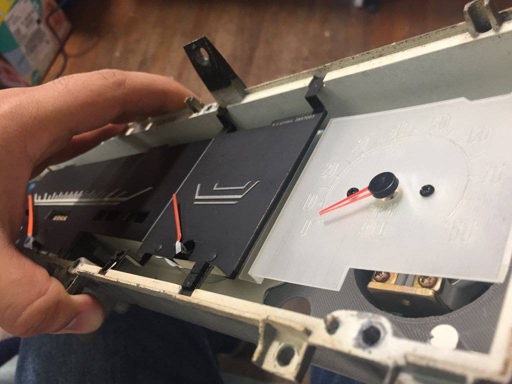

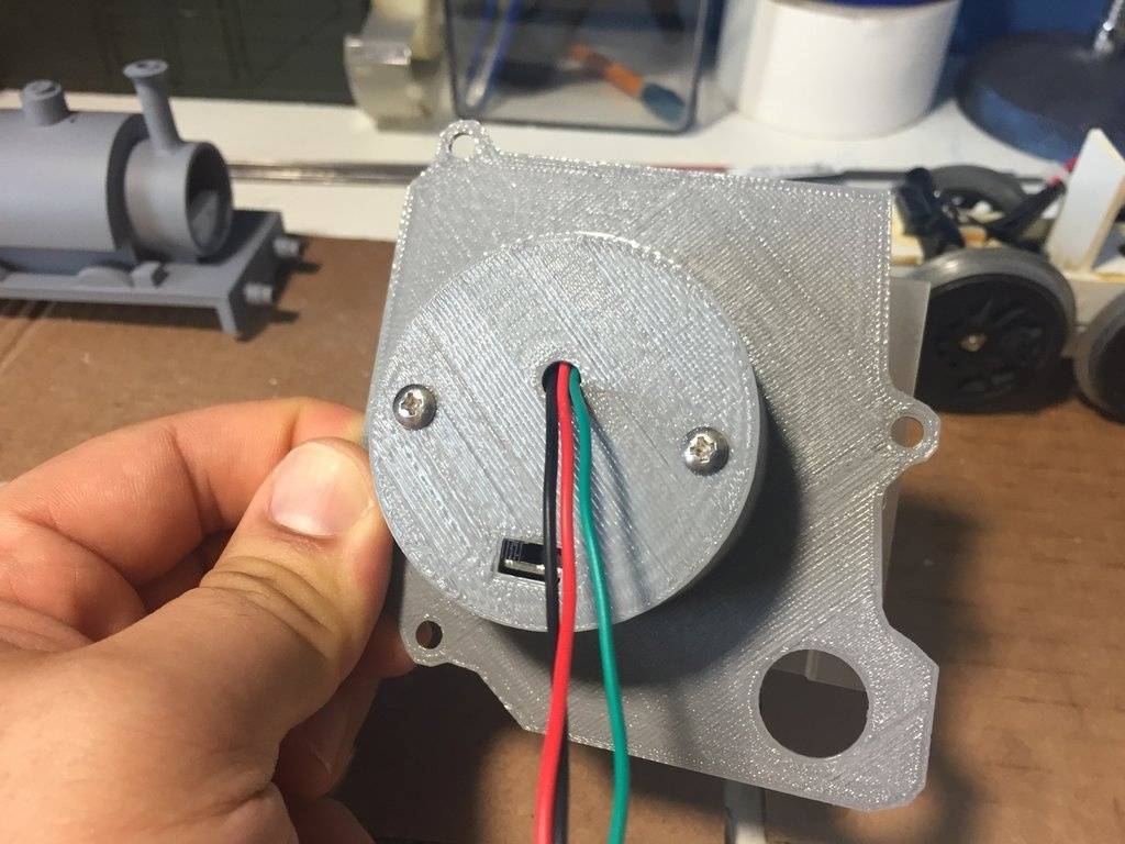

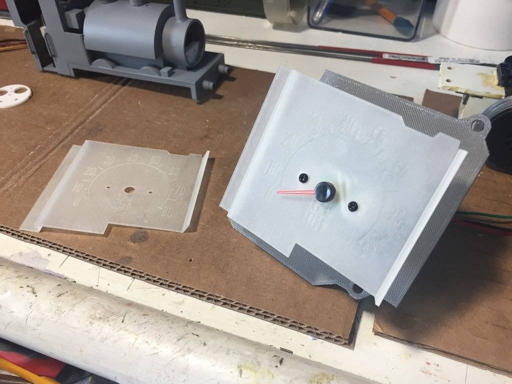

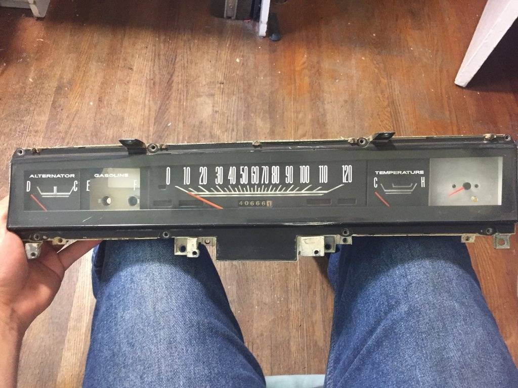

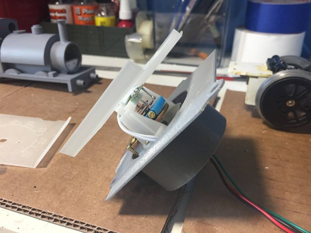

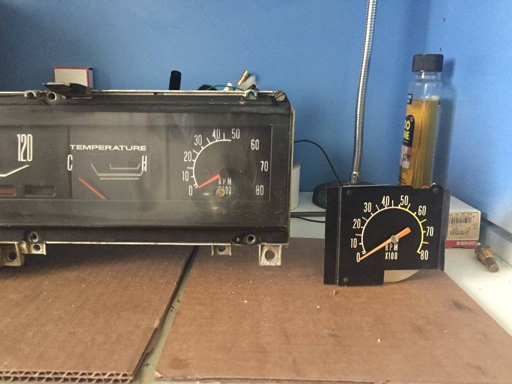

It so happens that my 3D printing service had to issue me a credit for a failed printing (something completely unrelated) and they were also offering a 5% off coupon, so I wound up ordering a test set from them (no offense, Dan - the excitement was too much) and ordered a spare detail plastic facing to send to Dan.
That said, the PLA-printed backing mount lets the tach sit 3-4 millimeters too deep in its housing, but - otherwise - the result is phenomenal! I even received the instrument cluster that I bought on eBay with a factory-original tachometer just a few minutes after assembling the 3D printed unit, so I put them side by side for a comparison.
I'll let the photos tell the story:
-Kurt
Great work Kurt! Everything looks great... but that needle. Not sure I can get over the needle.
Neither can I - which is why I hope the whole dash cluster sells for at least $100. Gives me something to buy the RTE parts with.
Pretty sure a Sunpro oil gauge would have a more palatable needle...

Apparently, the old board is fried, and I'll probably have to make a new stud isolator too, as the original fiber isolator cracked - apparently, the back end of the tach was dented in shipping. Already fixed the shell damage in the hydraulic press though, and just have to 3D print a better (and more reliable) PLA isolator.
