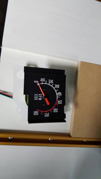

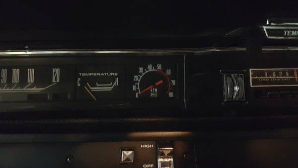

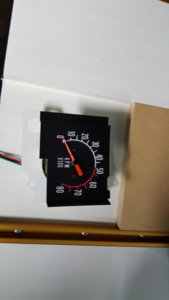

Here it is painted and mounted ... I'll get around to installing it this week sometime ..

Now as much as I'd like to have an original, I really don't want another thing on this car with intermittent quirks - and since I went through all the trouble of designing 3D printed replica ages ago (and since the little Chinesium $12 tach worked perfectly), I'm going to get one more printed for myself - though I'm going to update the plate by deleting the mounting screw holes. I'm going to add a centering stud to the back instead so it can be glued to the cheapo tach. I'll also offer this as a variation on Shapeways for those who like the idea of this.

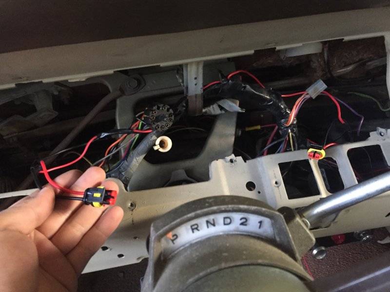

In other news - I added a pair of quick-disconnect weatherpack connectors for the voltmeter (I converted it - no high amps going through here) and the tach, when complete. I don't know why on earth I didn't think of this in the first place, since disconnecting the voltmeter is such a major pain in the butt every time the instrument cluster is pulled. This should make installation a breeze!
