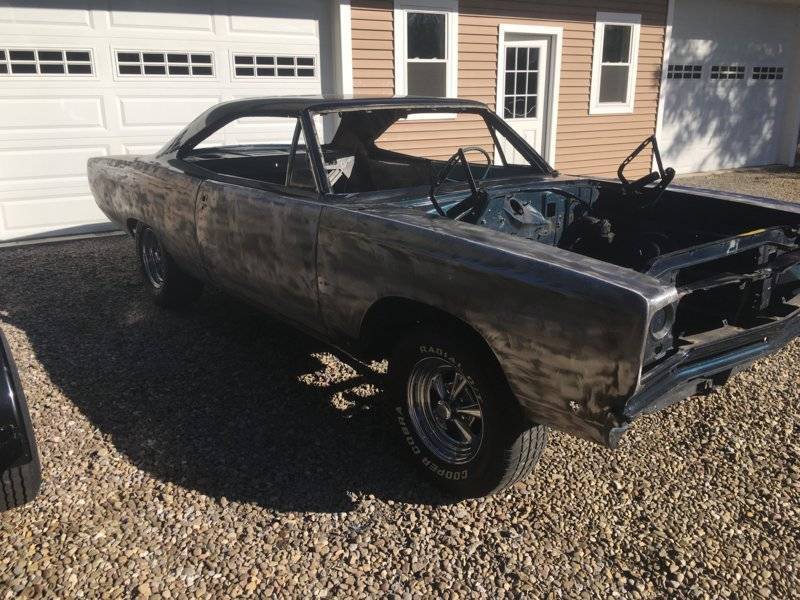

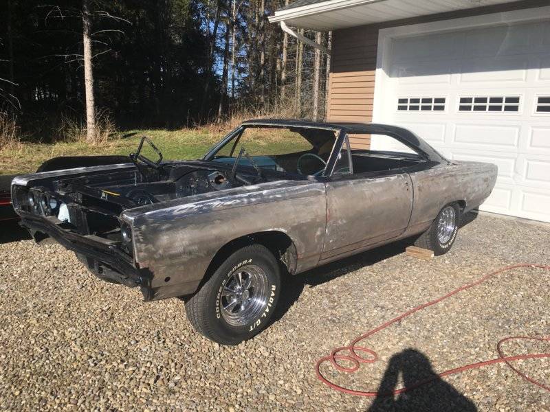

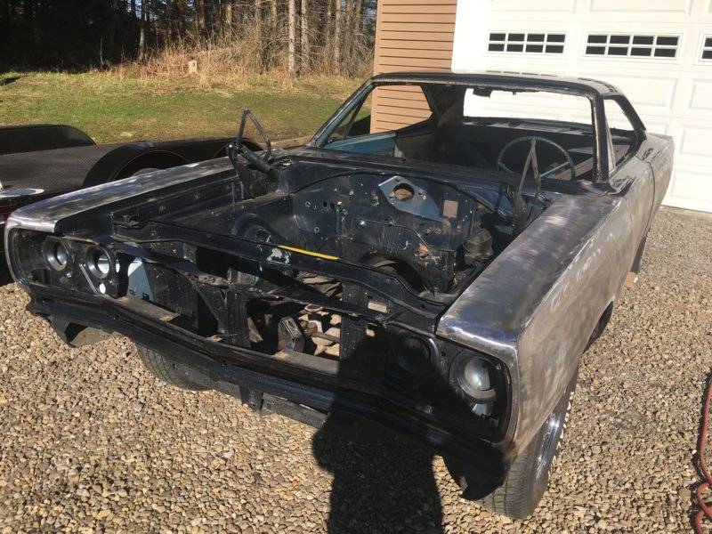

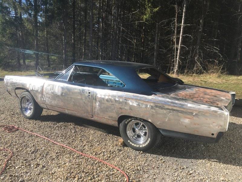

So after ripping a toilet out and resealing it today I got a little time to push the car outside and do some more stripping. Everything is basically stripped on the exterior other than the roof and the tops of the doors. I’m waiting to do the doors once I get the vent windows and frames out so I don’t hit them by mistake.
View attachment 939256 View attachment 939257 View attachment 939258 View attachment 939259
Body looks very good....you are ahead by far if you have very little rust to repair........MO

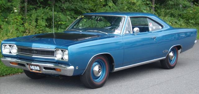

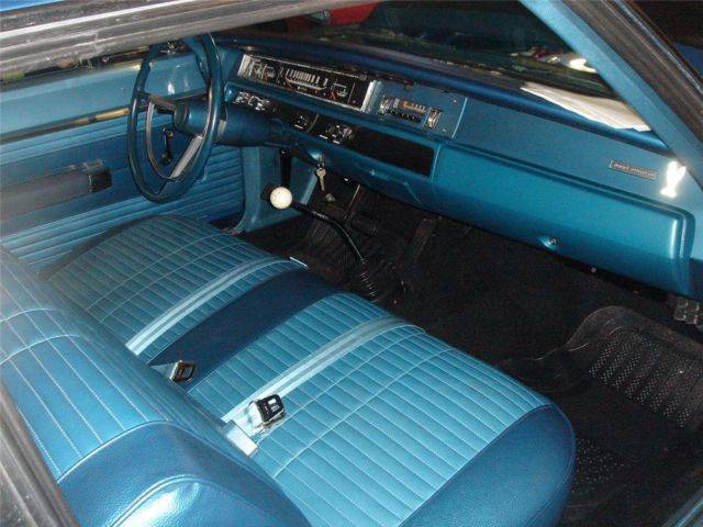

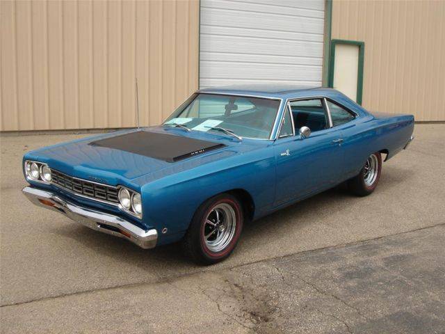

Thinking because I have no numbers matching and its just a driver I am going to do a color change. I am going to go with QQ1 on the exterior and keep the blue interior. I like the color way more than the original EE1, which can look almost purple when sprayed wrong or mixed wrong. It'll be like below but with dog dishes. Same as the GTX, minus the GTX badging and trim obviously. What do you all think? I think the interior and exterior colors go awesome together and pop more than the EE1 too! Love that 68 QQ1 color!

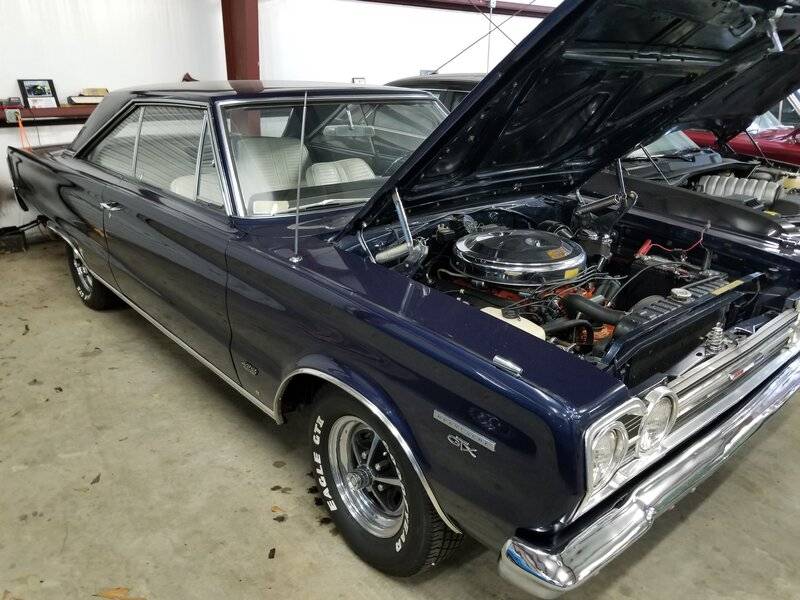

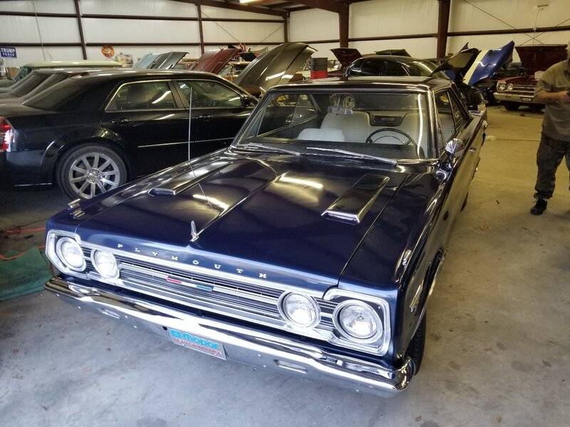

Is the EE1 blue in 68 different than the same color in 67. Your car in the picture doesn't look as dark as my 67 EE1 car

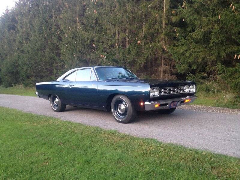

Originally the color is this on the car. They modified it a touch with more metallic but that was back 1986'ish when it was painted. I am thinking of going with the QQ1 in the above pics. Here is the original car before I stripped it. I have seen several different shades of it too depending which plant and year. It's like any color in the 60's from different plants....seems so many shades depending on day time and such haha.
My personal opinion only, but I don't like how EE1 has almost a purple flip to it at times because of the hue and darkness of it. Most I have seen flips to blueish purple when its in different lighting, and I wanna avoid that. Mine did not but it was altered a touch to avoid that. Just after starring at it for 15 years, I am thinking now is the time to change the color if ever. I have always loved QQ1 and am leaning that way.
Both are beautiful colors. I'm not trying to imply that you change your mind. I was just noticing the difference in your car now as compared to mine.
Oh no worries man I get what you were looking to point out. I am just thinking aloud and know you have the eye for that color as you had one yourself. I keep leaning towards that QQ1 man....It's always been a favorite of mine.
With the light shining on the front of mine to me it looks more like your car now.
I ordered a new Roadrunner in 1968 with the QQ1 electric blue paint. I am doing a tribute car to it , just got it pained a little over a week ago. Same color. I found that color was a one year only color ( for whatever reason) and it is hard to come up with the correct formula. I was told it was because paint is mixed with different materials than it was then. Don't try to color match with a faded paint chip chart that is 50+ years old.......................Good luck.............MO

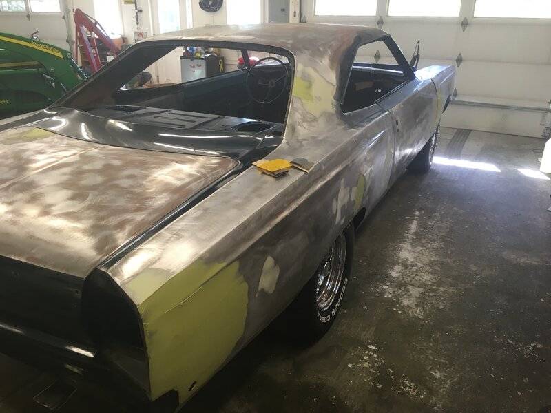

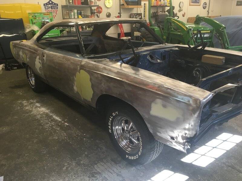

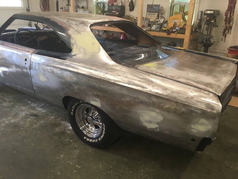

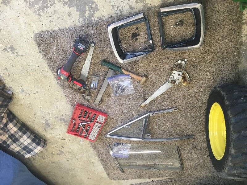

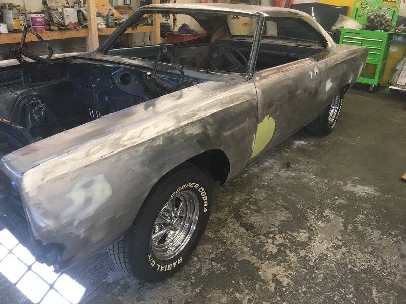

Got some more mud work done today and removed door glass and tail pieces. Close to primer for sure!
