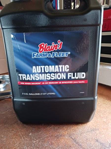

I just picked some up. Regular $65 ea! 40 ea on my account.
They're not even 5 full litres!!! (rip off)View attachment 1679656
