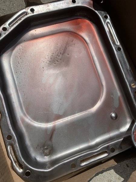

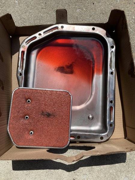

It looks good. I also see that the pan bolts were not overtightened, a good thing. Yes, the starter must be removed to take the cover off. I've known of people who cut the cover so that it can be removed without disturbing the starter.Here is what the filter and pan looked like. I dont see nothing too alarming. The mark on the filter is where I held it up to get the screws out. Replace it with a Wix filter.

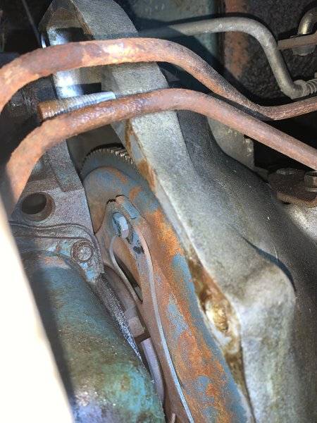

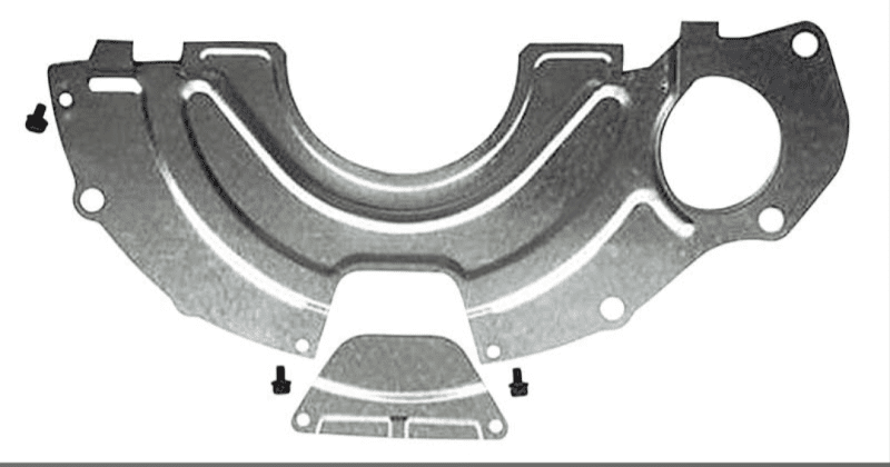

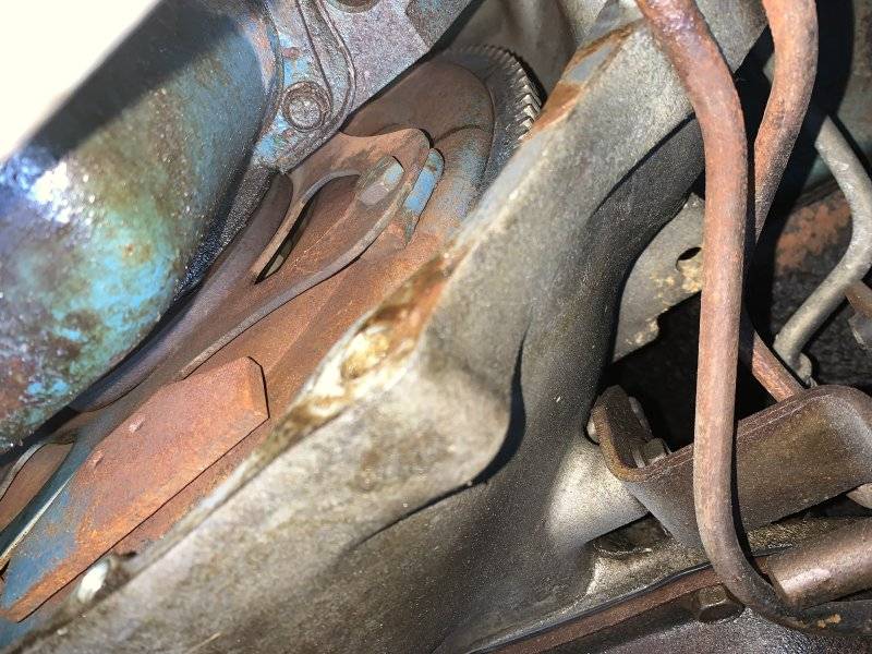

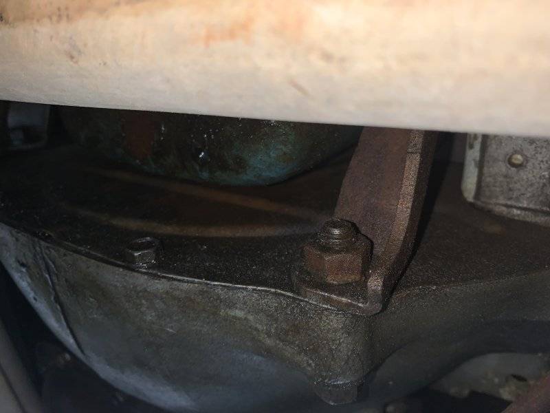

See below. The large part is the "dust cover" and the small "trapezoidal-shaped" part is the "inspection plate".I dont know if it is an "inspection" cover but there is a cover that is on the bottom of the trans bellhousing. It is not easy as I have to remove the starter to get it off. There are 6 bolts

The bump and the divit are magnetic.While you have the pan off, drop a couple of short round magnets in there. They will attract any little pieces of metallic contaminent.
Mine does not have an inspection cover. It is all one piece.See below. The large part is the "dust cover" and the small "trapezoidal-shaped" part is the "inspection plate".
Not all, but a lot of, late 70's Torqueflites (904 and 727) had lockup torque converters and they do not have a drain plug. These cars have a one piece cover and no "inspection plate" because the torque converter cannot be drained. The other Torqueflites from the late 1970's probably have the same one piece one-piece cover; and most likely do not have a drain plug in the converter. I have seen non-lockup converters without a drain plug, BUT they have a dimple where one could be drilled and tapped if you're an adventurous person...drill and tap without introducing debris/burrs into the torque converter.
My manual calls for 10ft-lbs. thats what I torque then toIt looks good. I also see that the pan bolts were not overtightened, a good thing. Yes, the starter must be removed to take the cover off. I've known of people who cut the cover so that it can be removed without disturbing the starter.

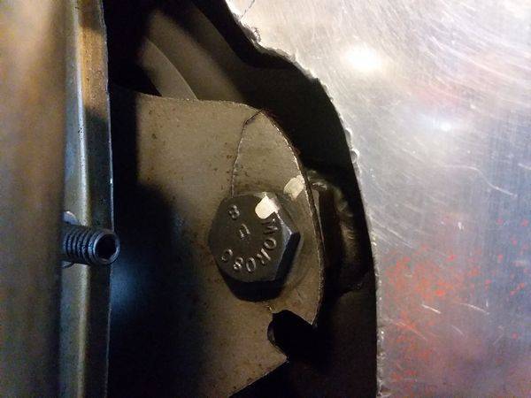

This looks like a cheesy flexplate compared to mine. Mine looks thicker.
