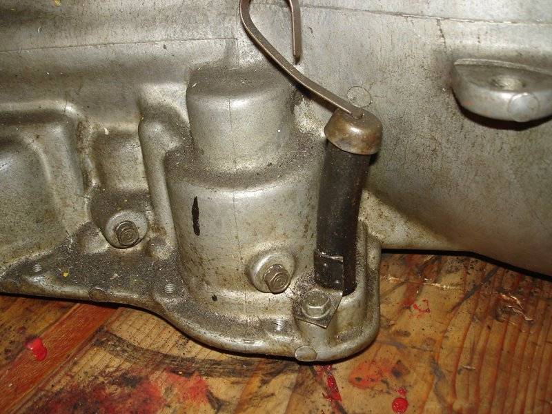

And, just for shits and giggles, a picture of a tube and stick that I made and used in 1966.
