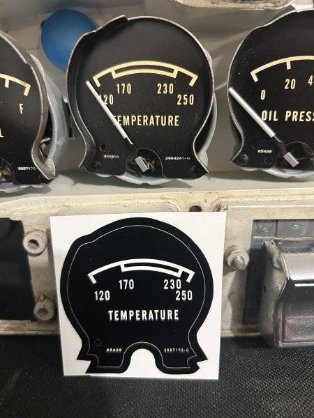

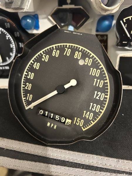

As usual, being winter time, it’s time for more Bee work. Motor is out looking for an oil leak and I’m tired of looking at the dingy dash gauges so hopefully will get these Premium Dash Decals on finally. Comparing the decals, the Bee dash sure needs refreshing. And interesting that the temp decal differs from the factory, but I thought I remember reading somewhere that the original temp gauge was recalled for a more correct reading one. But definitely following Wayne’s tutorial for the dash.

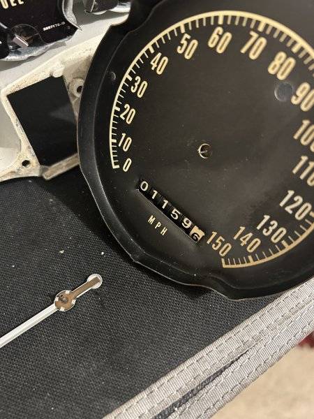

Following Wayne’s restoration thread, holding metal wheel firmly in place and twisting Speedo needle below zero, needle is safely off

Ready for painting with Krylon flat black per Premier’s instructions. Using a stick pin, poked a hole in painters tape then a hole punch for the mask over where the needle goes.

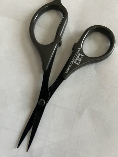

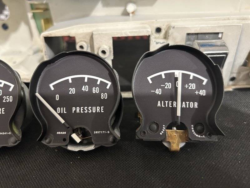

After and before pics. The Premium Dash Decals are very nice. And my plastic model building skills came in handy while putting the new overlays on, especially with the special purpose Tamiya decal scissors. Very sharp with precision cuts.
Also put in a new circuit board, just because
Gauge panel back together. Dadsbee’s restoration thread was invaluable when doing this. Only wish I would have paid more attention to those little plastic rings that hold the gauge faceplate in place. Some of them shot off and are now in carpet neverland.
