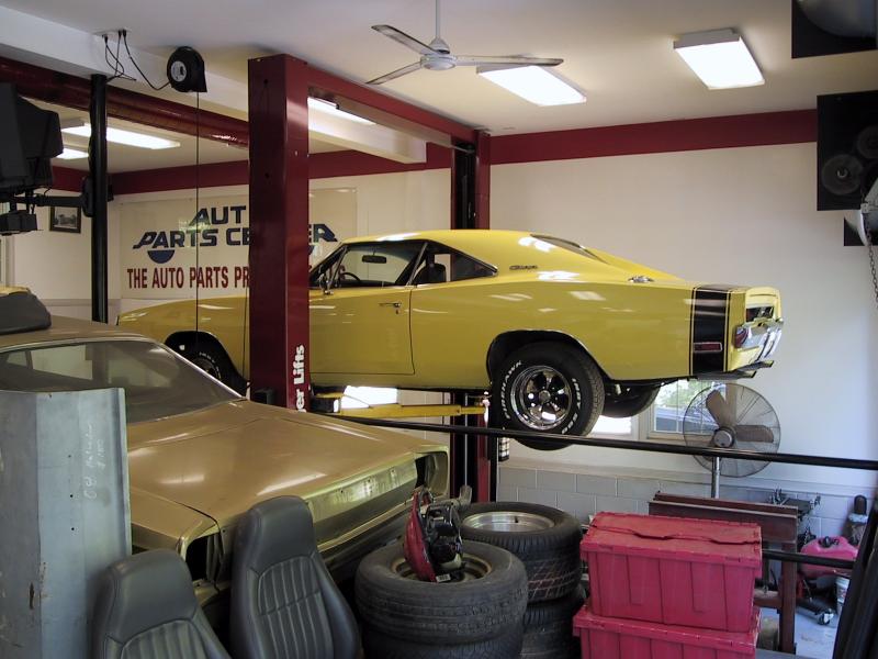

Hey H2E, Here are some Keystone's on a 70 Charger in my shop. Worked on it for a friend a while back. I really like the look!!

I really like the look of that car Chicken. I even saved the picture of it on the hoist from when you originally posted it a couple of years ago.

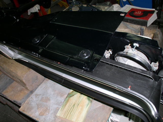

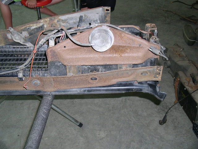

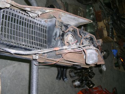

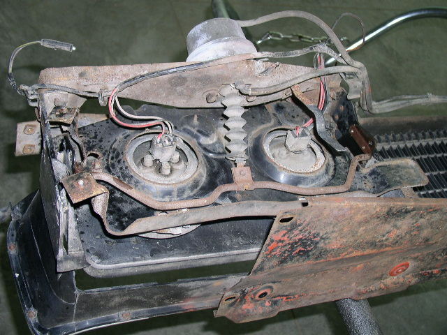

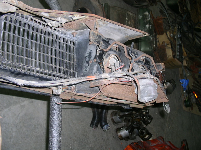

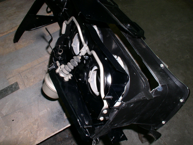

I got about a hour total this past week to spend with the Charger - just enough time to get the grill together and put on a shelf out of the way. Here are a couple of before pics of the back. I used this plastic dip made for tool handles on the pieces that needed a coating.
[/ATTACH=CONFIG]139741[/ATTACH]P7140111.JPGP7140112.JPGP9080062.JPG

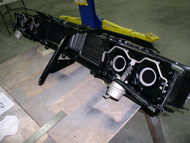

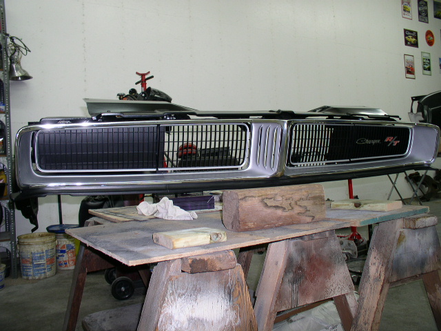

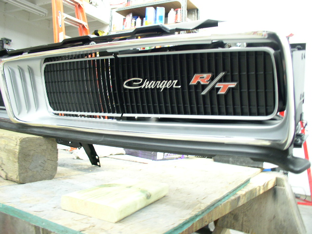

And some of the finished project. All done except I am waiting for a new R/T emblem that is backordered.
Do any of you other Charger guys have some sort of clips on the headlight door pivot pins? My service manual says there are some, but mine were MIA. I'm not sure a guy even needs them as the doors fit fairly snug. They must be just a round push on retainer. The pins measure about .185".
P9080063 (2).JPGP9080064.JPGP9080065.JPGP9080066.JPGP9080068.JPGP9080071.JPG
One other thing I forgot to mention is that the grill trim retainer kit I bought was short 4 of the special red studs. Luckily I had enough original spares to get by. So if anyone needs the same kit, make sure there are 20 of them included when ordering.

Damn your grille came out great! And you're correct the headlights door pivot pins should have the round push-on retainers (like the one securing the pin in the parking brake). Finally making some more progress on my grille now that I got the engine in, hopefully it'll be on par with yours! Outstanding work!
Hey Speedy - Do they just get the push on retainer, or does a small flat washer go on first?

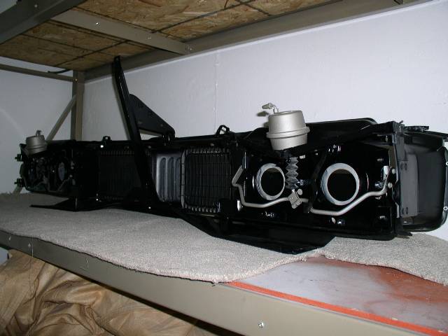

Wow the grill and heater core look like works of art h2e!
I think the grill turned out ok, but the heater box will be a winter project for me. I'm so busy with the day job that I won't be able to get out in the garage very much in the near future. I guess that isn't all bad though - gotta make the cash to keep throwing into this money pit.
LOL I'm a dumb@ss .. didn't look closely enough at this photo and thought it was the done heater core up on the shelf and you were going to post your pics of the refurb later
