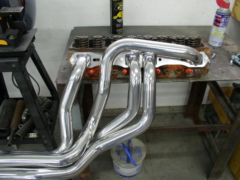

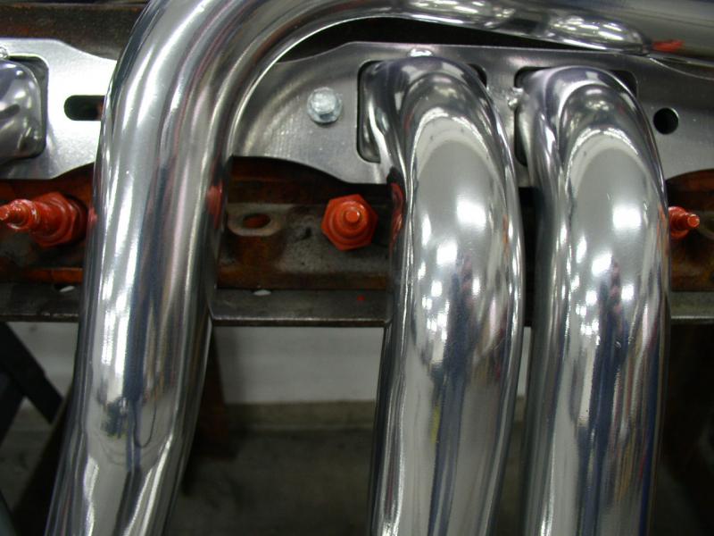

Cool to see the progress elk, that butyl is nasty $h!t for sure but laquer thinner destroys all haha. Those headers and the rest of your exhaust look gorgeous!!

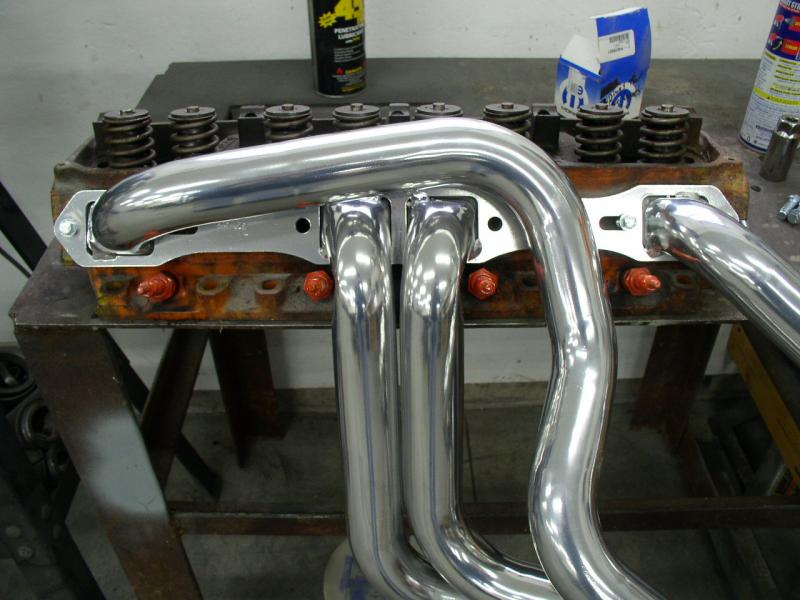

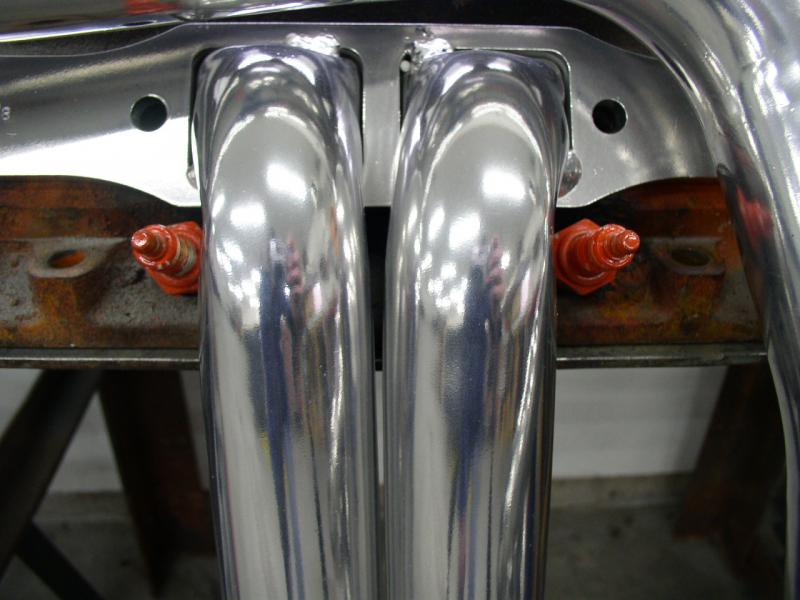

Take a minute to bolt those got headers to your heads and make sure you can get a spark plug and socket on all 8 cylinders. I have had two sets that had a problem at # 5.
Those headers do look great. I take it they are coated so hopefully the heat won't be too bad for a couple of the plugs.

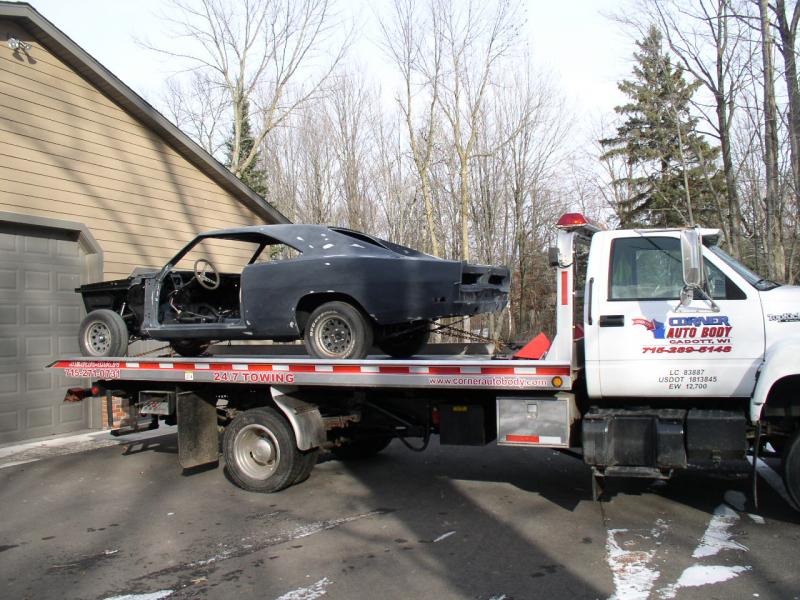

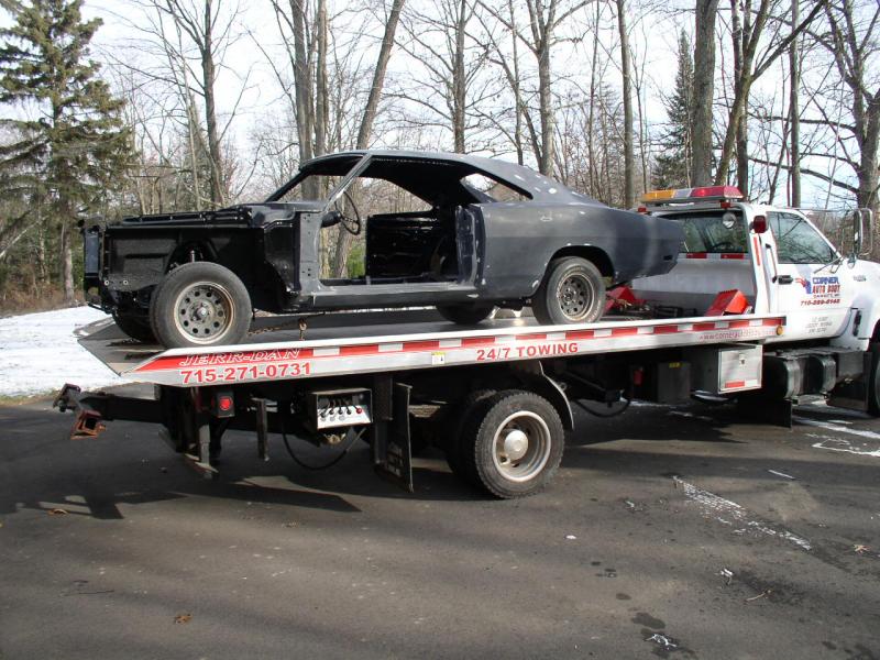

Great day in Wisconsin - the car was just picked up and will be painted Friday.
