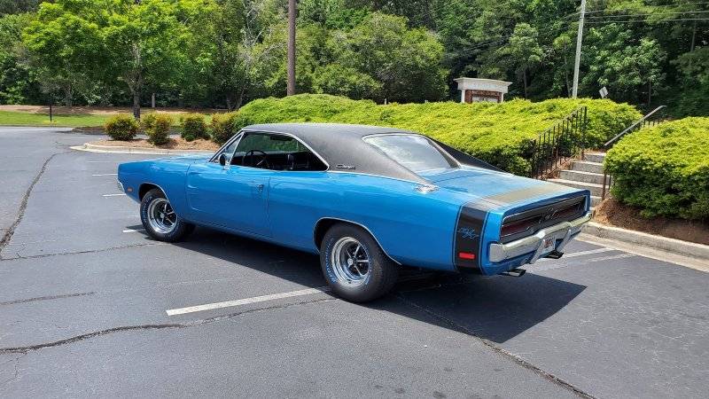

This was my first real test drive. It drove nice, but drove much better after an alignment. This was before the first wash or dry clean.
This past weekend we even attended our first car show after a quick dry clean. Still a little adjusting and fine tuning to do. The brakes also leak due to a short brake line flange in the master cylinder. Once those are taken car of all that will be left is a final wet sand, buff, and polish.
