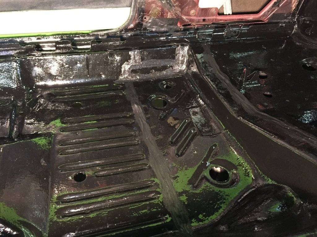

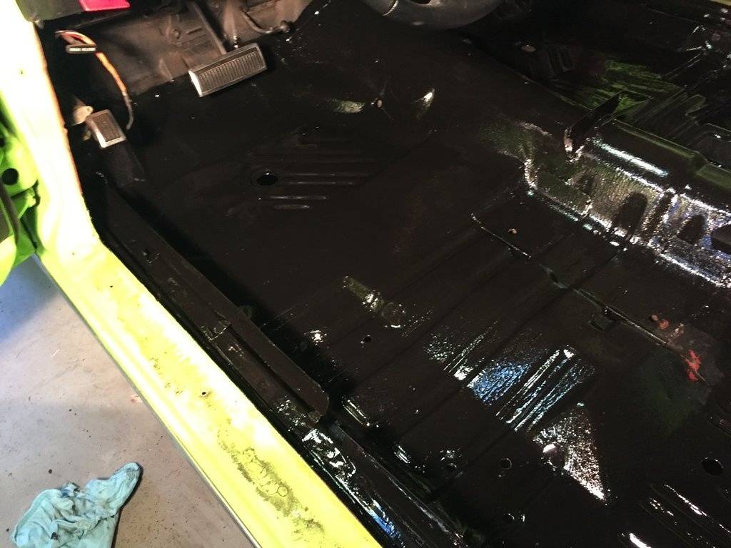

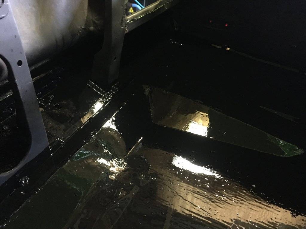

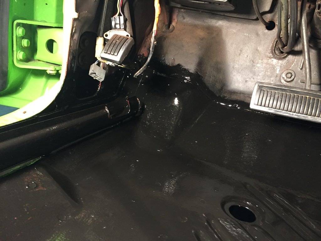

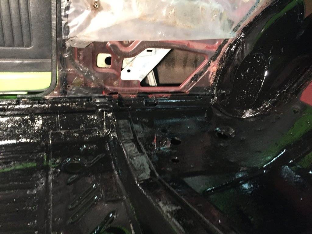

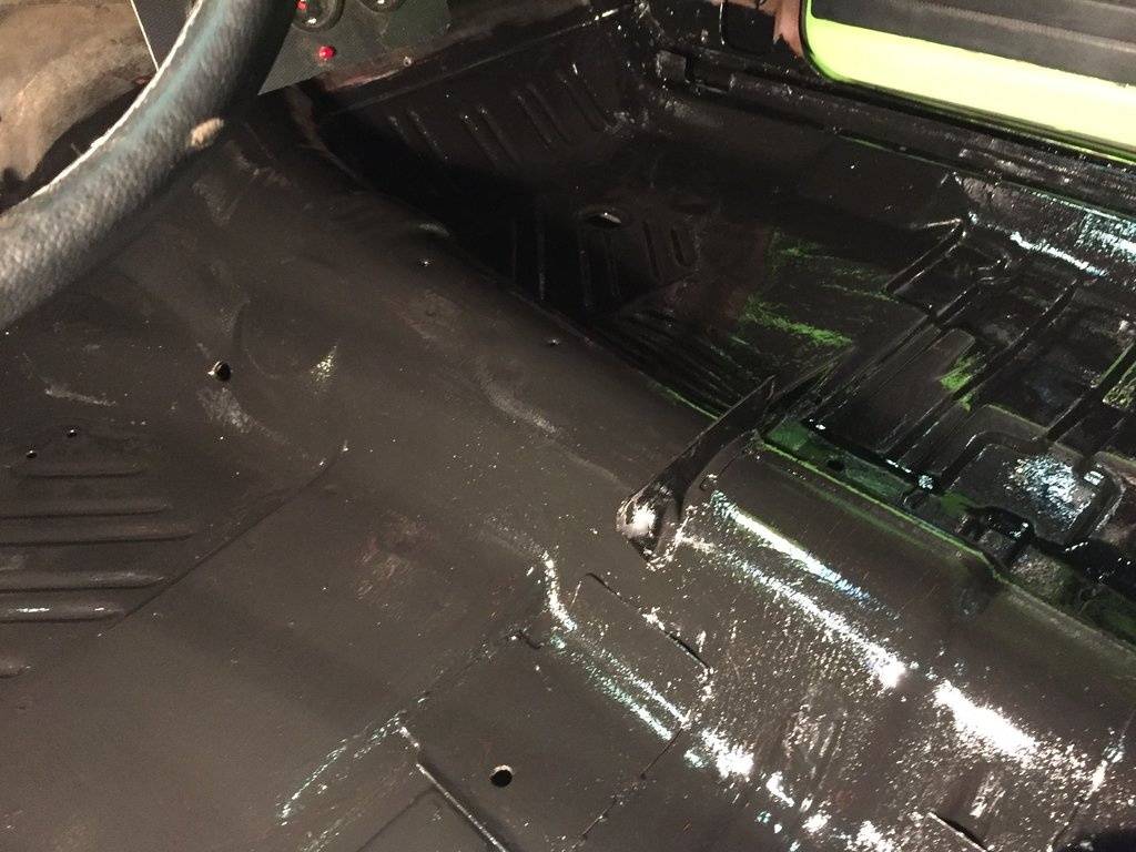

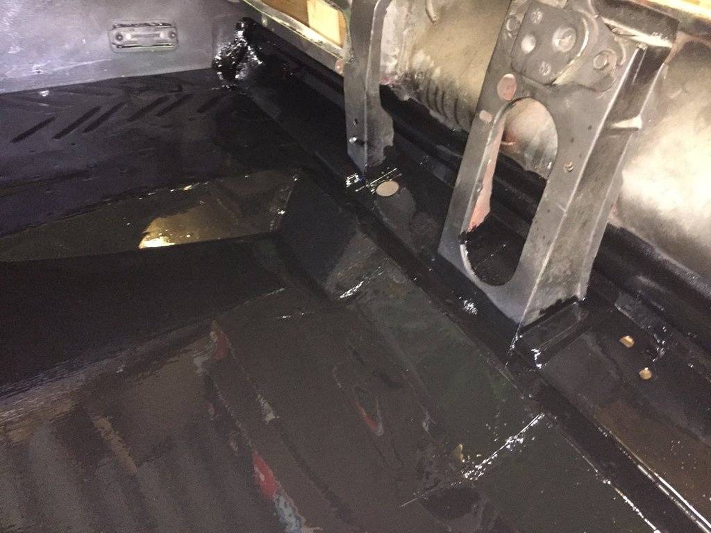

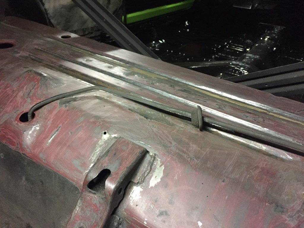

First coat of POR 15 is in place.
I let it dry for a few more hours and apply a second coat.

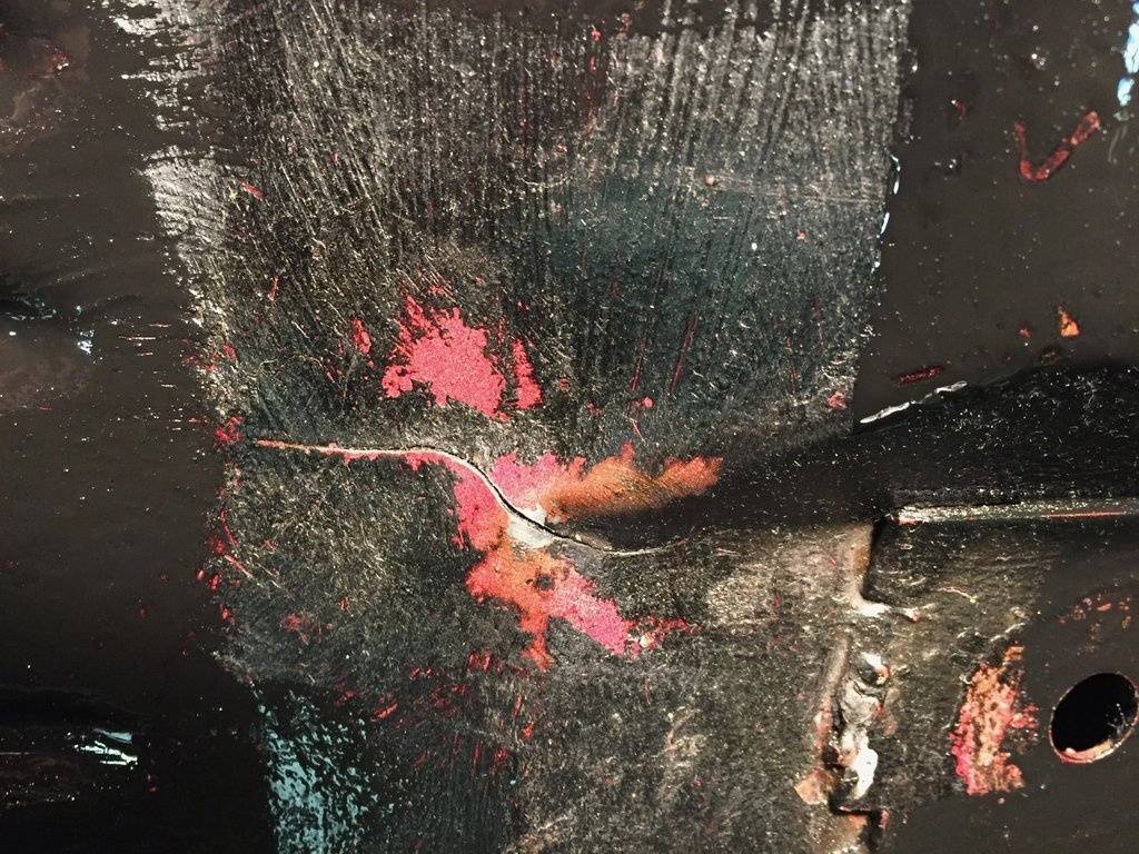

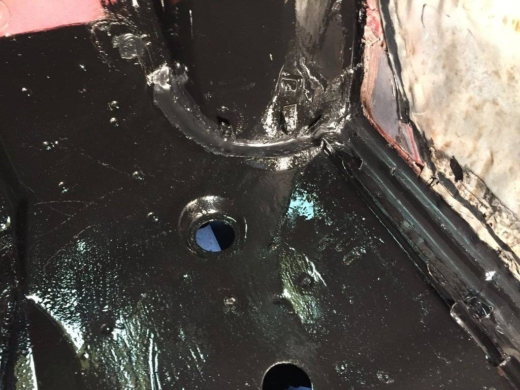

Unfortunately last moment i found a crack in the bottom :(
Guess this is due to the tranny mount that has been pulling and twisting here.
Tomorrow when the paint is dry is will have to drill the ends, grind it out and weld it.

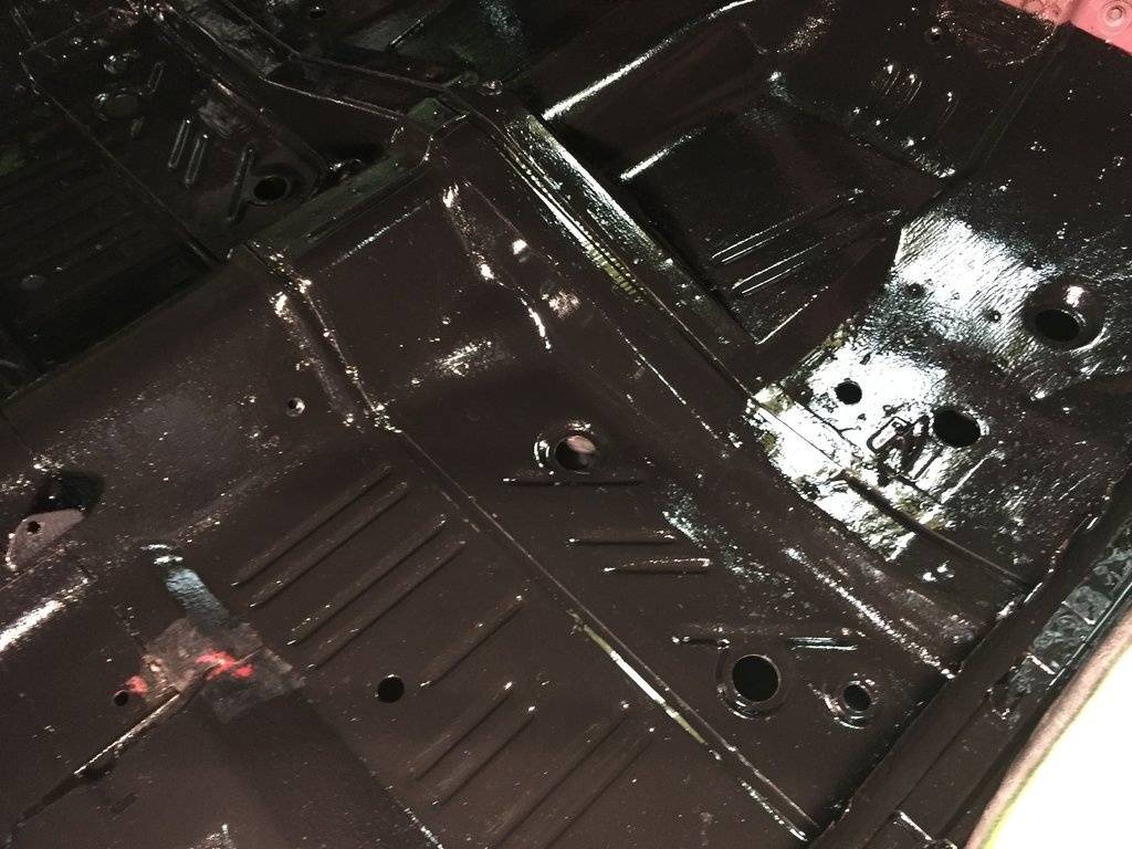

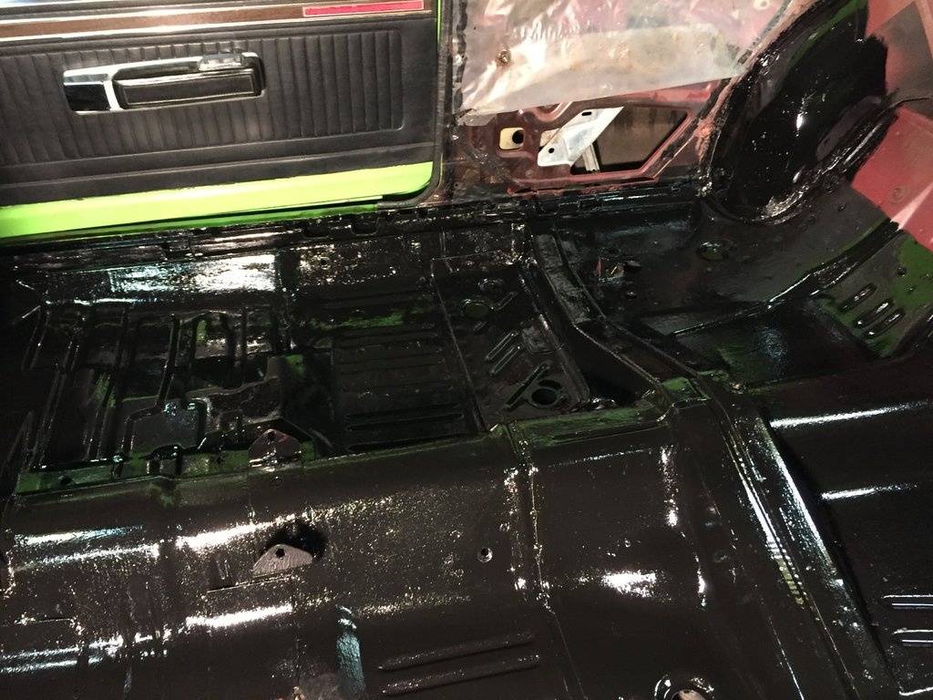

And i've got the second coat of POR 15 in, that stuff dries faster then i was expecting.
I checked the section where i started expecting it still to be wet as it is so shiny, but instead is was already "tacky" so had bottoms up my fresh cup of coffee and get started.
Tomorrow's plan is to weld the crack, get the seams filled with sealant and once dry get the top coat of POR 15 in.

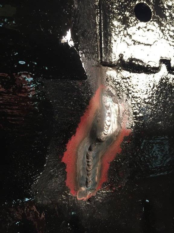

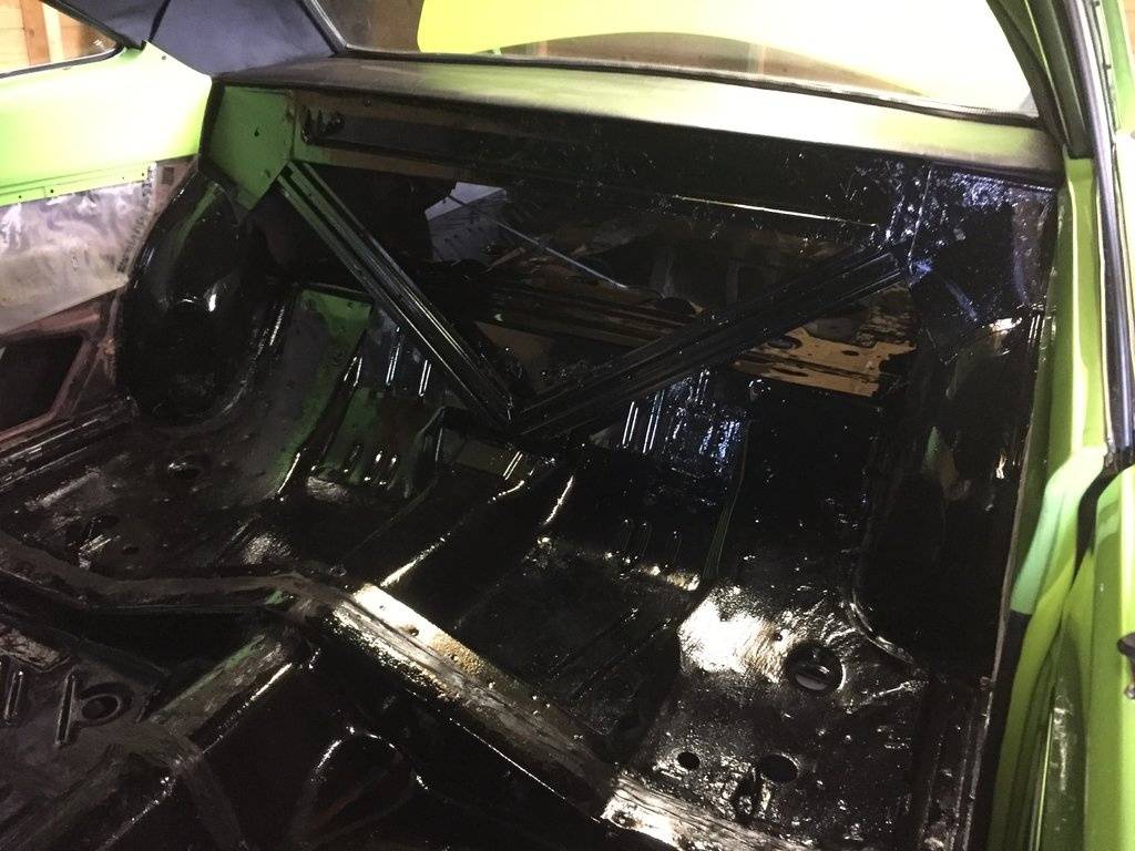

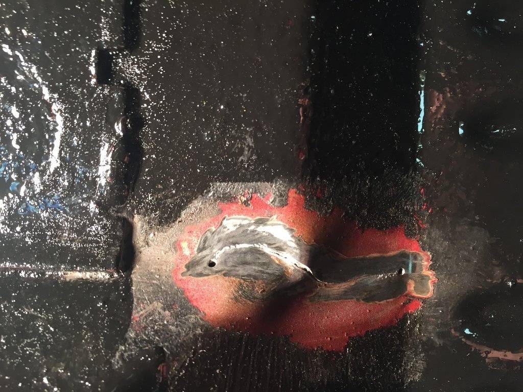

This morning i sorted my crack!
Guess that came out wrong :)

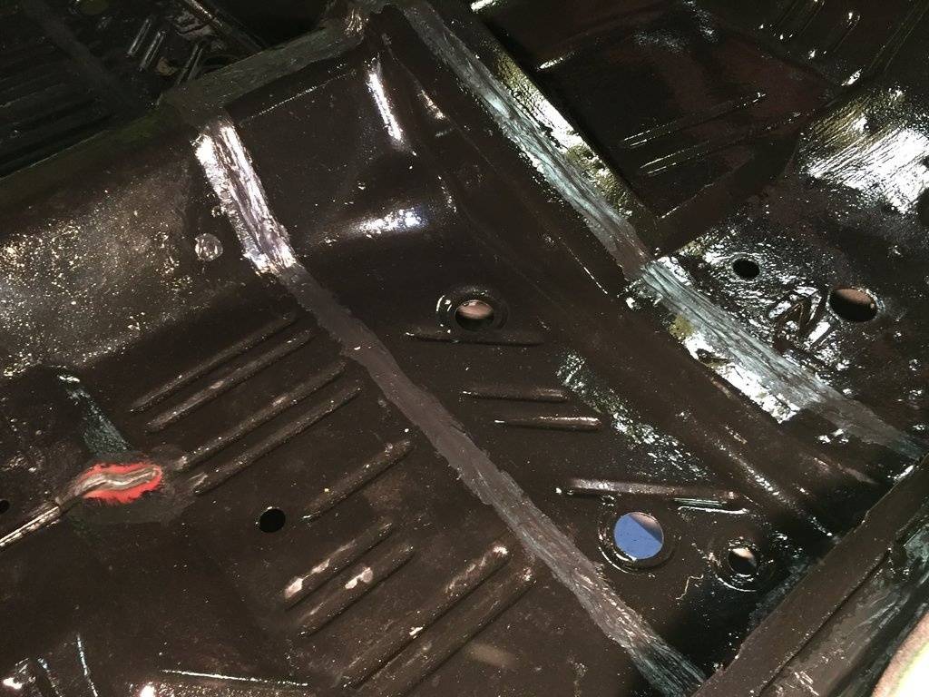

I cleaned it up and drilled a 2mm hole on both ends to prevent it from starting again.
After i straightened it up and created a little grove with a Dremel.
I only have a TIG welding machine but it did the trick, after cleaned it up and slapped POR 15 on it inside and outside.

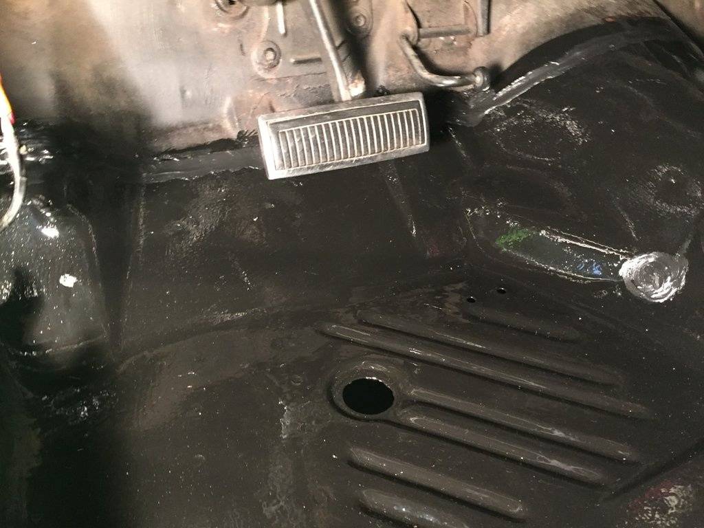

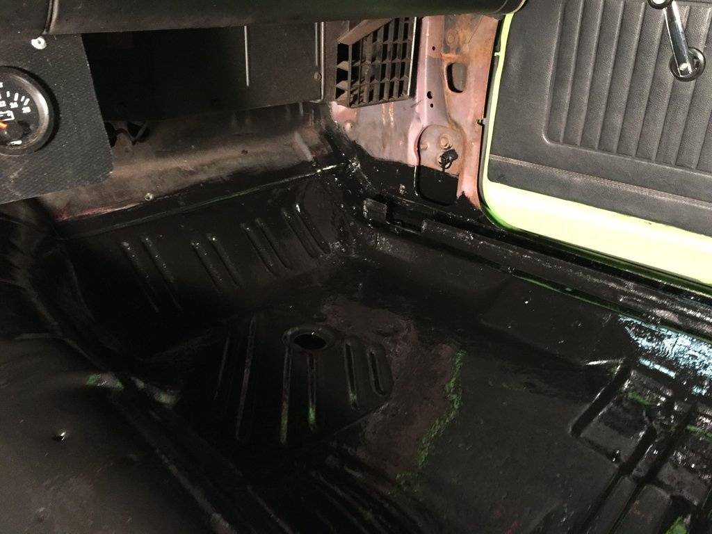

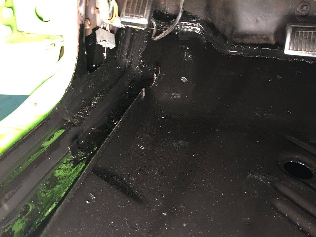

Got all the seams refilled with sealant and now letting it dry.
If that is cured in a few hours i can lay the top coat of POR 15 and the floor is done, and that will never rust again. (at least from the inside)

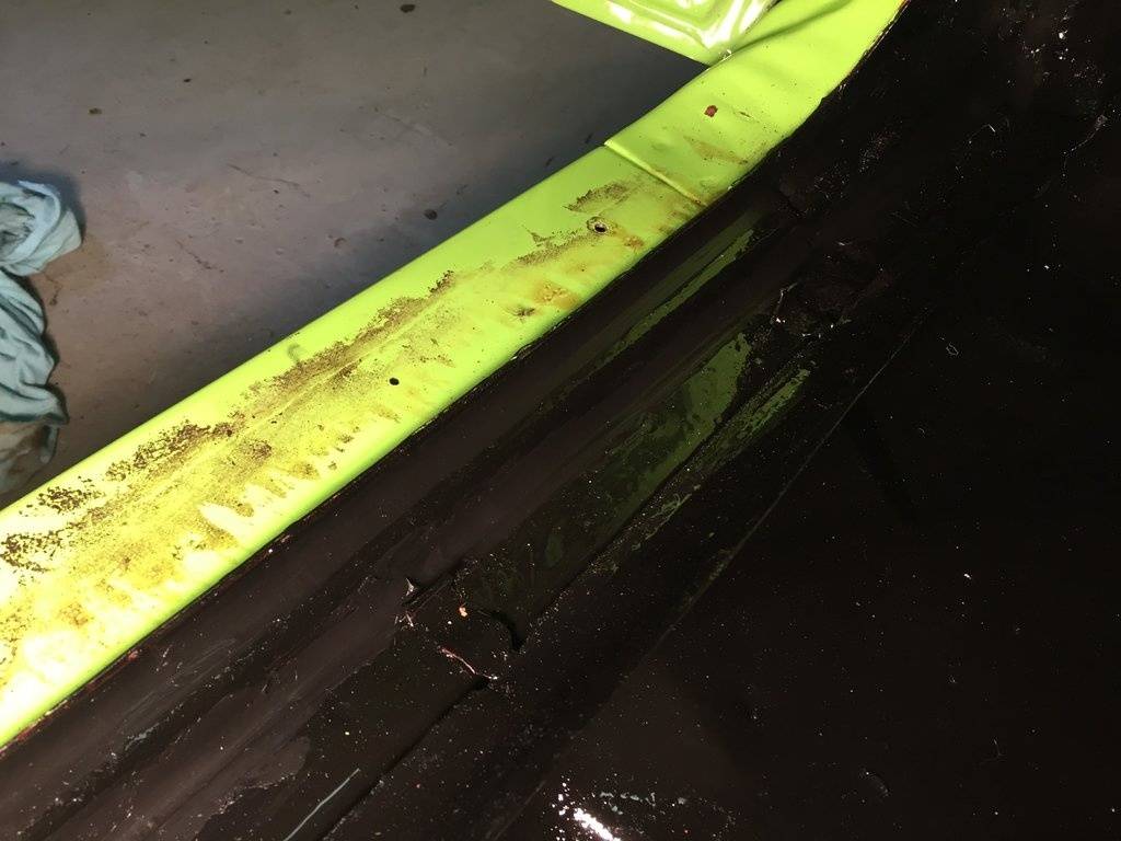

As for the afternoon and evening, i noticed the sealant was still not dry so did not start applying the last coat of paint.

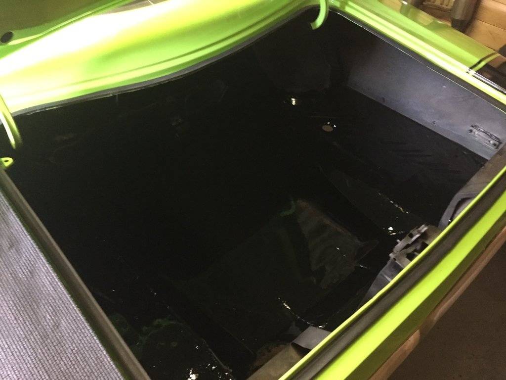

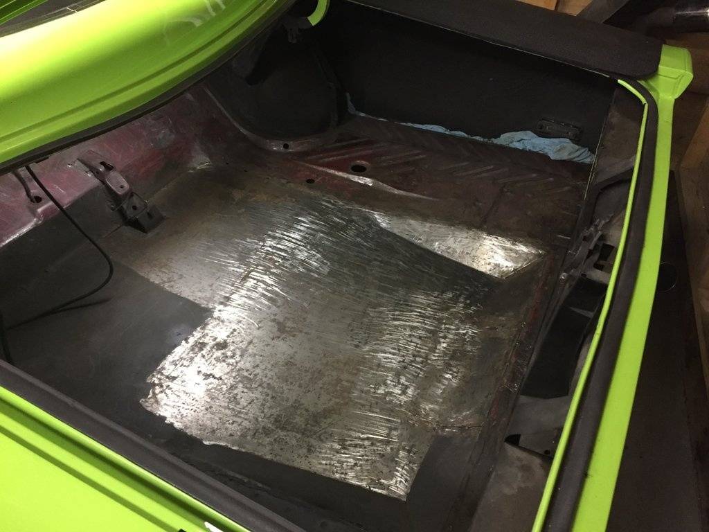

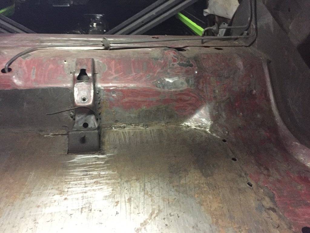

Instead i made a good start on the trunk, it was all sprayed black with some weird stuff.
Was easy enough to remove it with a paint scraper, although it takes forever.
Also ripped out the old sealant as far as i went, just be sure there is noting growing underneath.
But so far so good, only surface rust and everything is dry so not much to worry about i guess.

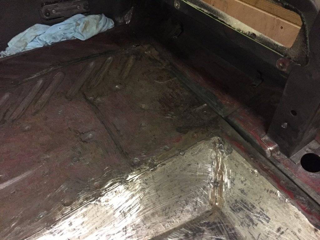

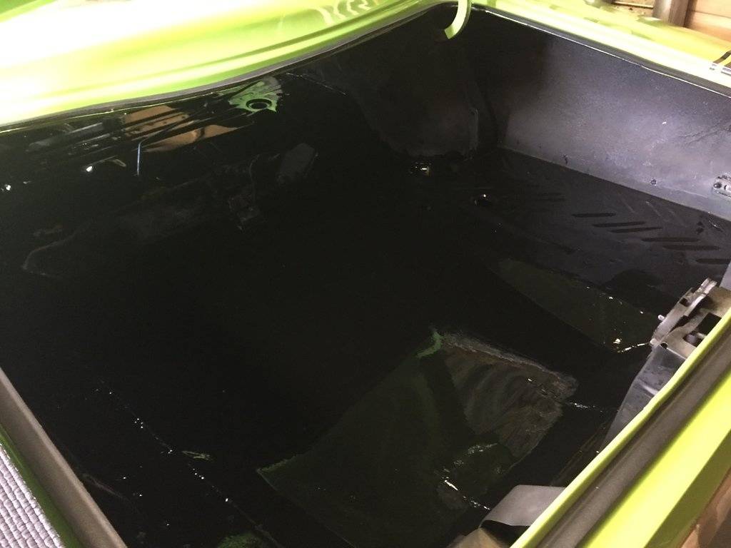

Spend another afternoon cleaning up the trunk, from the rear seat to the tail lights.
Overnight i will let it dry completely with a heater in the car blowing some warm air around, tomorrow POR time again.
Once the trunk has 2 coats of that and new sealant i can paint the top coat in 1 go through the complete car.

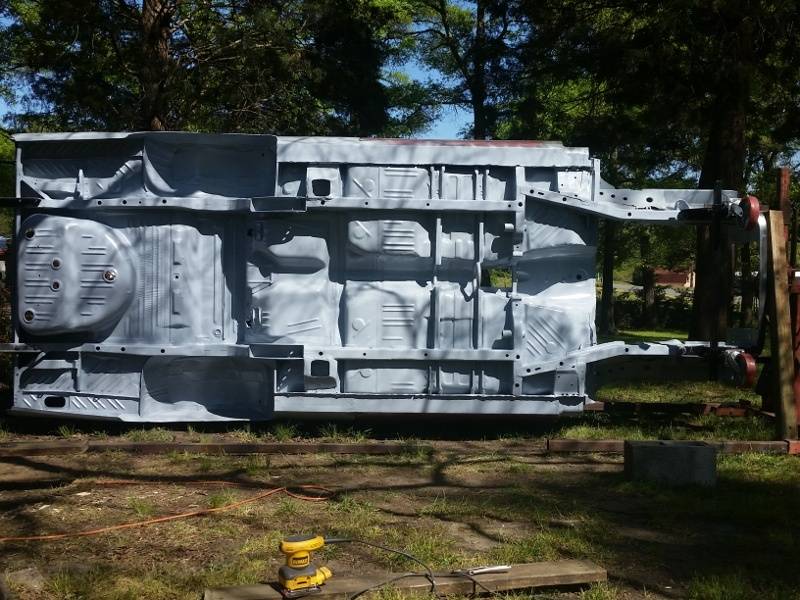

I stripped all the undercoating off the bottom of my car . . . and more. One think that I did notice in my door was that any place that there was a impact ( had something pointy strike the outer door ) the undercoating in the door was chipping away and easily removed with your fingers.
I think a fully painted bottom of the car looks incredible . . .

Wieste , I am not hijacking your thread. Your car is looking great but I really needed to ask this gentleman a question. I see you are outside on your rotator, how in the world did you get your car to look like it does in the picture without it rusting faster than you could fix it?
Did you tarp it at night and when you couldn't work on it? I don't have a shop big enough to work in and am amazed at how you did this. Or maybe you were able to jump on it and get it done quick?
Guess that picture was taken just after blasting, any way depending on what paint you are going to use you don't have to run to get it in the paint.
The POR 15 i am using now might adhere even better on a rusty surface you will get after blasting, once the paint is on and dry it will stop the rust process completely.

All of the work on the car was done in my shop. The picture that you see of priming the bottom of was done in 1 day - I pulled it out of the shop, attached it to the rotisserie, painted the bottom of the car, removed it from the rotisserie, and got the car back in the shop that same night
( unfortunately, with the rotisserie attached to the car, it will not fit in my shop unless I leave the shop door open - and I don't want to do that ).
In other words . . . I need a BIGGER shop ! ! ! !
