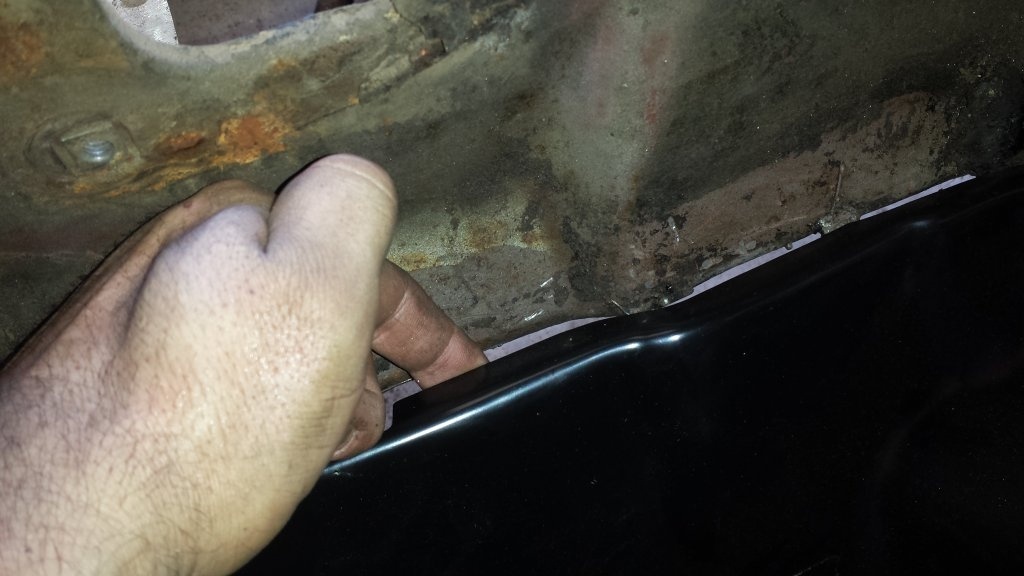

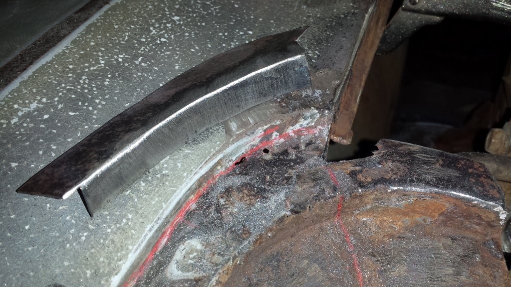

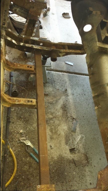

The pass side trunk extension gave me fits! It was not tall enough to lay flat and reach the lower quarter flange. I had to add 1" to it for it to fit. Plus the wheel housing side was way off. I had to add material here to the leading edge so it mated up with the outer wheel house and laid flat against the quarter. Ugh.

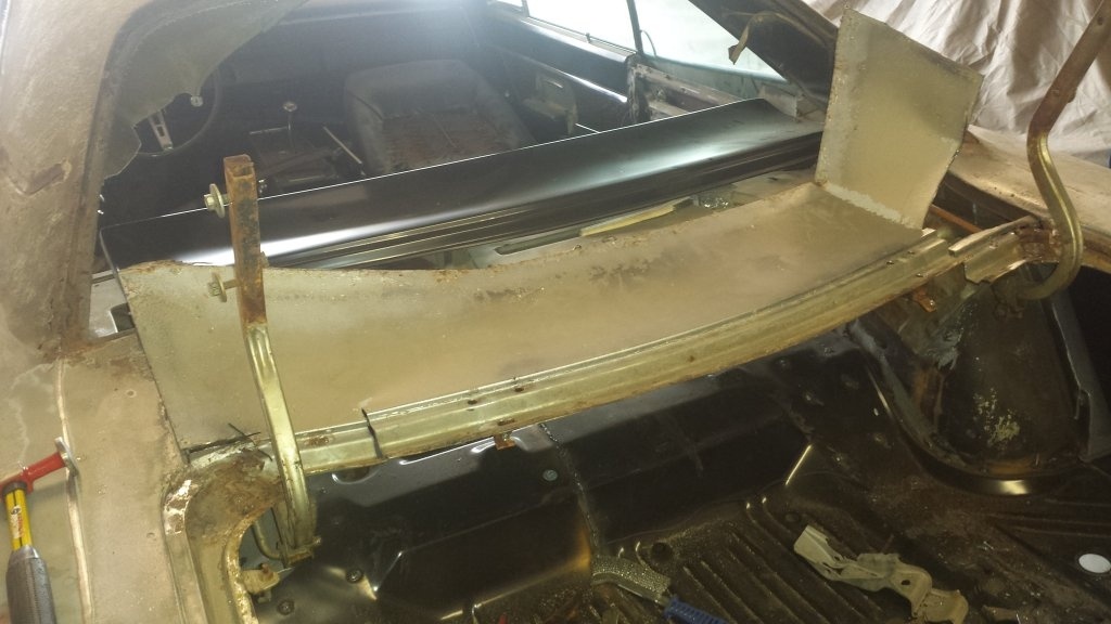

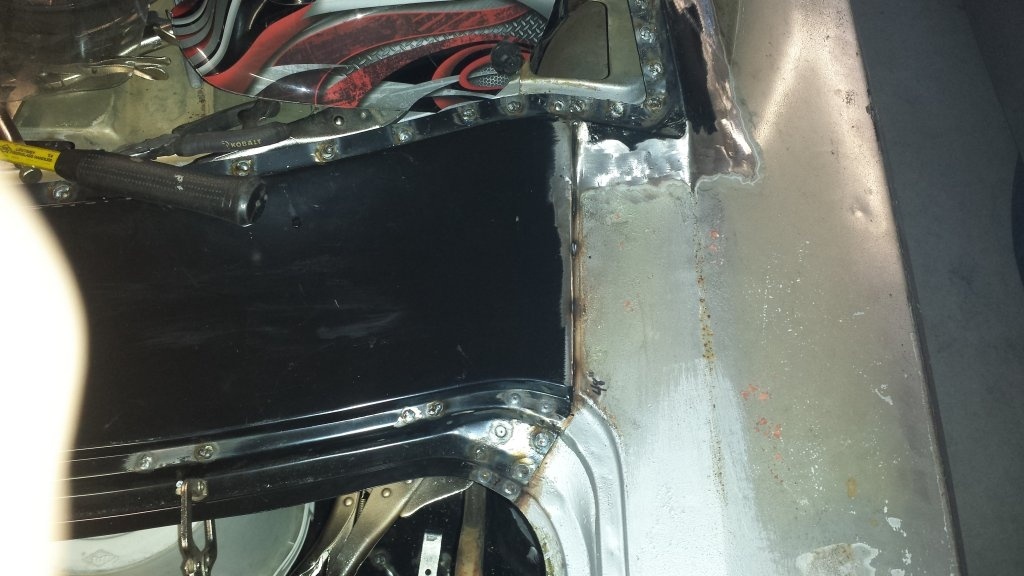

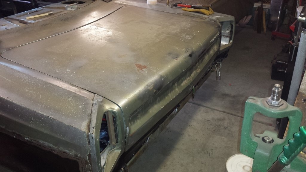

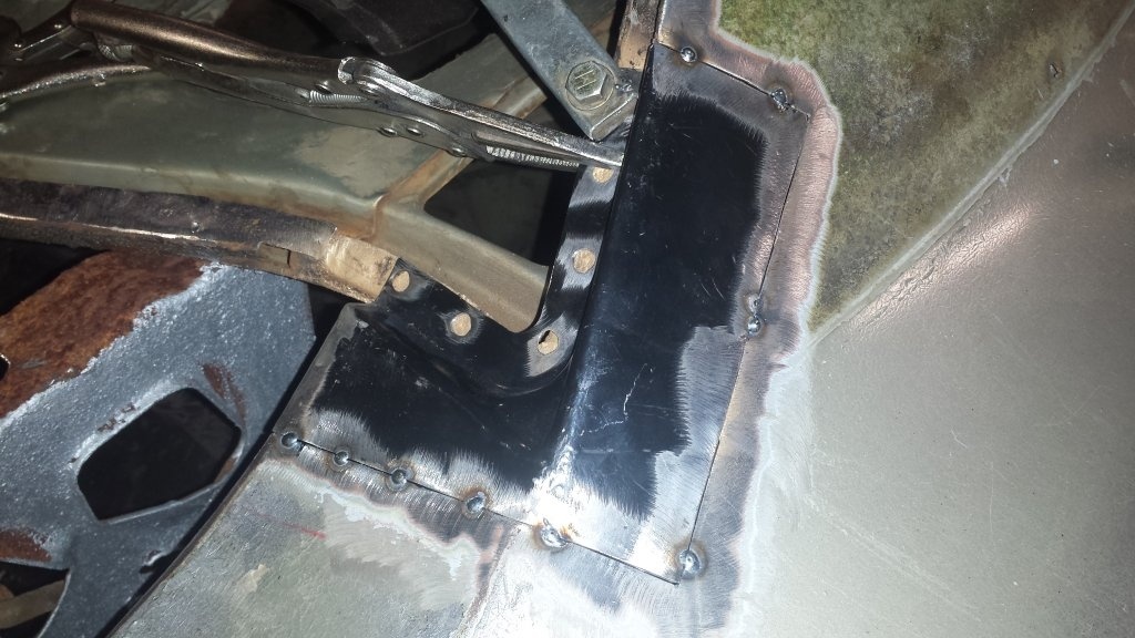

For the past few days I was then busy fitting the tail panel. Pain in the butt, but I got it pretty close. There is still some adjustment left in the hinges so I can tweak it around. It was a bit stressful when I tacked the first hole after checking and rechecking. Tacked a few more, checked fit, rinse, repeat. It is in, still need to tie the quarters to it once I get the other quarter welded in. Starting to look like a car again.
