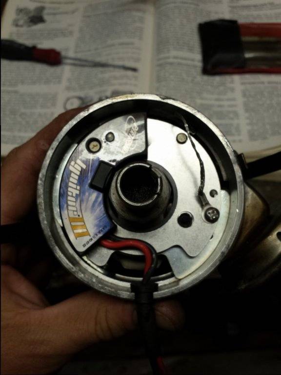

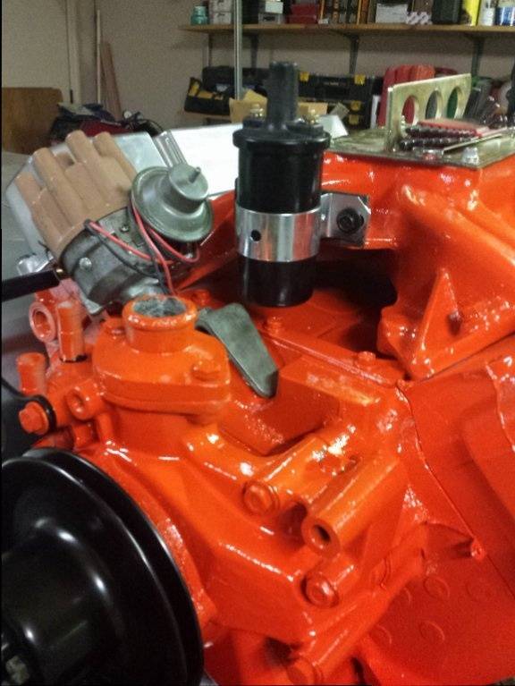

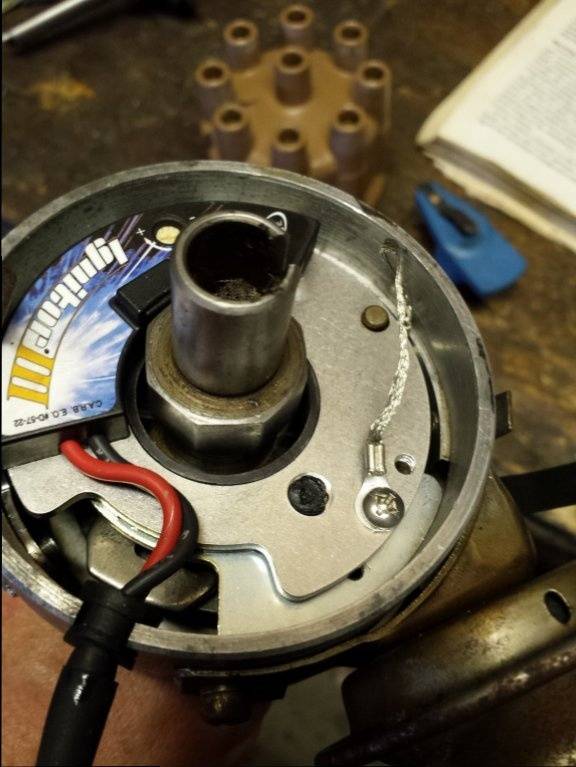

So I mixed and matched some parts and added my Pertronix Ignitor III. It goes in place of the stock points plate and is pretty straight forward I used a 9.5 mechanical plate from one so 19 degrees on top of initial (14 degrees) for 33 degrees to get a base and adjust from there.

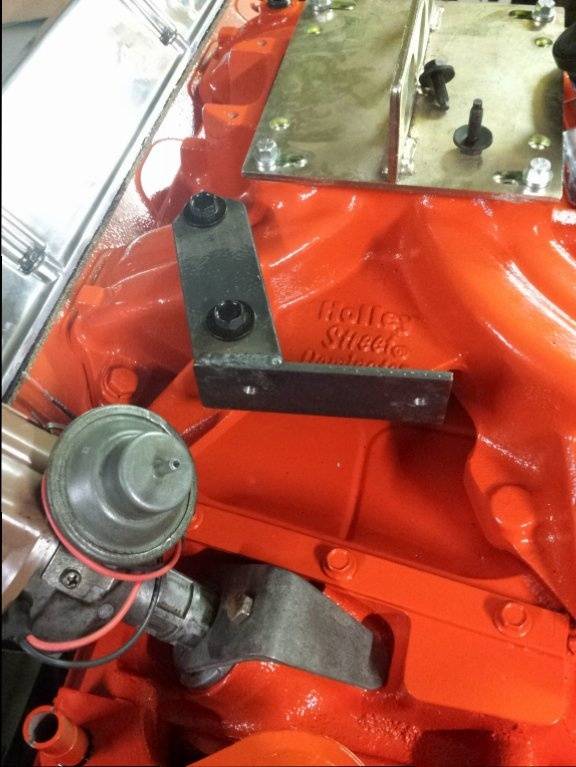

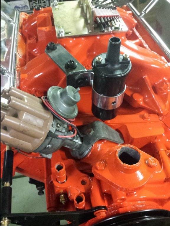

And I welded up a coil bracket that holds it vertical and out of the way of the carburetor.

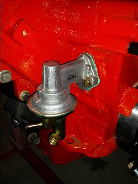

I also lubed and installed the Carter fuel pump. This puts out 5.5 to 6.0 psi which is exactly what I need for the Eddy carb.

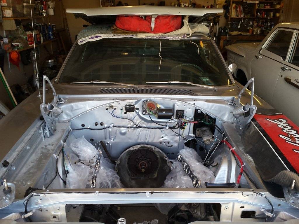

No power steering! No power brakes! Bare bones lol.

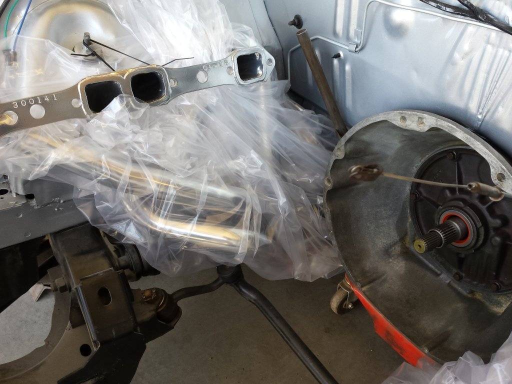

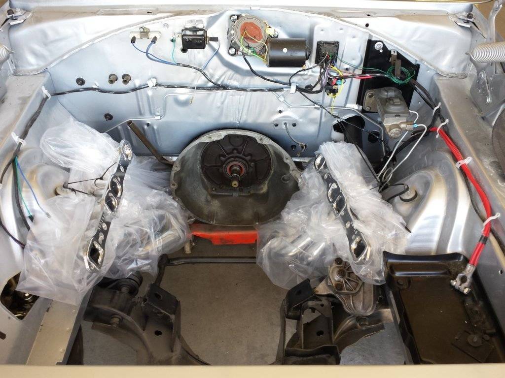

Is it possible to attach the headers, leave them loose and drop the motor in?
Or is it better to lay them on the inner fenders and drop the motor around them?
They came with protective pouches to keep them from getting scratched in install.

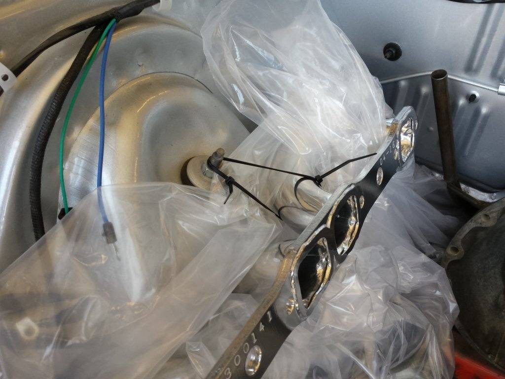

I laid a blanket on the inner fender, than laid the headers in and secured them with zip ties & wire. Also if you can hook up your starter harness now that will be easier. I put the headers on while it was on the stand to get the wiring routed correctly.
Also if your putting a mechanical oil pressure gauge on, now is the time to install the fitting and line, same with OEM sender.
I also set up the rev limiter on my Pertronix. Super simple. Hook up to a 9v battery to red and ground module base. Adjust until it blinks the rpm you desire. I set mine at 6100 rpm as my governor is set to shift at 5800 rpm.
Recieved UPS notice that my torque converter is getting here tomorrow! ! So I prepped the car. I need to get trans fluid to fill the converter before it goes in. I hope the headers fit, fingers crossed.
