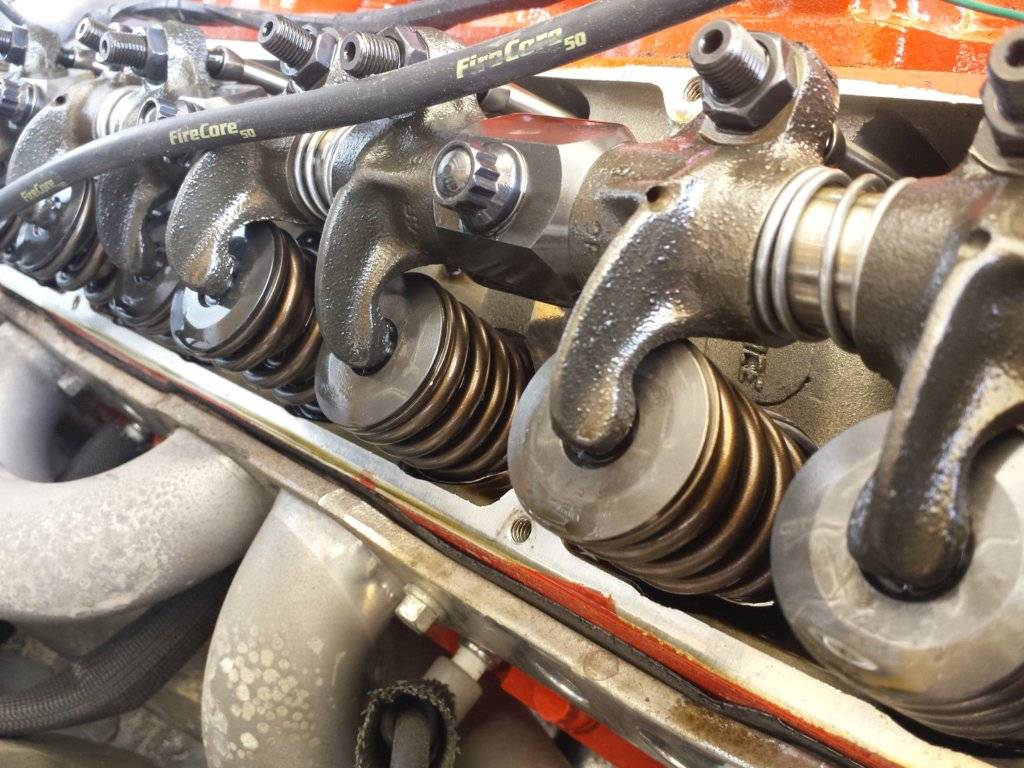

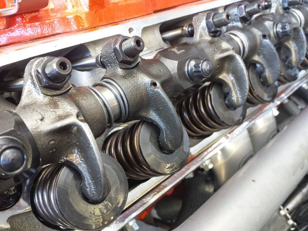

I was bored so i pulled the valve covers and lashed the valves. The heads seem to be getting plenty of oil, no other issues. There were a few valves that needed a tweek but nothing substantial. While I had the valve covers off I checked rocker shaft caps torque and inspected the keepers. Again, everything is good. I did have to tighten the header bolts.

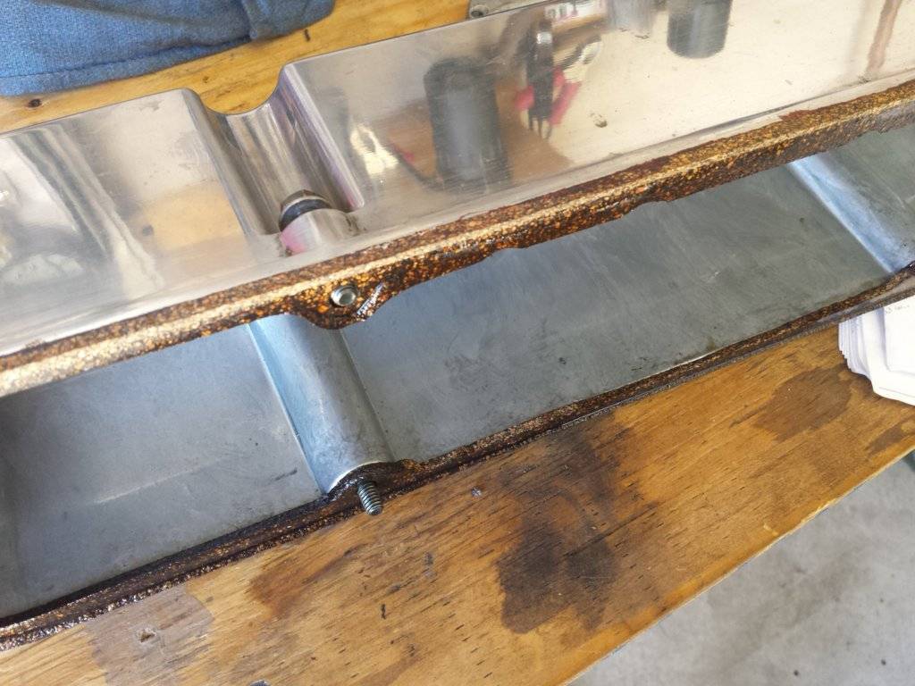

On the valve covers, especially the aluminum ones, I apply the gasket to the cover side via Permatex High Tack. Keeps it from squishing out and makes it easy to remove the covers to set lash.
Done.

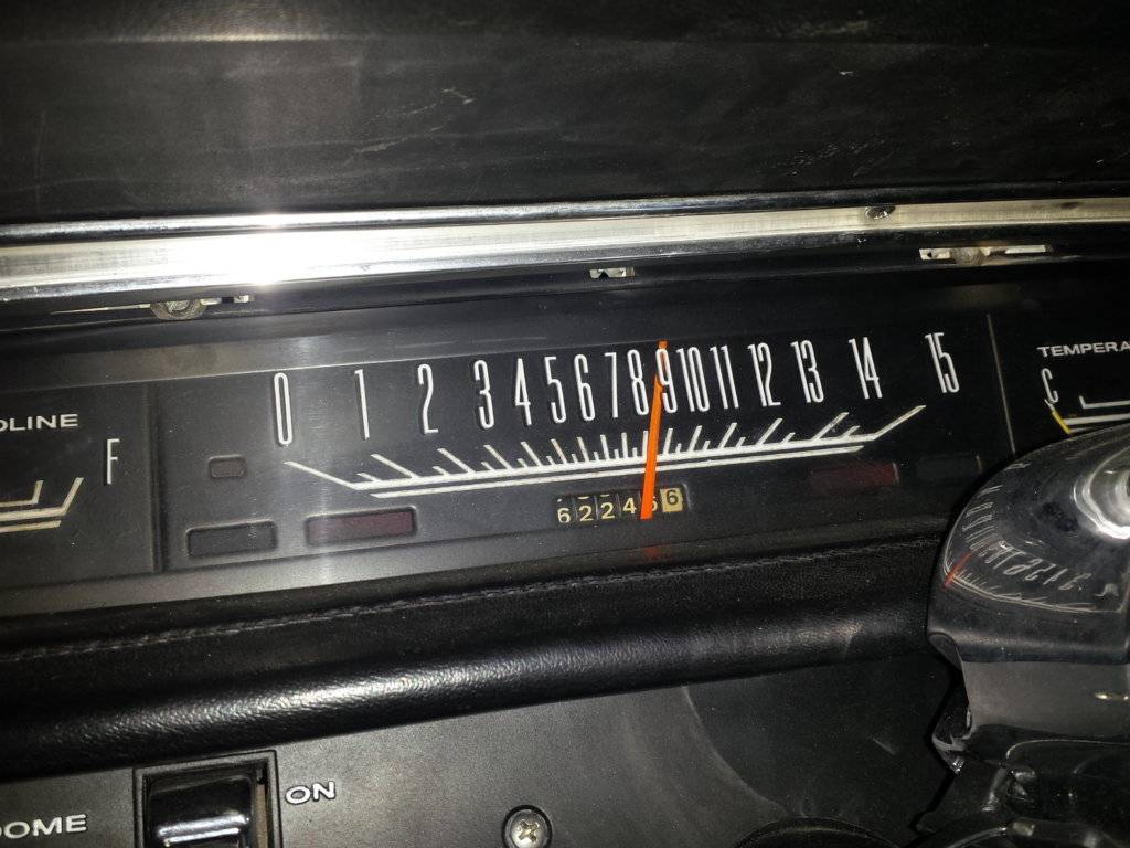

I almost forgot, a few days ago I got on it getting onto the freeway, the speedo needle wigged out and bounced around until it ended up here. I am really not in the mood to pull the dash, again.
Well you know it's not the speedo cable! IT never stops!
Yup. Dicks in Tempe (not Phoenix) will fix that right up. The plastic keepers are broken. Think it was $180.

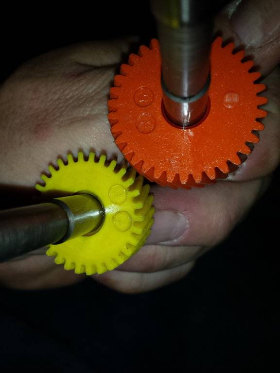

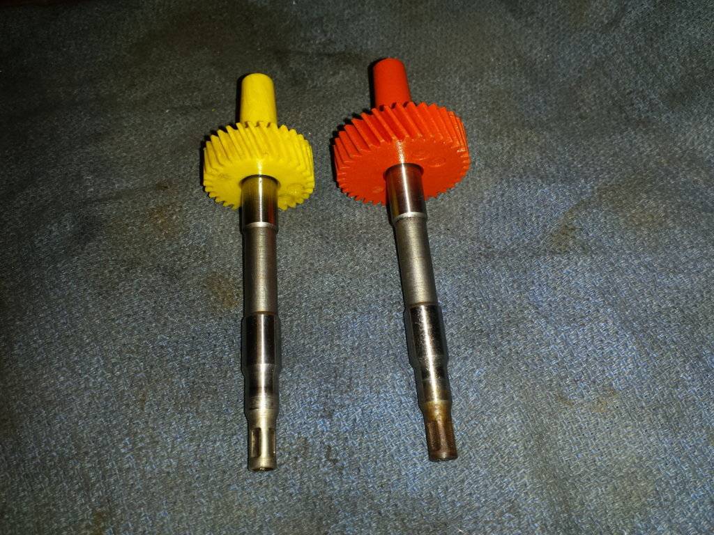

And I got the speedo fixed. Pulling the dash os easy but a huge pain, my biggest worry was more random electrical gremlins but it worked out.
The speedo spring housing was loose so it shifted the needle around the gauge. There are 2 tabs on the gauge face, one of which I used as a stop and set the spring and reset the needle on the 0 stop. In hindsight, I probably could have slapped it in to check accuracy but I didn't. So at speed, the gauge was reading 12-15 mph lower than gps mph. So I finally got and installed a smaller speedo pinion (went from 35 to 30). I'll test it tomorrow for accuracy.
Got lucky on that one. I tried that as well but it only worked for a few miles.
