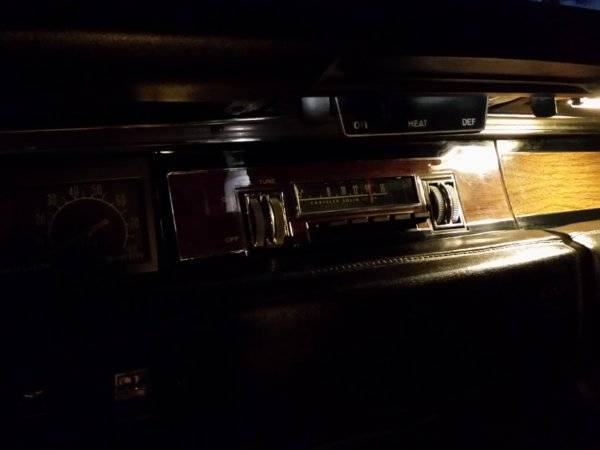

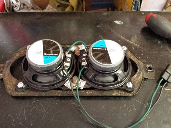

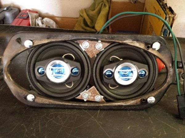

I purchased a radio from a member here recently and installed it today. The tuner wheel has a white gear which was cracked and wouldn't tune so i superglued it to the wheel, cleaned up the internals, new bulb and slapped it together. For the speakers, I used two 4" speakers from Walmart wired in series to end up with 8 ohms. Mounted them to my existing mount. Words of wisdom...offset the speakers to the far right side of the mount otherwise the heater control panel will not fit! I had to do it twice.
I found the factory 2 prong outlet behind the dash and wired in a new Packard fitting for the speakers. Everything is in and working which I am surprised as I was fully expecting to have the radio rebuilt.

I tried to gorilla glue the gear together and press it on the tuner wheel but the glue was crap so I just glued the entire thing to the wheel.

I enjoy the original radios as well. I was about to drop $350 on an am/ fm/ Bluetooth version from ebay because people want stupid money for unmodified 68-69 radios. A rebuild on an original is $400+. I was happy to find this for sale on the fbbo and offered $50 plus shipping not knowing if it would work. I love trying to tune in am stations on the road. It gives me a connection to the past I suppose.

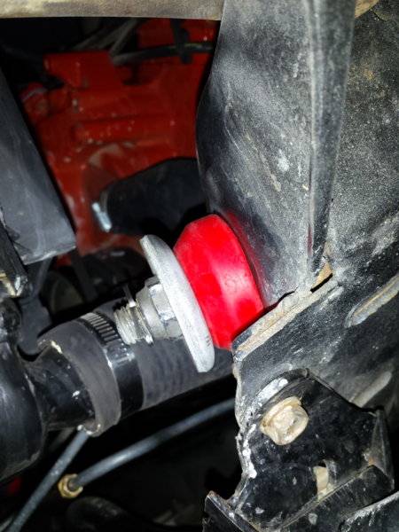

Took it over to have the alignment done and the guy mentioned the strut rod bushings looked worn. The car had been pulling left during braking and they looked a bit crushed so I replaced them with urethane bushings. After I had the pass side loose I saw that the lca bushing inner sleeve had pulled out about 3/16" from the rubber so I replaced it while I was in there. Pull was still there so I re bled the pass front brake again and adjusted the brakes a little tighter and I think that did the trick.

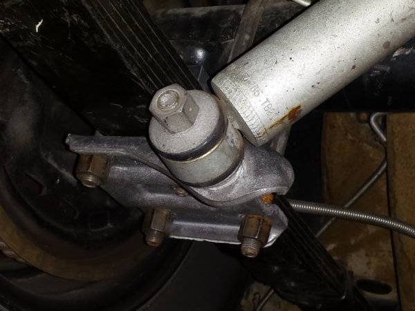

I have also been chasing a thunk clunk in the trunk. Pretty loud in the cab and I can replicate it by bouncing the rear end. Removed everything and still there. Re adjusted the exhaust, secured any and all lines away from the body...still there. Soooo I started pulling the new KYB gasadjust shocks....sound went away. Put on an old, used set and no more sound. I can't say how much crap I have bought that goes bad or is bad out of the box.

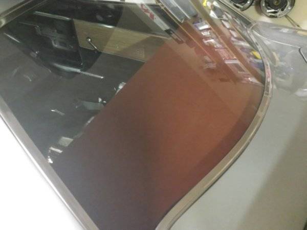

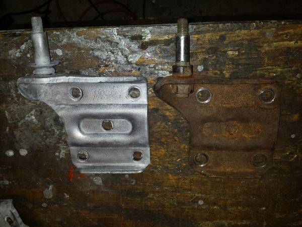

I am really searching for stuff to do now lol. The shock plates on the x were "fixed" at some point and looked crappy, found a used set on here (thanks Steve!). Got em in today, blasted, cleaned and installed. They look much better.

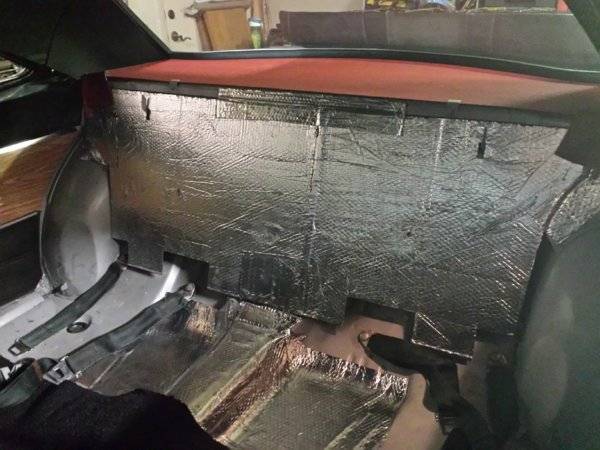

I finally got around to getting a package tray and trunk divider. I layered the bottom and back with sound mat, including the seat pans. I also had to weld the lower pass side seat latch wire which was loose from the frame.
Have you had time to drive it to see if there's a reduction in noise? I put sound deadener everywhere but under the rear seat. Wondering if it needs it?
