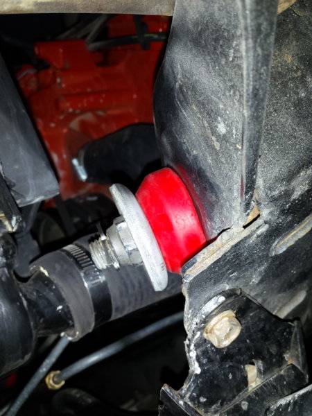

Took it over to have the alignment done and the guy mentioned the strut rod bushings looked worn. The car had been pulling left during braking and they looked a bit crushed so I replaced them with urethane bushings. After I had the pass side loose I saw that the lca bushing inner sleeve had pulled out about 3/16" from the rubber so I replaced it while I was in there. Pull was still there so I re bled the pass front brake again and adjusted the brakes a little tighter and I think that did the trick.

Did you flip the washer for a specific reason?

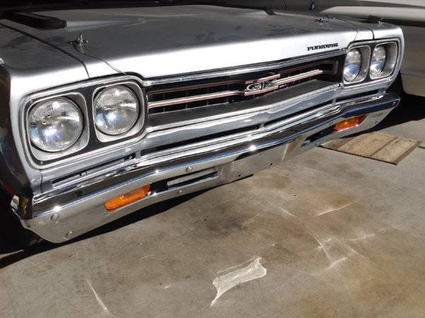

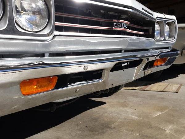

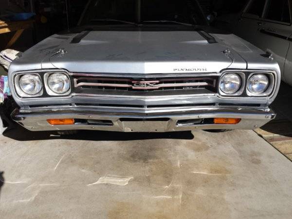

Looks great! What did you have to tweak bracket wise?
The front bracket bumper mounts did not fit without putting tension on the bumper once tightened. And since they are two piece I had to get them to work together before mounting to the car.
Thats not bad at all to deal with...good to know!

And the bumpers they were mounted to originally were tweaked and not straight which contributed to the adjustments I had to make on straight bumpers. The AMD bumpers didn't take much to flex if the bracket was slightly misaligned. I actually used a washer under one bumper bolt because I just couldn't get the thing to sit straight.

I have always been told the washer is cupped away from the bushing.
Nada....Cup towards the bushing....Poly vs rubber no difference I had several cars with polls installed the same...

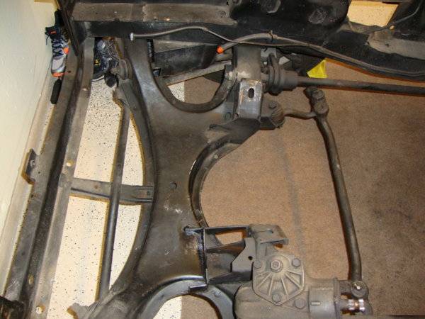

Pic is from my X before removal for the first time in it's life....
Chrome and flex is no bueno....Not bad at all...Looks very nice...
My friend cracked the chrome on his bumper when he tightened down his bumper!
It is a gut wrenching sound....I had a charger bumper guard pop the chrome once when tightened done. The pressure on the edge made it snap off the guard.....I learned not to be superman anymore, lol....
