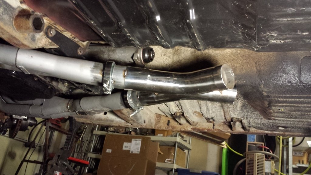

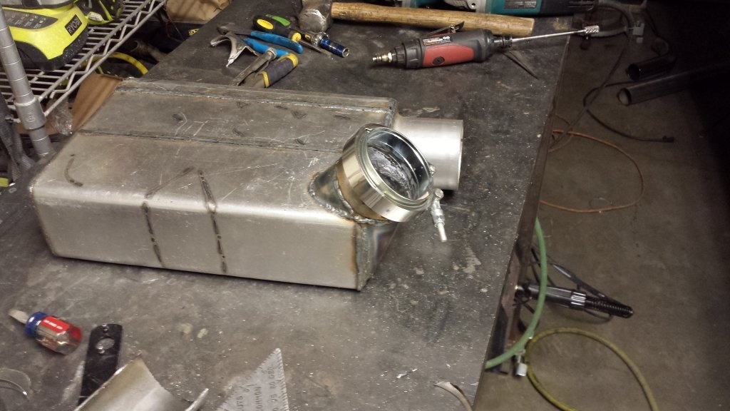

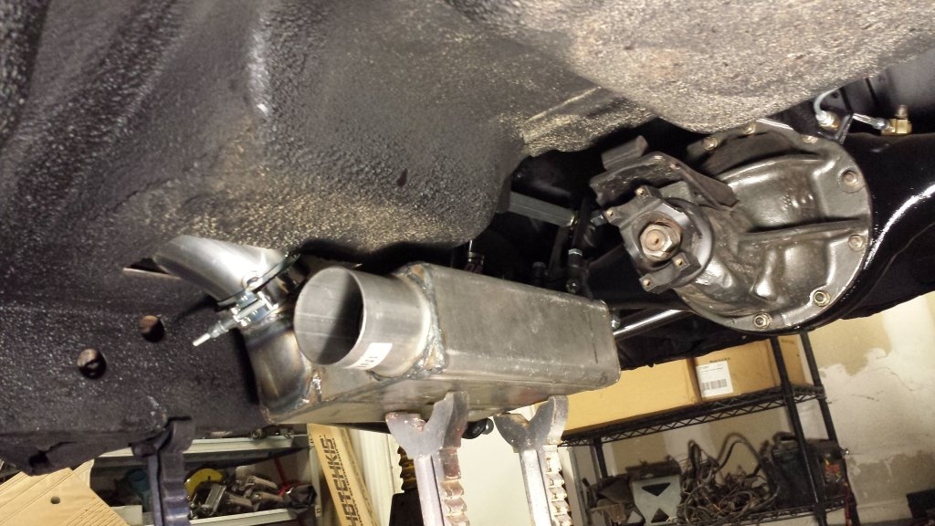

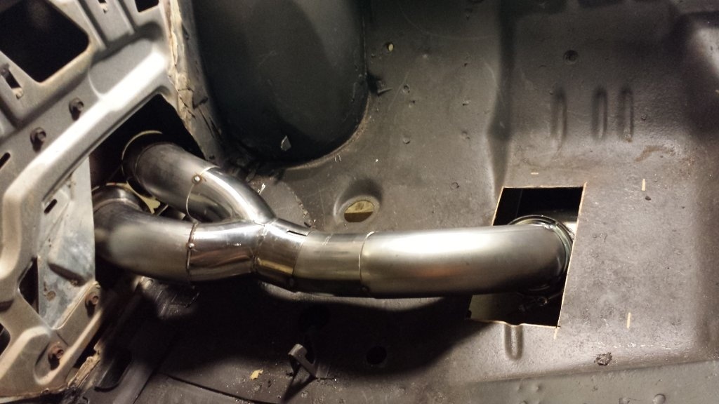

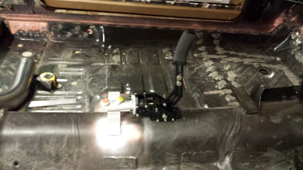

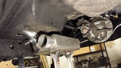

Modified the muffler so it has a 45 degree exit, and ran the pipes. The drifting handbrake showed up. Now gotta make the brackets for it

Love the side exit exhaust! Mines side exit too but under the rocker:(, I've looked at it a million times trying to figure out how to route it threw the rocker like you did with everything that's in the way.... I like what you did but was thinking it would be easy to remove that portion of the floor and build the floor over it putting it back under the car? Love where your headed with this build.

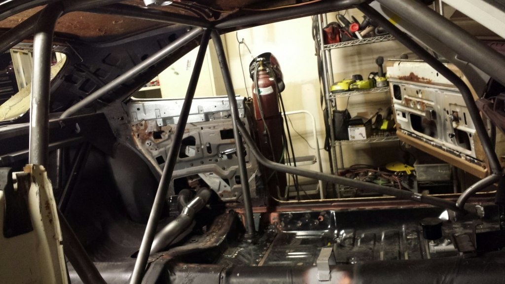

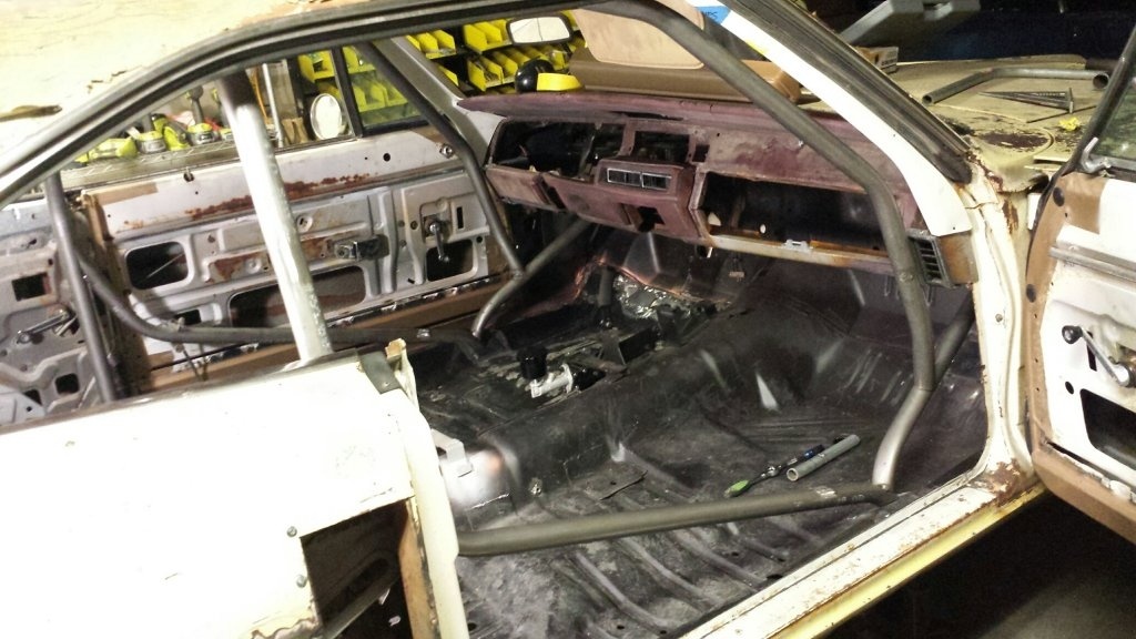

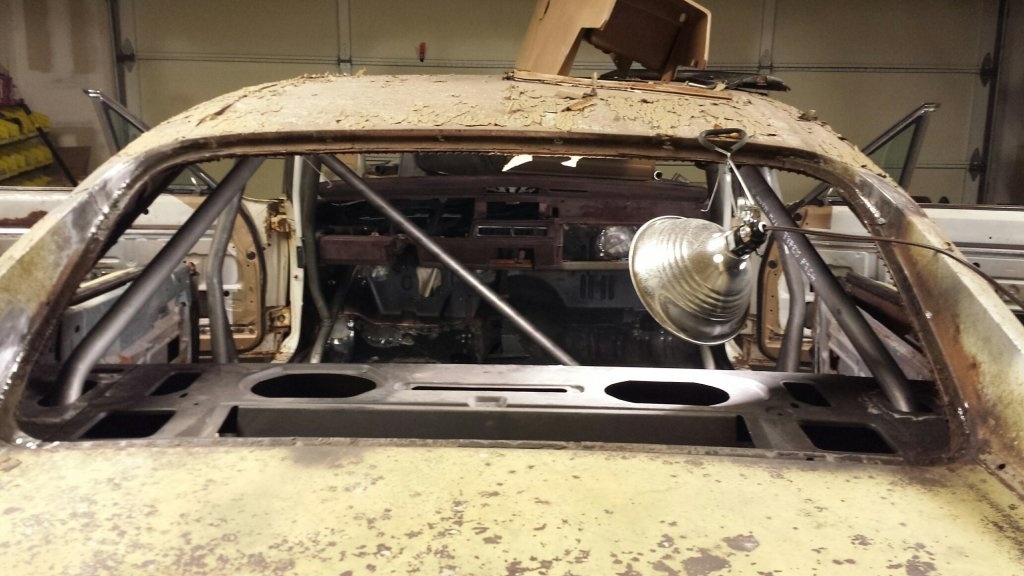

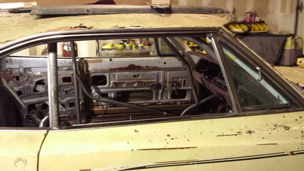

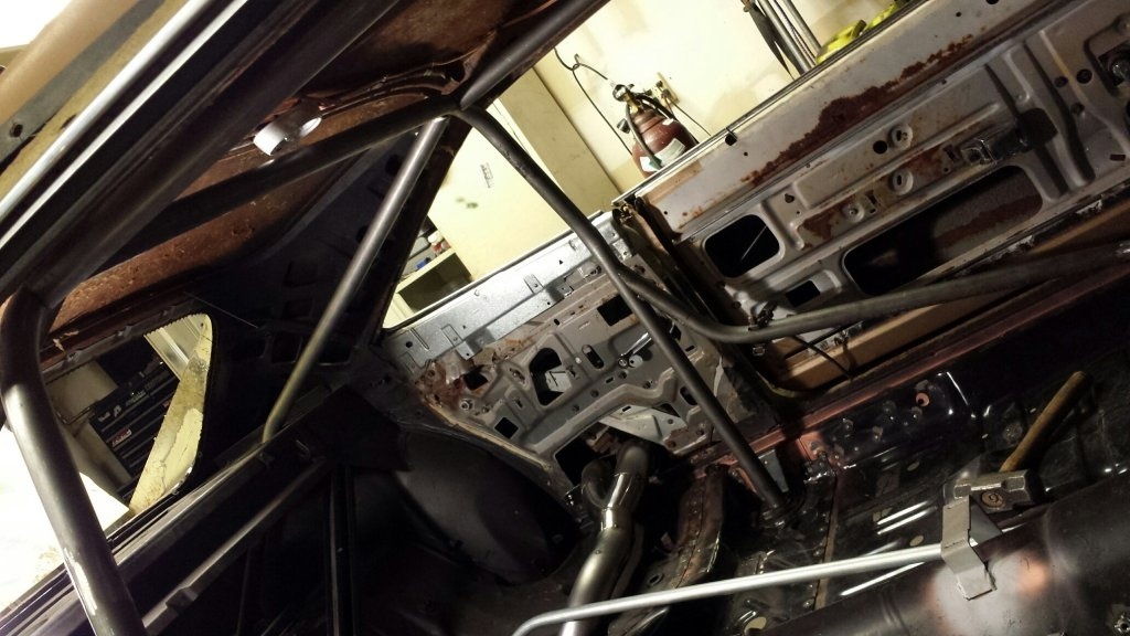

my project this weekend was the roll cage but since it was my first roll cage ive built i went kinda slow. i still have more bars to add, braces that tie the roof to the cage and then some fancy shmancy gusset bracing. cage was tricky as i wanted a back seat without people hitting their heads on it, glove box to function and visors to work. hoping i can finish the cage this week and get started on the fuel system. the dash and interior bezels do not go to this car, they were just used for mock up.
20160731_221042_resized.jpg 20160731_221103_resized.jpg 20160731_221256_resized.jpg

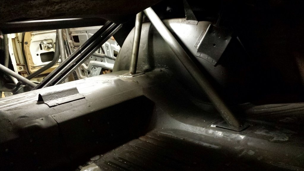

stayed up late to put a few more bars in, only 5 more to go
20160801_000127_resized.jpg 20160801_000211_resized.jpg 20160801_000234_resized.jpg
