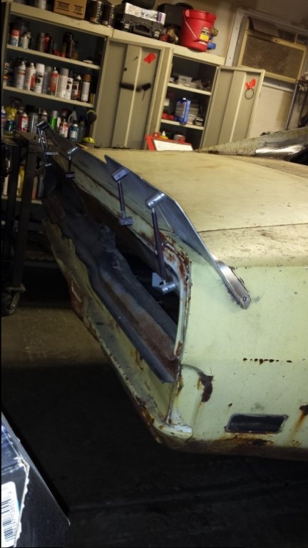

Spoiler braces, used mix match set from my old circle track car

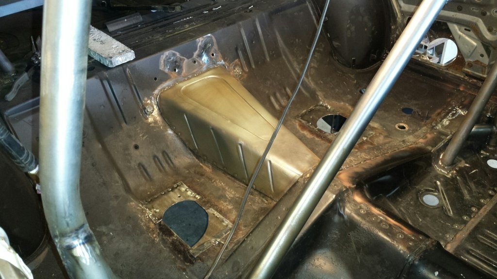

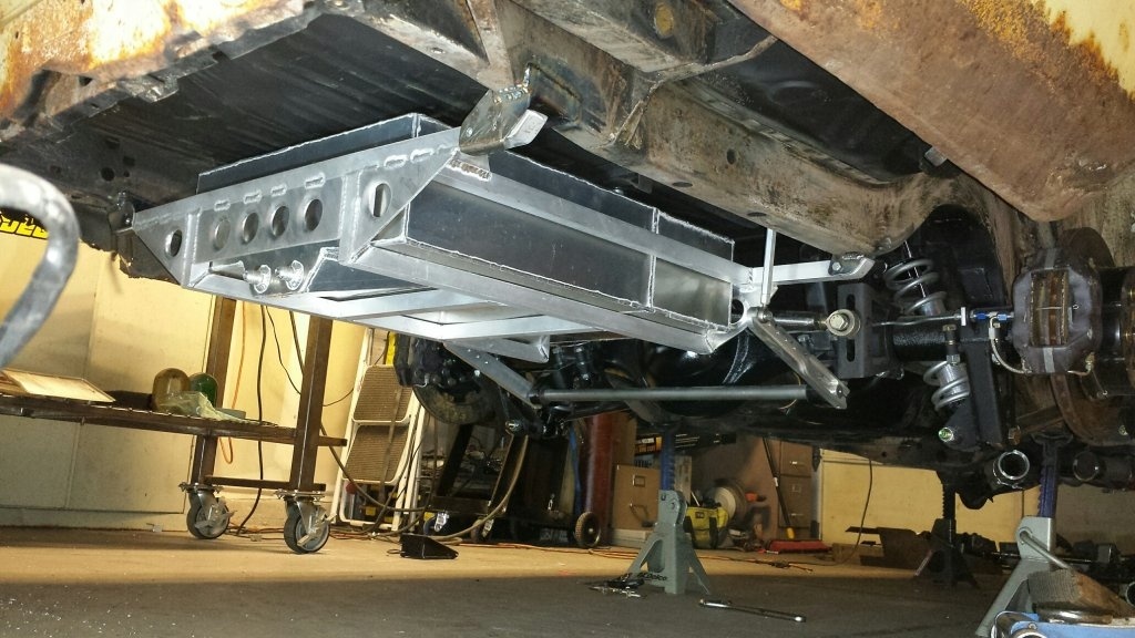

Sexy beast...just got my aluminum fuel cell in, gonna cut it up and modify it for size and bead roll it
wasnt diggin the stock tank in the car, so i made a fuel cell an cradle for the car
Sweet tank, great skills...
I was wondering about a fuel cell like that the other night, that or modifying g the stock with added baffles. I wonder if would cause any problems making the/a tank a little bigger to hold more gallons.

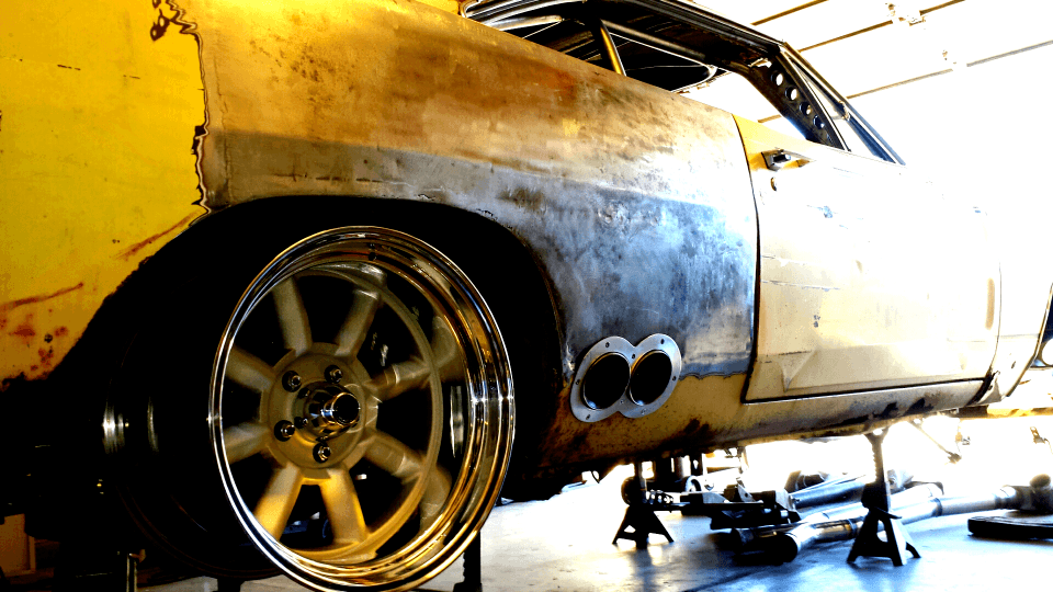

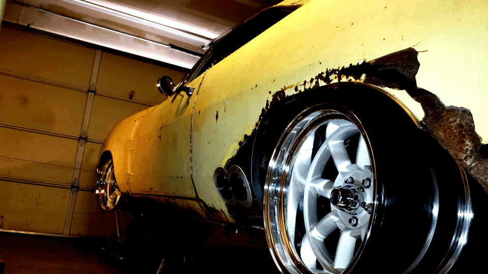

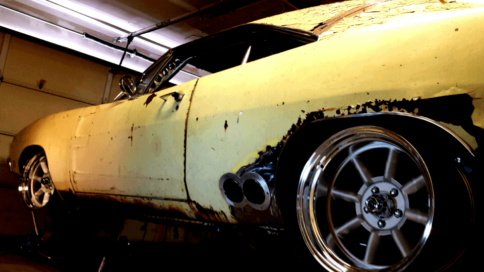

Wheels there OK
Not my style, too European
but it's not my car...
I'd go with a classic 5 spoke or Salt-lake or Halibrand personally
still in a 17-18 x 9's front 18-19-20 x 10's rears, still fill the wheel wells
have some tire with a bit of sidewall, so not to look like rubberbands
Rims & tires are such a personal touch...
I love the theme of the car still...
they are only 17's still going to have plenty of sidewall. i wanted these wheels so it would look like a vintage trans am roadrace car. minilite style

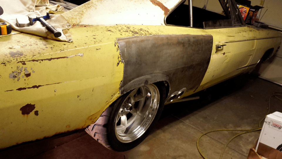

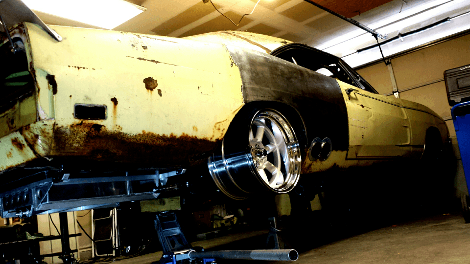

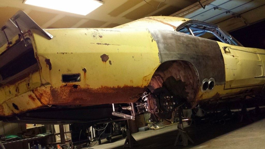

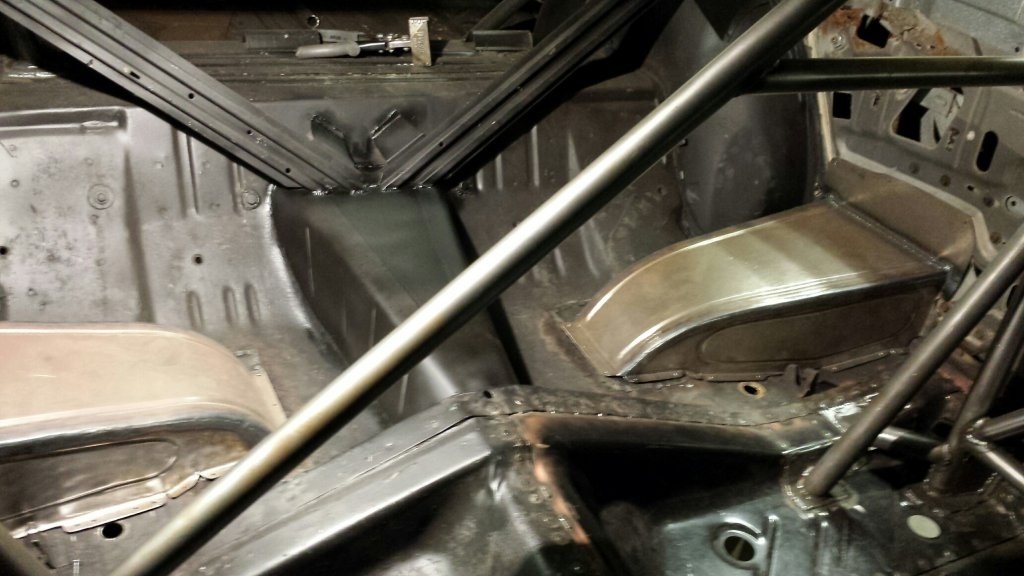

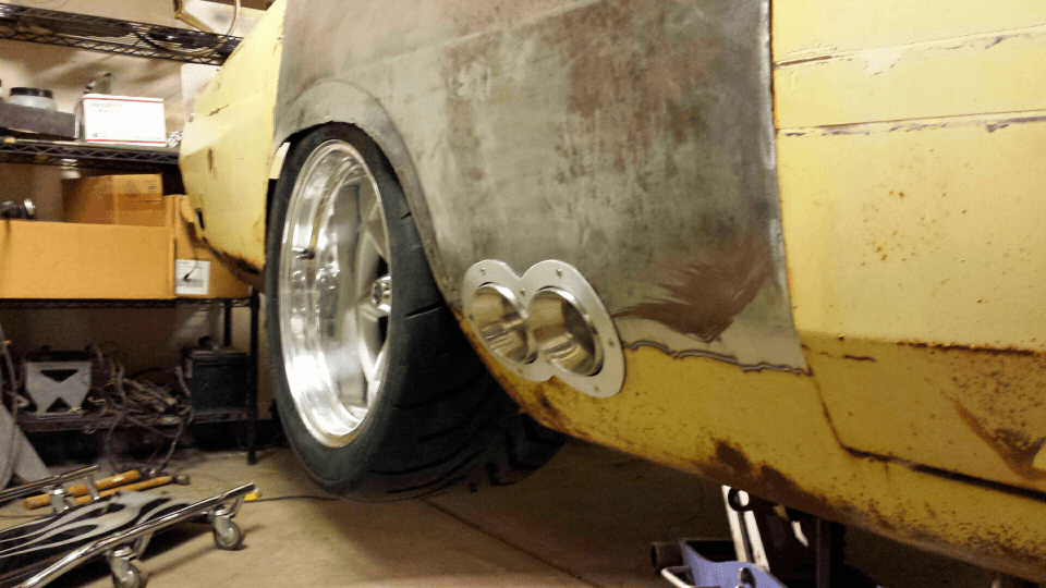

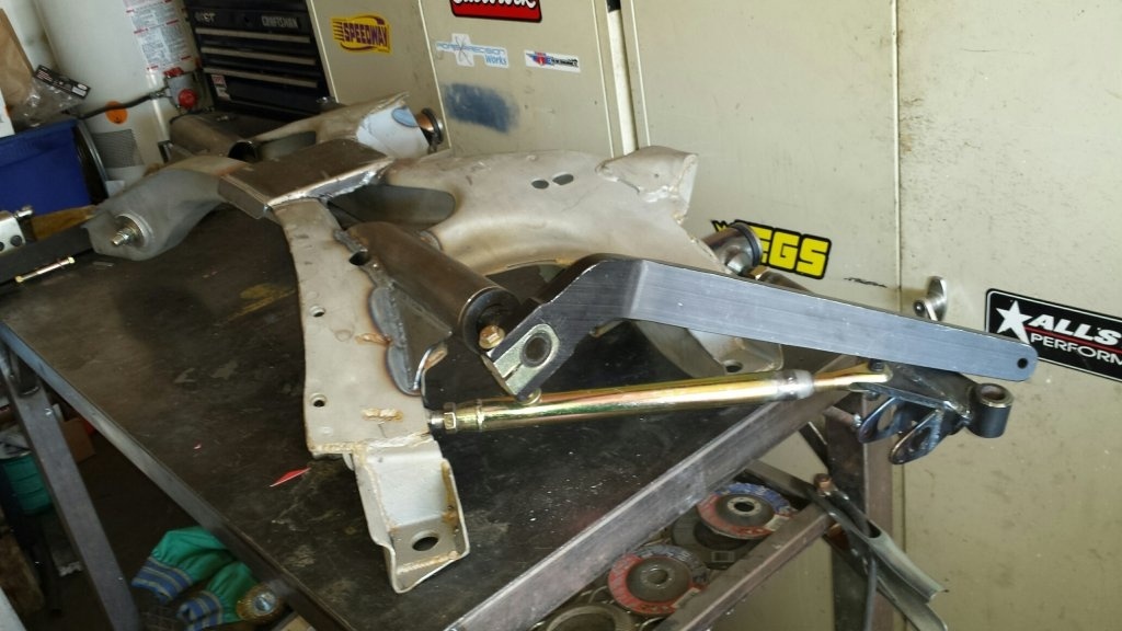

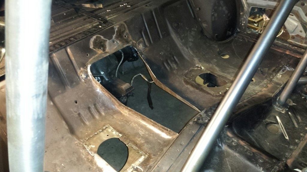

had to raise the tunnel on rear seat pan to get ride height i wanted. added a torsion front sway bar from one of my circle track cars. hammer dolly'd some wheel flares in the quarters
