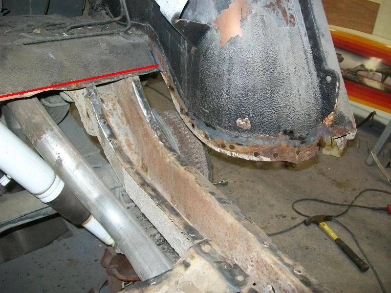

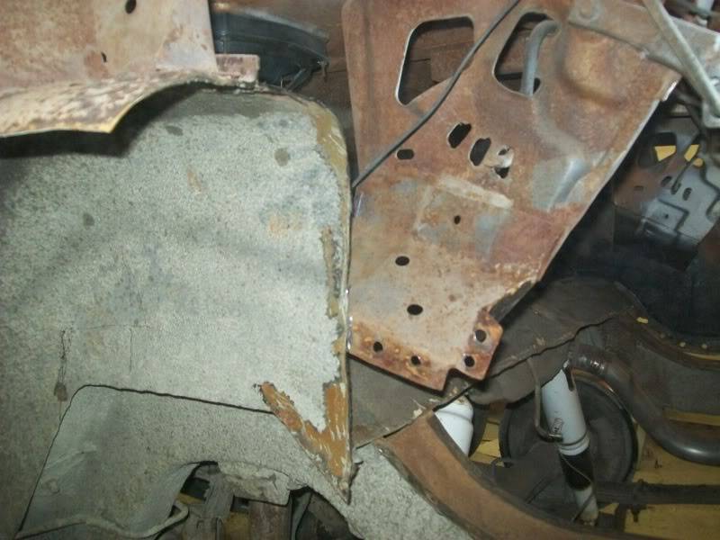

I'm looking for opinions here on something, i have a one piece trunk floor that won't fit into my trunk area right now without cutting the forward 10" or so off of it.
See where I cut my inner wheel well?
Now I have inner and outer well for this side of the car, so I'm thinking about cutting this inner further towards the back seat so I can fit the full length trunk floor in with no cutting and splicing. My plan up to this point was to cut the new pan and weld it to the original pan here...
I can fit that much of the new trunk floor into place right now and the metal is sound and solid above that red line.
But 8 or 10 inches forward of that red line is the factory seam, So I'm trying to decide if I should cut the driver's side well further open and remove the rest of the old trunk floor for full replacement or?
are you going to replace the whole wheel well? if so,then i would cut the rest up to the seam, imo.
I have no plans to seperate the wells from the forward structure, basiclly the cabin structure for lack of correct names/terms.
There is no reason to replace any more than what I have cut already as far as the wheel well goes. The only reason would be to gain access to slide the whole trunk floor in from that side. And the only reason to do that would be to get away from having a weld seam across my trunk right at that spare tire bracket area...
So i guess I'm trying to pick the lesser of evils.
Trying to pick what i will be happier with in the long run I guess.
I know i can grind and dress a trunk floor weld seam just fine I guess, maybe I should just stick with that original plan?
sounds like a plan dave. heck with all the seam sealers,undercoating,plus not driving them in the winter like we used to do,it should last just as long as it has if not longer.
I just figure with a common trunk floor job typically you deal with halves (LH-RH) and weld them up the middle and it works just fine...
It's just that I do have a full pan and I do have a full wheel well... So I could do a full 1 piece replacement if I wanted to. (trunk floor)
I don't want to be settling for this floor splice at the tire hold down bracket just because it might be easier/faster, ya know?
But you are right, with how we baby these cars these days and with the superior coatings products, they should last for ever.

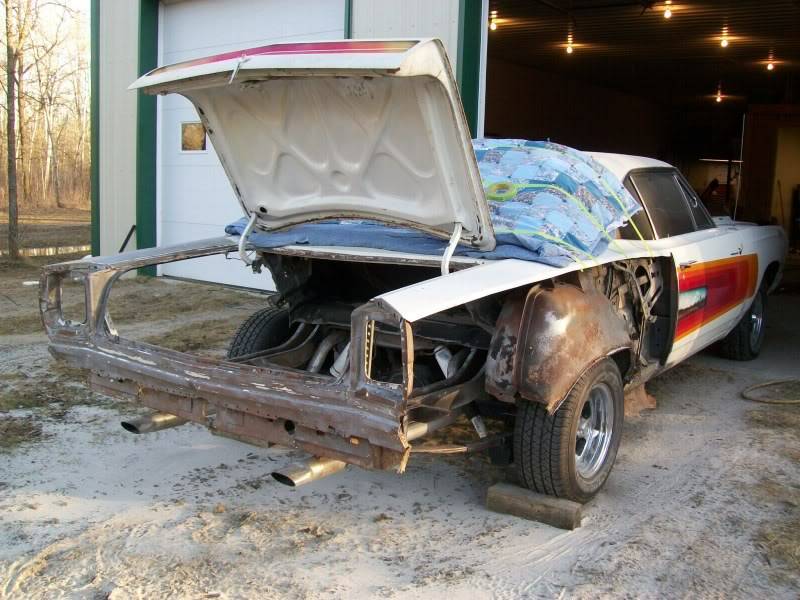

I got a little blasting done tonight, not the best because my blasting nozzle was missing and I couldn't find one in town at any of the stores. So I had to make a temporary one out of a 1/8" pipe cap with some gringing and a small hole drilled in the end.
It worked good enough to get things cleaned well enough for a coat of POR15, tomorrow.

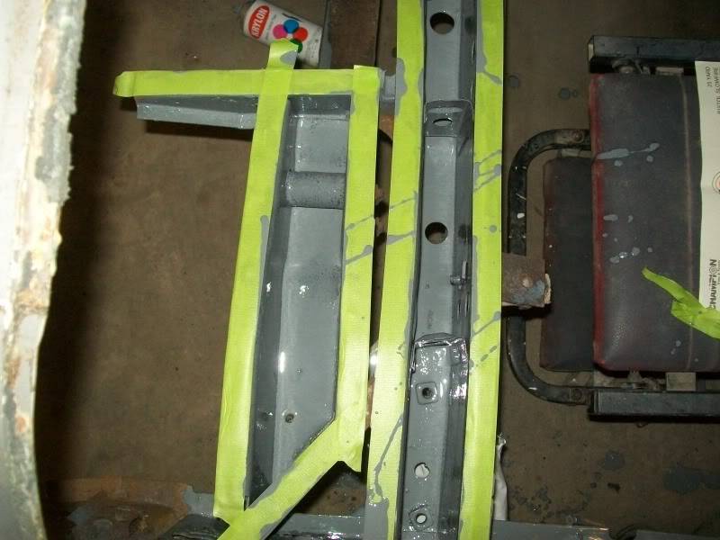

I think we might get some snow tonight, that's fine. Car is back inside and my frame rails are clean enough to brush some por15 onto and spray some weld through zinc primer on my weld flanges for some trunk floor, wheel house, trunk ext etc. welding.
Let it snow, I plan on making camp in the shop this weekend.

I take it you like the Zinc Primer as well?? I always had better luck with that more so than the Copper (snap, crackle, pop)
To be perfectly honest this will be my first experience with any weld through primer. I know of the zinc and I know of the copper but I have no experience with either.
It is encourageing to learn that the one that I happened to end up with is also one that you have learned to preffer.
I'm trying to plan my night in the garage, thinking maybe I should try to test fit the trunk floor pan (which will involve some trimming one way or another) possibly mark my pan from under the car. Then remove it for drilling/prep and try to get my POR15 brushed in where I need it so it can dry for a full day before I start welding pans in.

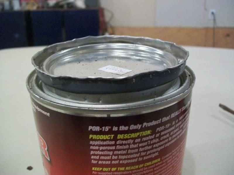

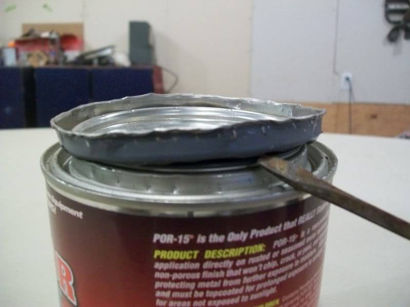

I've never seen a quart of paint put up this kind of fight, seriously, is this normal?
not open yet...
finally...
mess and all...
krylon can on the floor was used to mark the trunk floor pan from under the car.
Little trick to prevent the lid sealing up like that is to lay a layer of Saran wrap in between the can and the lid. It will still seal up fine, won't let the product dry up and you won't have to attack the lid with a plyers and screwdriver no more.. Just what works for me.
That's nutz if that was a fresh can of POR15!! At least you know it bond's well...LOL
I think it says right on the can not to let any of the product get around the lid before you close it, guess they didn't read the label at the plant!
