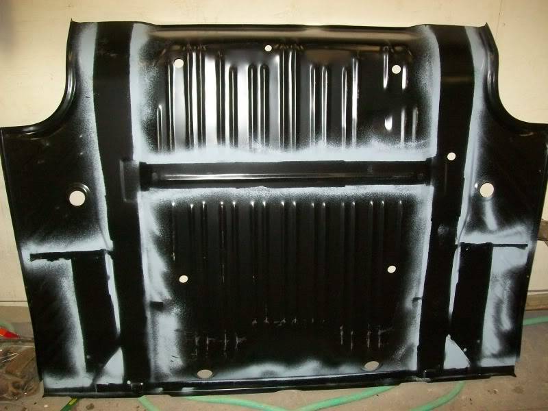

My floor pan (cut) and marked, ready to drill
I did decide to cut it and weld a seam between the 2 wheel wells, it'll be good.
I just have to remember to weld my tank hangers on there before I install it.

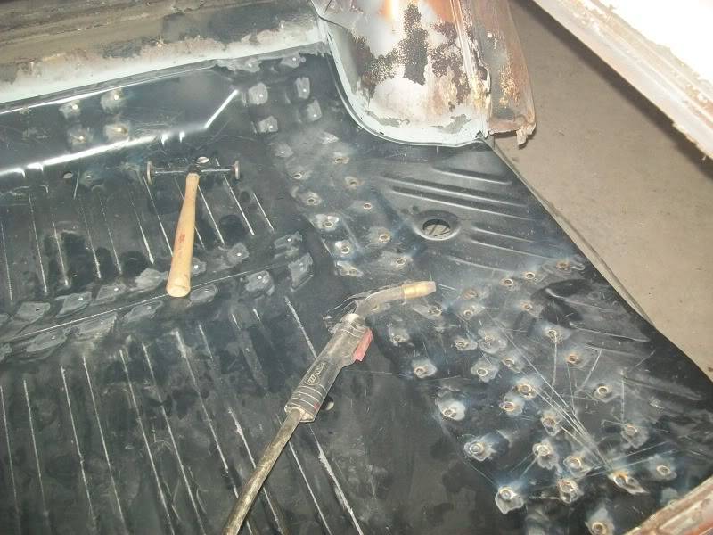

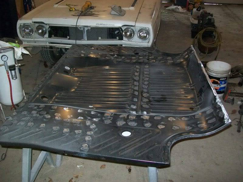

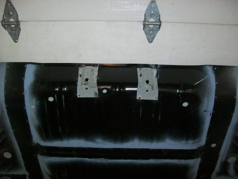

155 holes drilled, ready to start welding.
Gas tank strap mounts get welded on first.
Plug weld every hole with the mig welder.
I was working on the long weld up front, the splice weld when I ran out of shielding gas for the welder, gotta make a run to town.

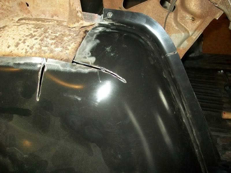

Started with the inner wheel house for LH side.
The new wheel house didn't match the shape of the original for splicing in a half like I planned.
So I cut it, tacked the top, pushed up hard so it lined up on top, then tacked the bottom. The problen is then the top split out, so I tacked a cheap vise grip in there spanning the gap, squeezed it together and tacked it.
Everything all welded up, trunk floor welds ground, starting to shape up.

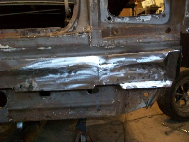

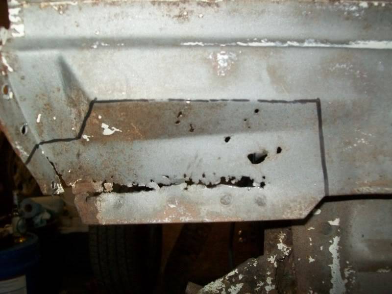

Next I moved on to my rusty tail pan. I decided to save it.
Cut 2 bad spots out of the LH side.
Cut and shaped new patches.
There it is tacked in and I'm holding the old one for comparison.
Continuing...
Both new patches in on the LH side.

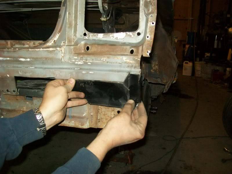

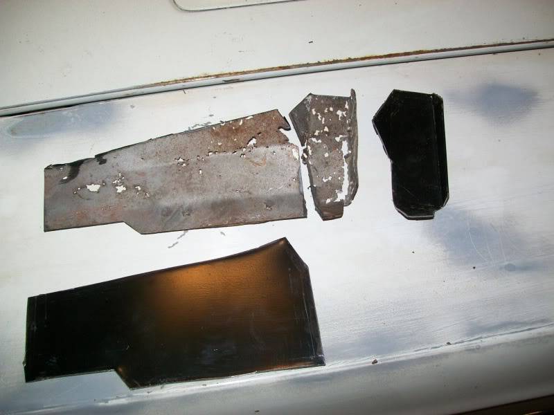

Ok so here are the "pieces" as I chose to cut them from the rusty RH side.
Here's where I cut them from
The first piece of the puzzle coming together.
More pieces coming together.
This is how the first little piece fits in.

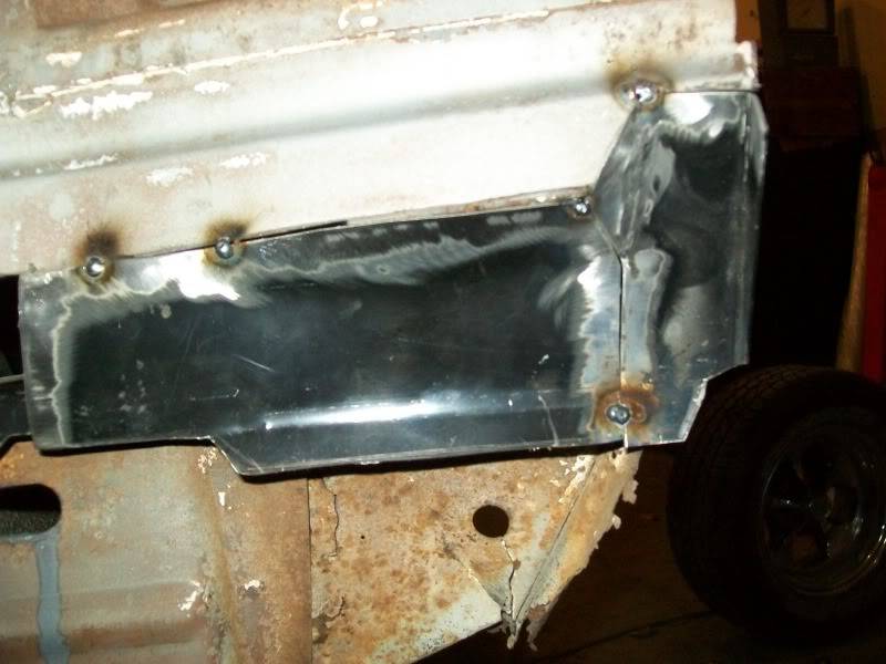

And here are the 2 pieces together that make up the outer end of the tail pan.
Tacked
Welded
And finally spot welded to the trunk floor lip.

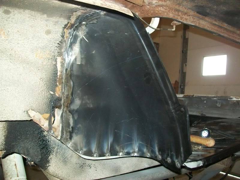

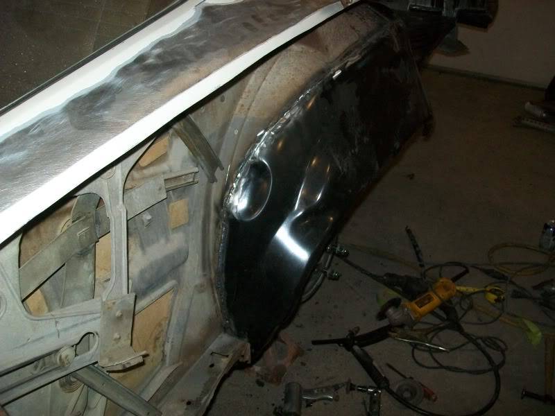

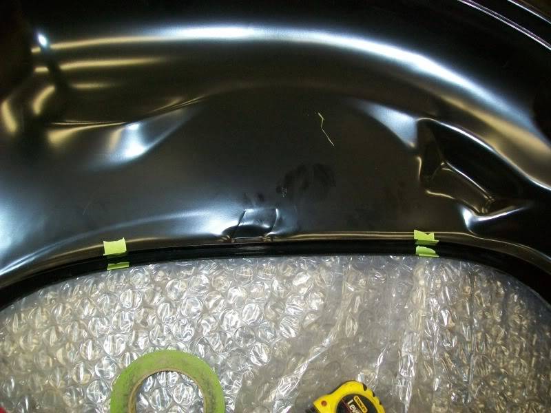

Damn, the LH outer wheel house was kicking my butt tonight. I basically lined it up inside the cut original and traced out the pattern to cut the new one. I cut the new one and tacked it into place. One problem, it measured about a half an inch low for the quarter panel fit up. It had to come up, but when I moved it up it didn't fit up top anymore to the original wheelhouse.
So I had to make some slices to bring the new wheel house down and inward to intersect with the remaining original wheel house.
It did work out in the end.
And a test fit of the quarter skin was perfect.
If I had simply lined up the alignment tab holes, welded and hoped for the best I would have been screwed when i went to hang the quarter skin.
