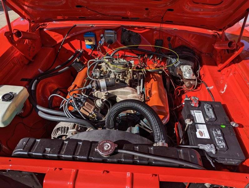

Are you referring to the large hose that I have circled in yellow? It appearst to be connected to the intake manifold behind the carb if I understand correctly. Not the best angle. I don't know how much this matters, but the intake manifold is a Edelbrock manifold - my understanding that is not the original intake so not sure if the original 3/8" nipple was in a different location than the Edelbrock version.
Yes.
Yes looks like it's going to the right place if it's connected to the manifold.
Nipple location is insignificant at this point (stock vs edelbrock)
Maybe it's just me but the vacuum hose for the brake booster looks like it's not hooked up to anything.
Hard to rell from pics where we can't see anything but would be pretty shitty to drive if no vacuum whatsoever
Based on the picture that I just posted circled in yellow, there is a hose from the brake booster that runs behind the carb that looks like it is connected to the manifold. I need to check in person though . Thank you.
I never had an issue plugging my pcv to the base of the carb, and brake booster to an intake runner
First things that any competent mechanic (you don't have one ) will do is compression, leakdown, and vacuum gauge tests. When that's done, come back and tell us. Shooting arrows all over the place gets you nowhere.
I understand what you are saying. I am not trying to solve the whole problem right now per se, right now I was just asking for clarification on the brake booster poster vacuum hose posts.

FYI we are going to move the PCV hose to the front of the carb and also put new plugs. My present mechanic thought that it was connected to the back of the carb and as long as it got vacuum , it would be fine. (He said thought that either way would be fine but going to change it anyway based on communicated recommendations). That is how the setup was when I brought it in.
After talking with the shop , my present mechanic thinks that the carb is "dumping too much fuel" and that is why he thinks that is causing the backfire. He said when he adjusts the carb he is not getting a response better or worse than what he would expect. I asked if he can spray cleaner in it, but he won't clean it - for that I have to do it or take it to someone else. (by the way if that was true, not sure how the backfire could be just on the drivers side but anyway).
Before anyone gets excited, I am just trying to see if I can get it running better because the nearest Mopar expert is 100 miles away from my house that I know of and was hoping to drive it there if possible. I know a Mopar expert needs to see it. The wants me to call him in 3 weeks - he is packed right now.
Why not just take the carb off and find someone to take it apart. You shouldn't have to travel 100 miles away, I wouldn't think.
My mechanic doesn't want to do it as it's outside the scope their shop. They just work on my car on the side.
The guy 100 miles away is a Mopar expert so he can look at from other angles outside of my problem. He was referred to me by someone who was referred to me on this Forum.
As a back up, there is a speed shop a few miles away who could pull the carb but they are not Mopar experts. They are going to call me when they have time to look at. I already sent them pictures. I have them as a second option . This may be all that I need as hopefully my issues aren't serious. What's nice about the Mopar experts is he can look at from a Mopar expert angle and has many replacement parts to swamp in and out to fix the problem or make it better.
As an added challenge the winter in NC is having record high temperatures this year and many more want their muscle car worked on this time of year to get their car ready for the season - mechanics are much busier than normal it appears
