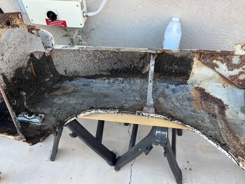

If anyone is trying to remove old road tar or undercoating try this trick.
Buy citric acid paint stripper put a thick coat on the panel put a trash bag or plastic drop cloth over the stripper. Let it sit over night. Take a putty knife and it comes off like butter. Here is my front fender I got started on.

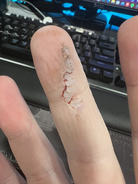

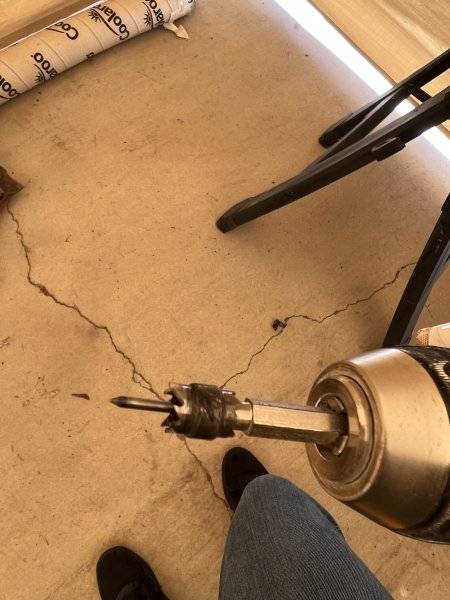

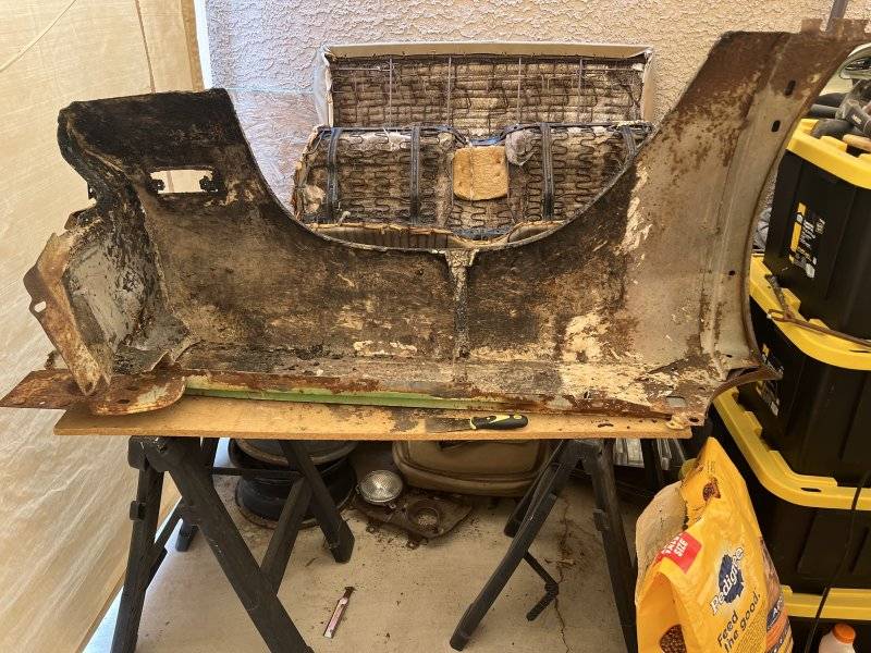

After stripping the under coat off the back side of the fenders I was drilling out the spot welds to take the braces out to blast them and sent the spot drill through my finger little bit of a set back. Since I have finished blasting and restoring the front suspension and K member.
Goal is to blast the front fenders/ core support and engine bay and get some dp90 on it.
oh my :eek:......and we have a special thread for that :poke:
busted knuckle pictures

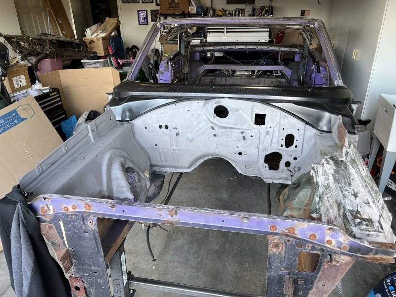

I was able to get some free time over the holiday weekend and started blasting the front half of the car. Ordered the dp90 who knew a gallon is 500.00 now.
Hopefully over Christmas weekends I can finish blasting the front half of the car and get some color on it.
I learned to have paint and undercoat to come off faster slap paint stripper on it before blasting everything comes off quick.
