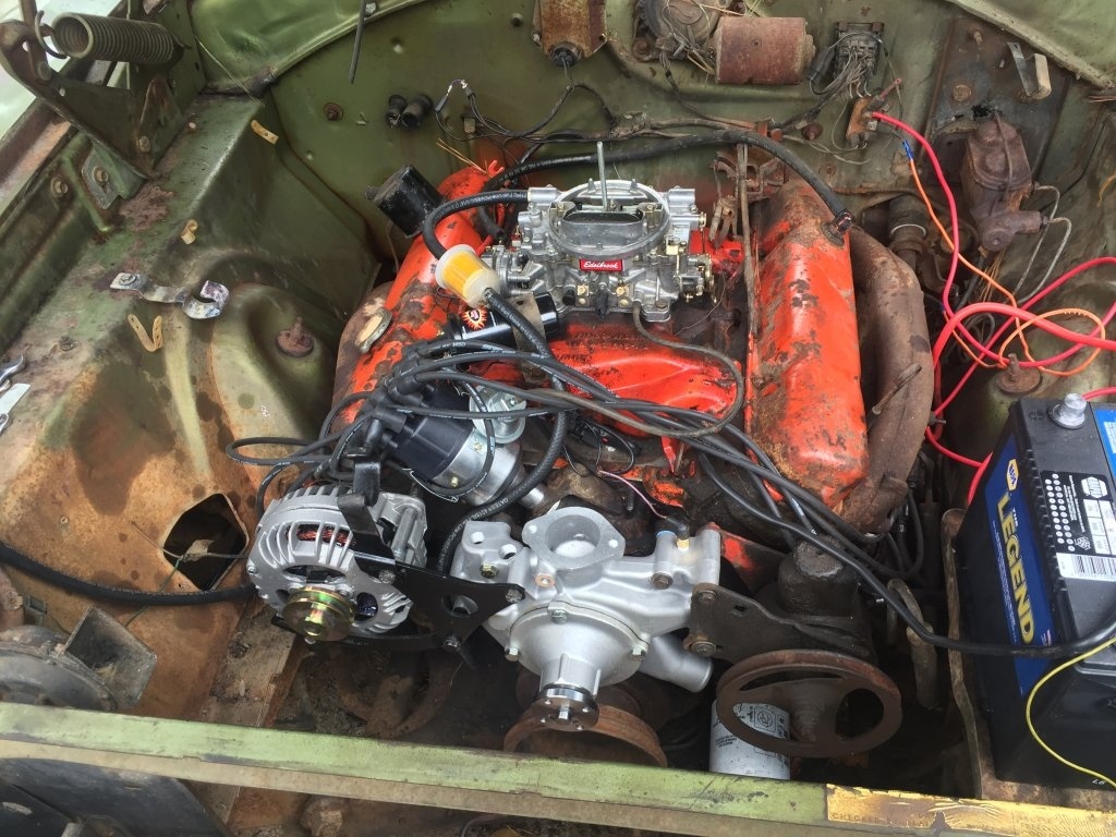

It's alive, No way it was running when parked with the distributor out 180, but went back through everything spun it without plugs let it sit all day (was flooded of course), put new plugs in turned and bam (fire in carb). Backed away, moved timing back a touch and back to life she roared, last tag was in 88. Aside from noisy valves sounds good.
Actually the noisy valves is an exhaust leak past the manifolds, seems super tight. Thanks for the nudge on checking the distributor again. I did all that on the old distributor but got no results.

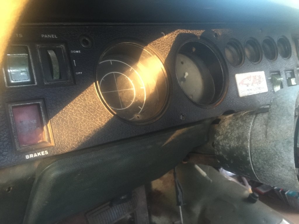

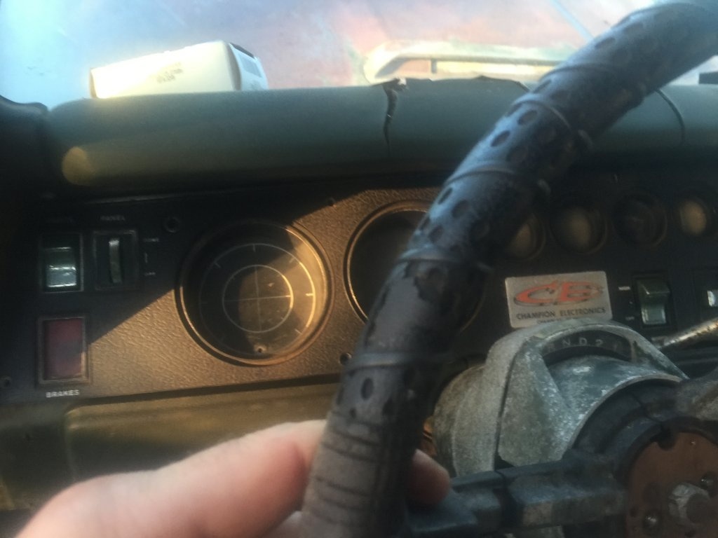

Pulling the cluster out to try and get it operational again, Speedo worked when I tested the tranny. Voltage gauge worked, that was about all I noticed moving.
How common is a clock delete, kinda neat but would have preferred a tic toc tach!

Great to see it running. I'm not sure about the clock delete but I would say the tach/clock is somewhat less common. As for your gauges, there is an instrument panel voltage regulator that works the fuel and coolant. Check your grounds real good. Cluster needs to be grounded on the dash frame, frame to chassis, etc. This is a common issue for about every 60's era Mopar.
My 70 had the same cluster...I agree with threewood, the tick tock tach seems to be more rare...
Interesting on the clock, I did not think it was special to not have it just odd.

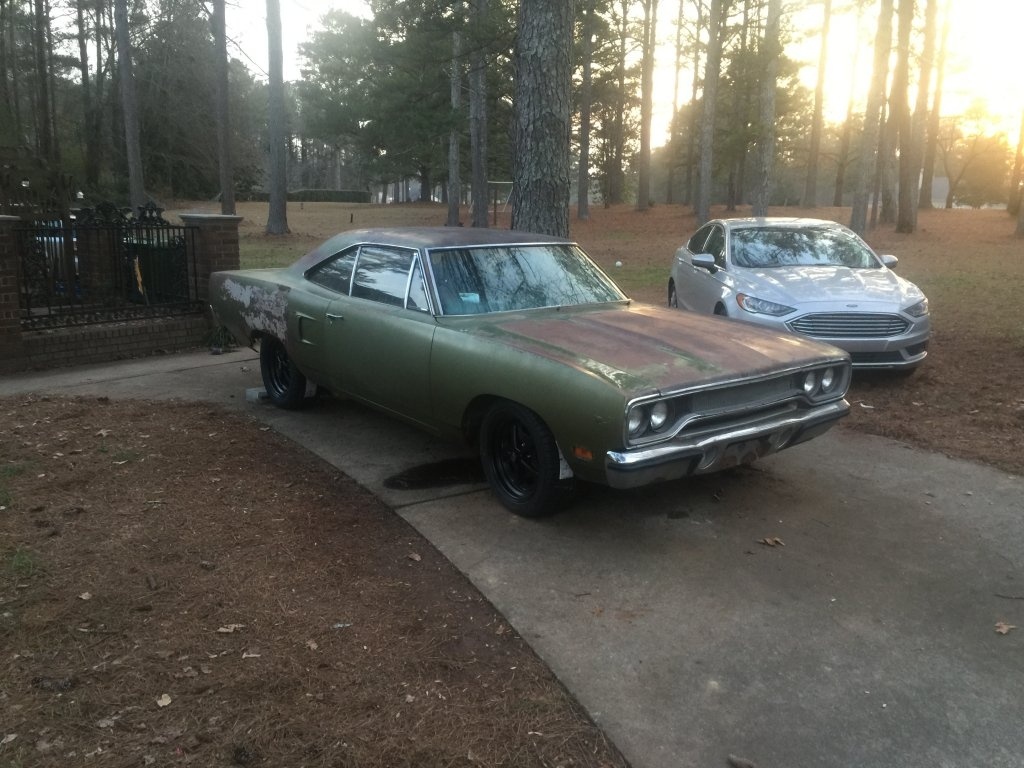

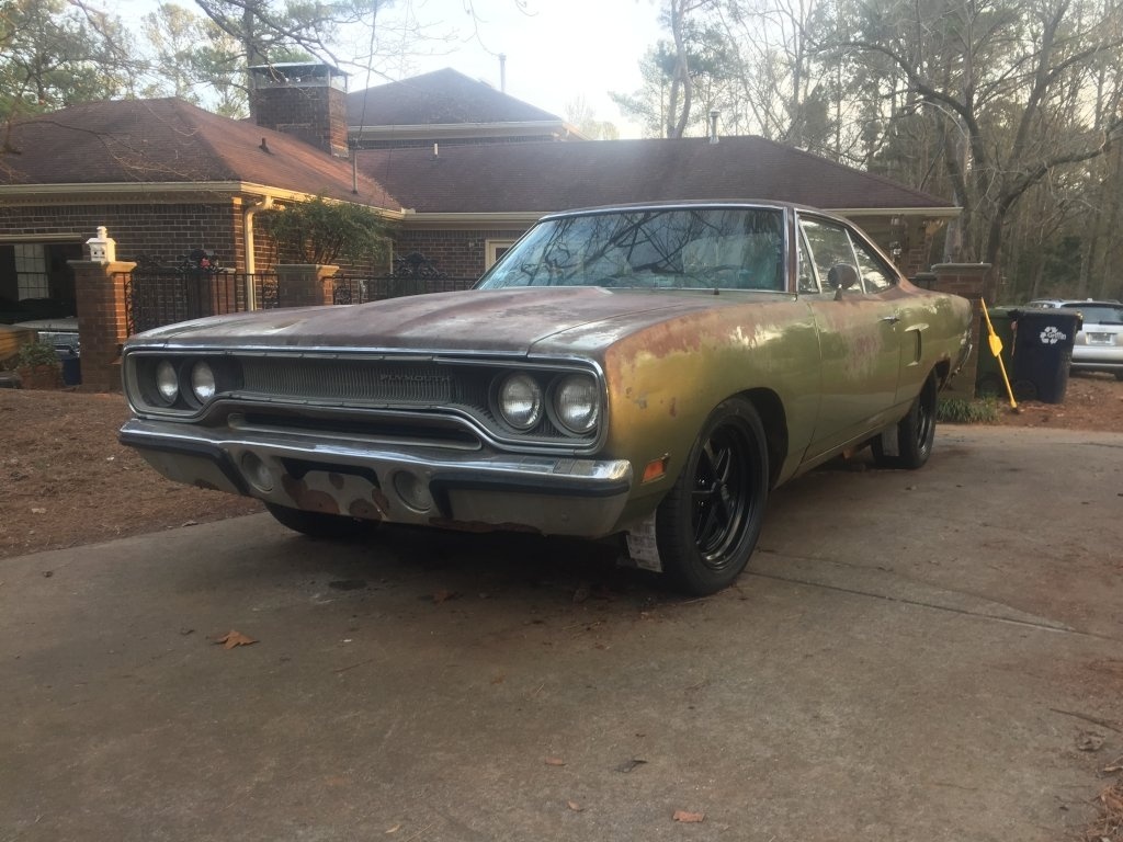

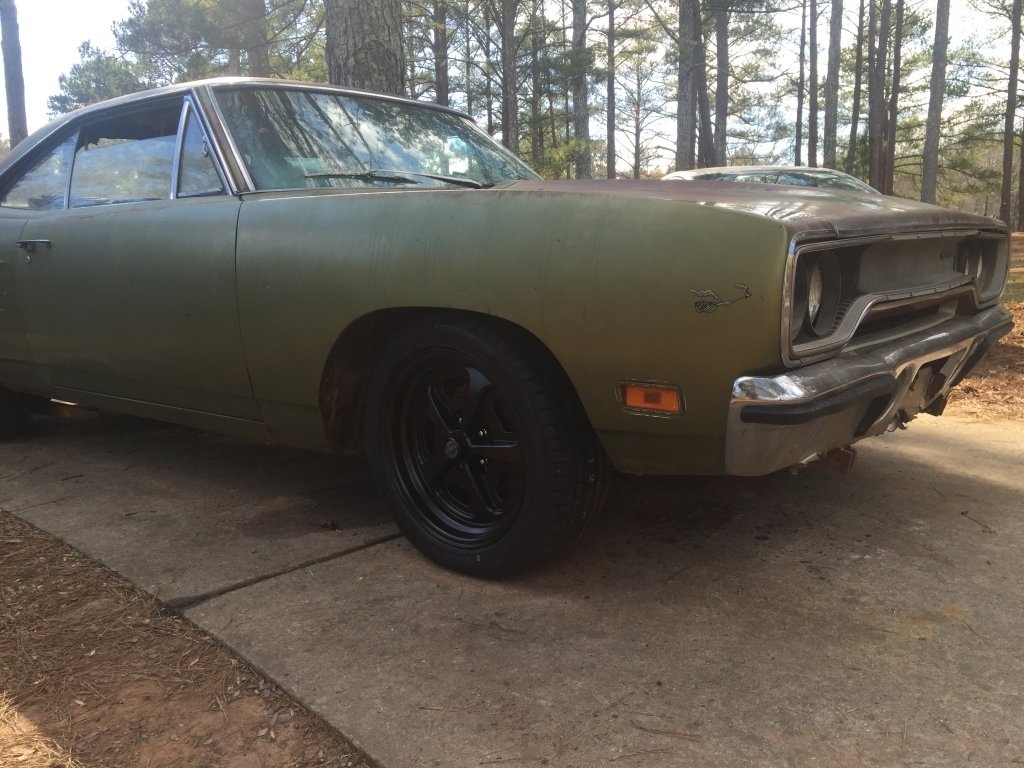

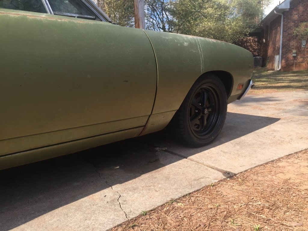

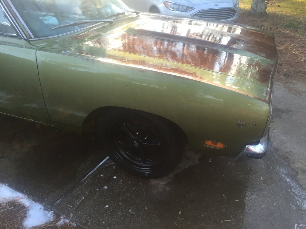

May not make the purist happy but I want to try something different on this one. New wheels arriving two at a time. About to place brake orders and metal order.

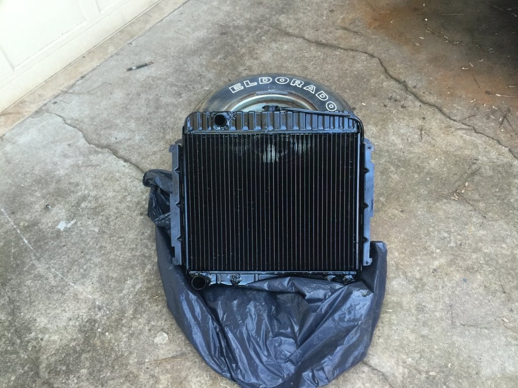

Got the radiator re-cored today thanks to some input from you guys on here.

Not sure about the black wheels, however, love what you're doing to the car!
Thanks and I know they may not be what everyone likes. I wanted Black 15 OEM wheels anyway but saw these on a Challenger and wanted to try them. Wife said they looked sexy so I feel like I won one over!

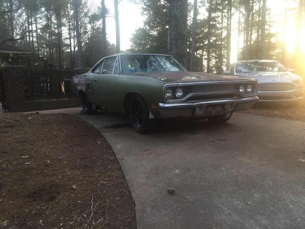

Like a Kid I am putting parts on as soon as they come in, even though parts are missing still.

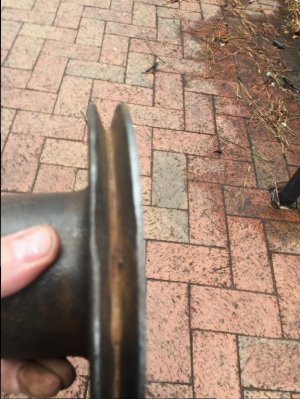

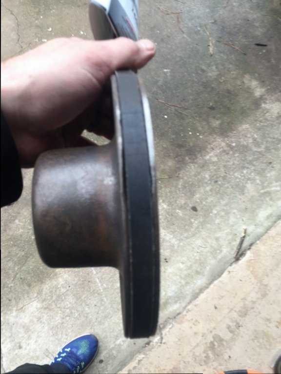

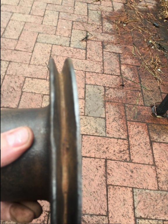

It's actually not bent, the low spot is a rust spot that was cleaned up.

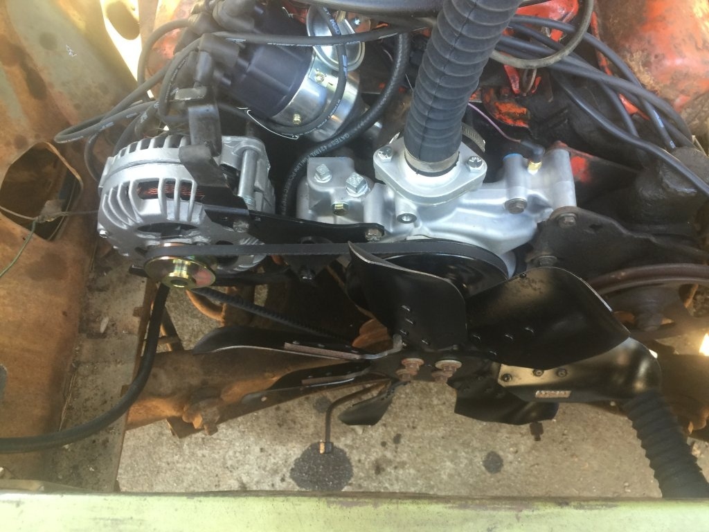

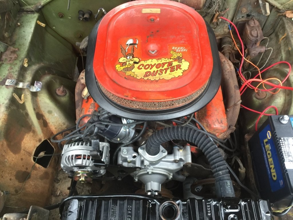

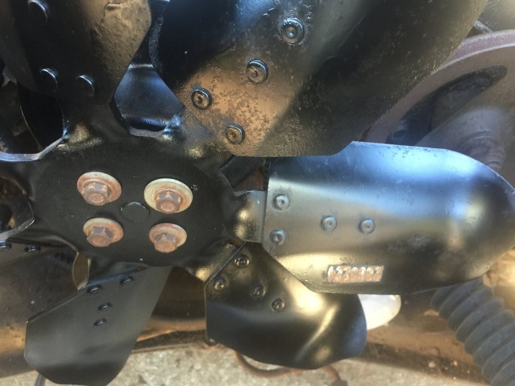

Ran the engine up to temp today, dash temp gauge does not work so will be pulling the cluster out, car is charging with the new alternator and no leaks so far, nor funky noises. Will still need to fine tune carb and timing. Back wheels came in today as well so now it is not sitting on flats(neither is the 69 it got the only good two tires off this one).
