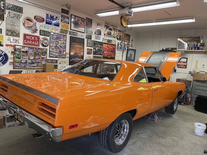

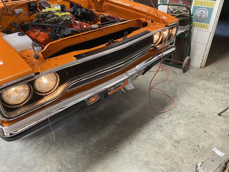

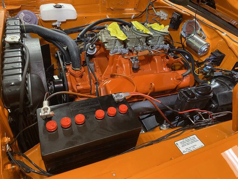

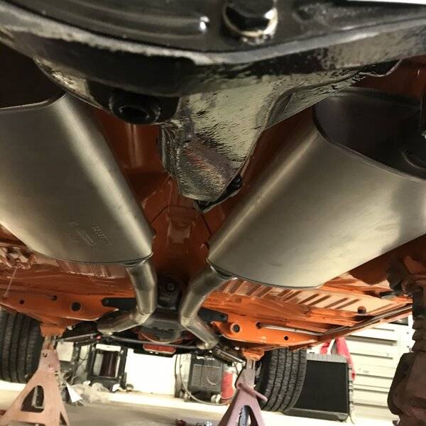

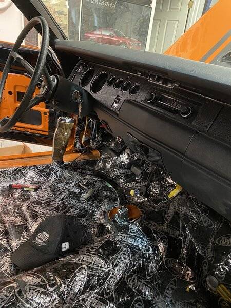

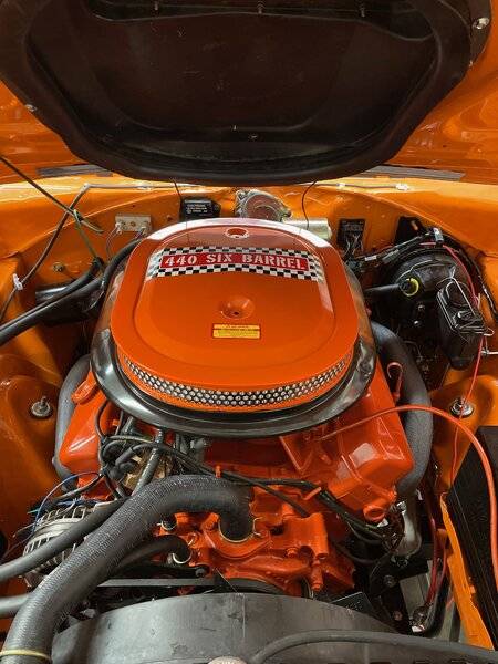

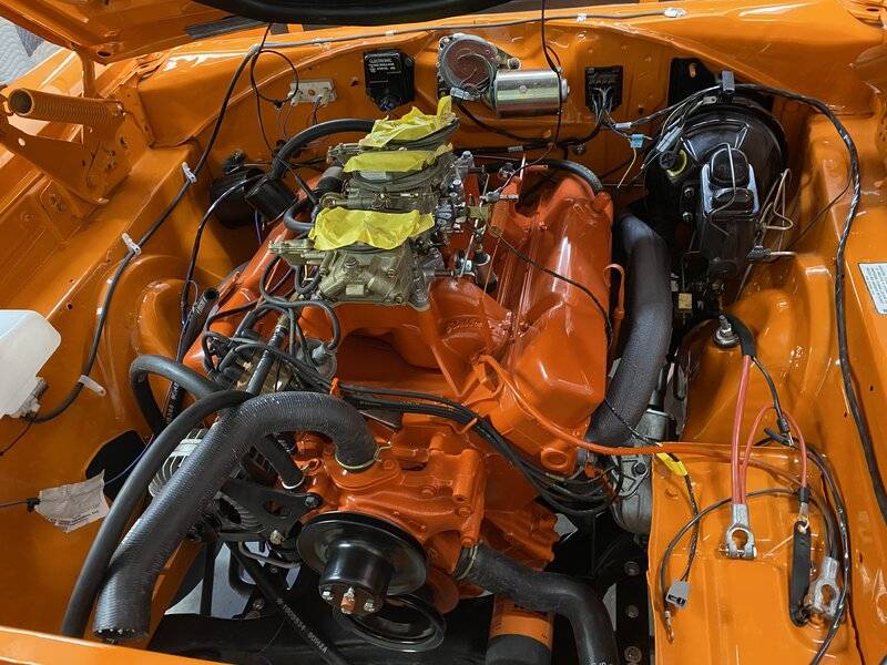

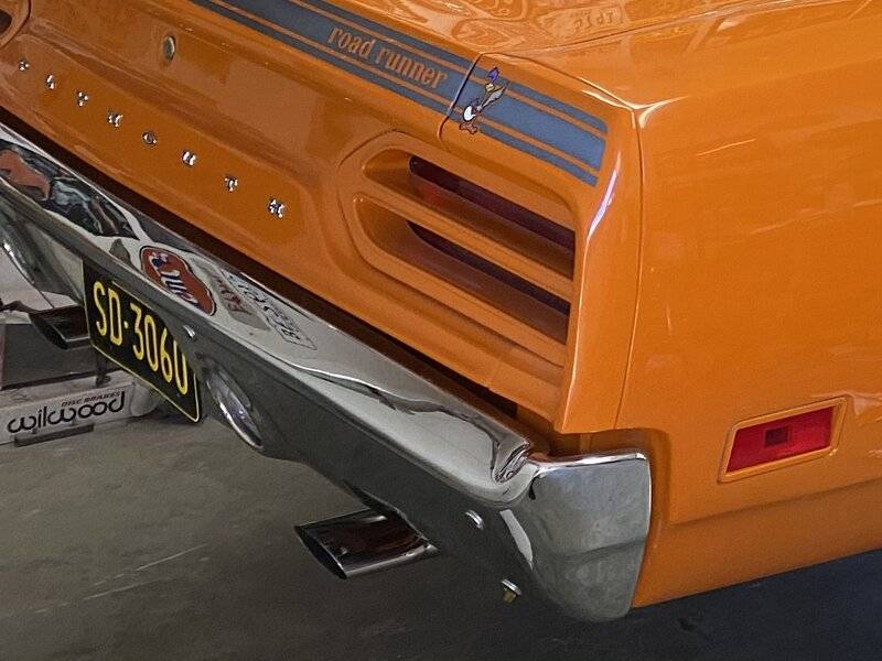

SUPER, SUPER, SUPER!It’s alive........Stopped this morning and picked up 10 gallons of non ethanol 93 before heading over to the shop. After a couple of weeks wiring everything up and getting a few other things wrapped up it was the big day. Installed battery, filled radiator and put a little fuel in the center carburetor. On the third cranking attempt she woke back up from her slumber. All my gauges seem to be reading correct, but have a few lighting issues to work out. Couldn’t be happier and I need a bit of Garage Joy after this last week

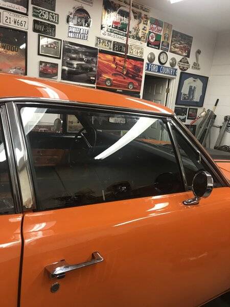

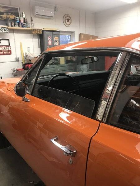

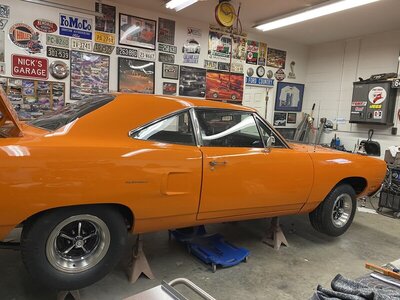

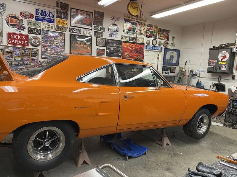

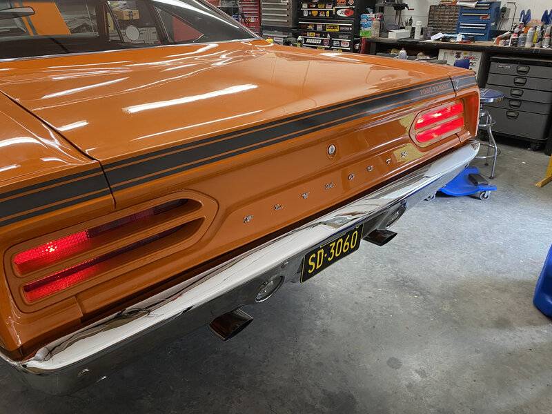

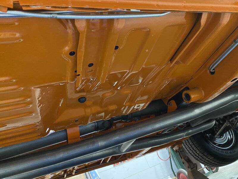

The door glass is finally installed and a few other small things done. The passenger side is adjusted, but still tweaking the drivers side a bit. The new felts in the channels made the roll up/down really tight.

If you used reproduction plastic sliders on the felt between the window and vent frame, they are too big and make the window hard to roll up/down. Re-using the old sliders with new felt is the way to go.
