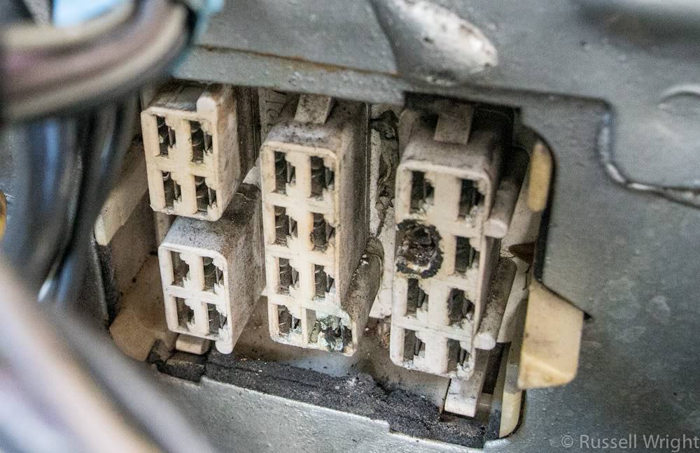

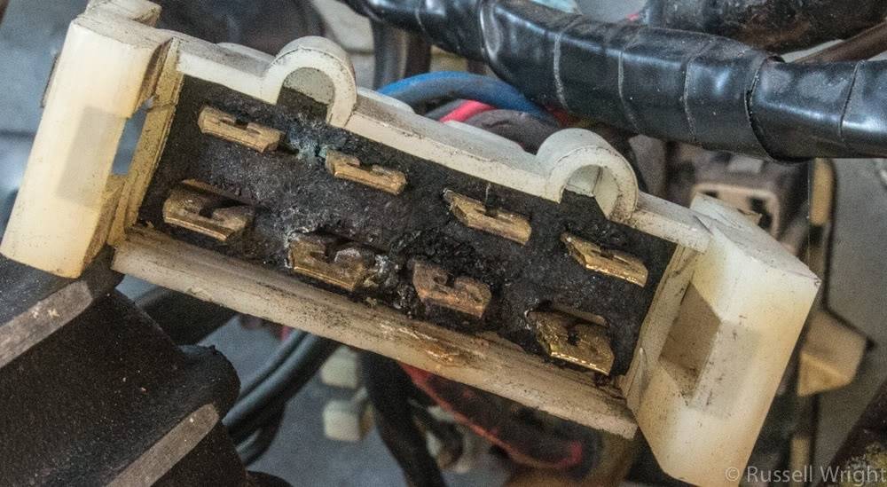

I'm confused by your description as "decaying". Could they be oxidized or is the plastic bulkhead connector burnt from overheating? Oxidation is an easy fix. Overheating is the result of another problem.
Oddly enough, mine (not pictured) was in great condition for a 48 year old survivor. I consider myself extremely lucky.

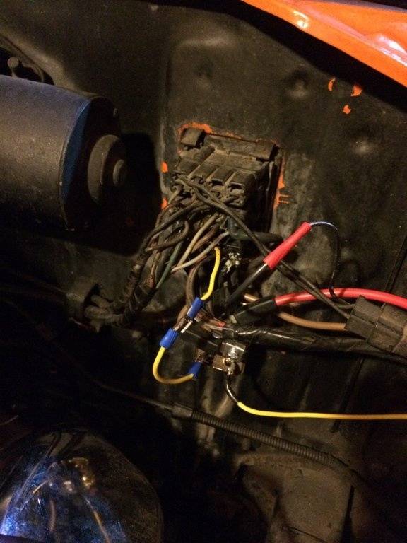

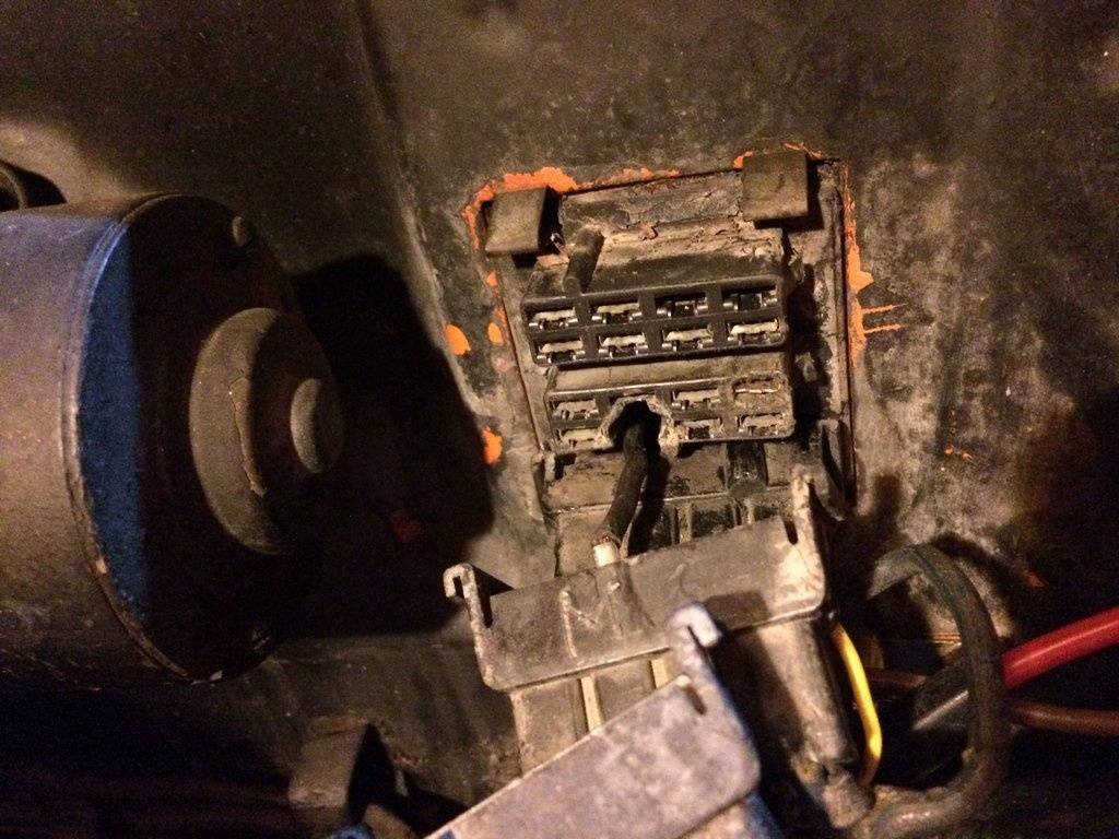

Thanks for your photo. Mine do not look terrible but the port on the firewall that the large blue fuseable link wire that comes from the starter relay into the firewall dash plug looks rough. The port for it on the firewall from the dash side is so decayed like that the metal port is almost gone, like it just decayed to dust over time. What bothers me more is that some previous owner (unknown who) in the past drilled a large hole through the middle firewall plug and put an aftermarket wire and plug straight through the factory plug to connect with the center engine wire harness. I followed this wire under the dash and it is just tied into a wire from the dash harness that was clearly cut open and tied into a wire under the steering wheel shaft, not in a factory related way. Overall its not terrible but my awesome RR is not starting due to no power at all to the ignition more and more often. This started only once and a while and is now happening 75 percent of the time I try to start it. every time this happens I have to unplug the engine wire harness, kind of blow on it or spray cleaner on it, then wiggle back into the firewall as best as possible and the car starts great. Then 20 minutes later wont start again so clearly time to replace it all due to decay and someone hacking it up a little. So due to this I do not want to hack up the factory plugs further, I am ordering all new wire harness from YearOne with a 30 percent off code they just sent me after I placed a small order a few days ago. This means I can get all new harnesses including: front light harness, engine harness, rear light harness, and complete dash interior harness that are all totaling about 900, after the 30 percent off code they sent me all comes out to 650 which is awesome price for entire new wiring bumper to bumper

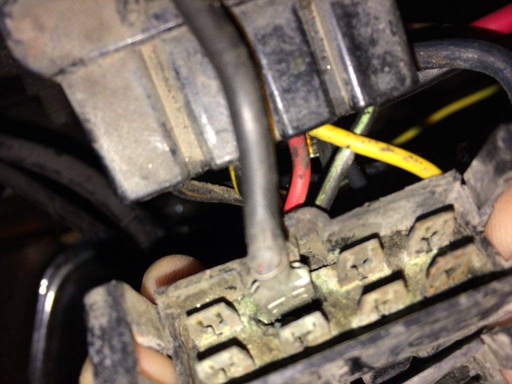

So just took photos of mine, when I started having electrical no power issues I noticed the green in color neutral safety switch wire that runs from the clutch pedal area to the starter relay, the green wire part that plugs into the starter relay was falling apart and the wire was hanging on by a hair sized thread. Then noticed the yellow wire from the motor wire harness plug that goes to the starter relay was also falling apart and hanging on by a tiny thread right at the plug. Then days later when I opened it up found someone drilled through the firewall plug to hack into it, so I think best at this point to replace it all myself slowly and efficiently over the winter.
