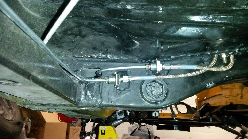

So I had a couple days off and had to rush finishing the brake lines so I can get the motor in, so I have room on the floor for my wifes motor and tranny for her duster. I never had so many leaks in my entire life I think I bent and flared every line to the rear diff at least 3 times. Plus dumped about 2 bottles of brake fluid all on the fender and on me. I was not happy. I found out that if you use the longer fittings they seem to help.

Run the brake lines so they clear the torsion bar hole in case of removal:
And you got the worlds first Hydraulic ebrake pistol grip! Cool part now is my car will have both the 71 short shift and the 71 bench seat shifter in one car!

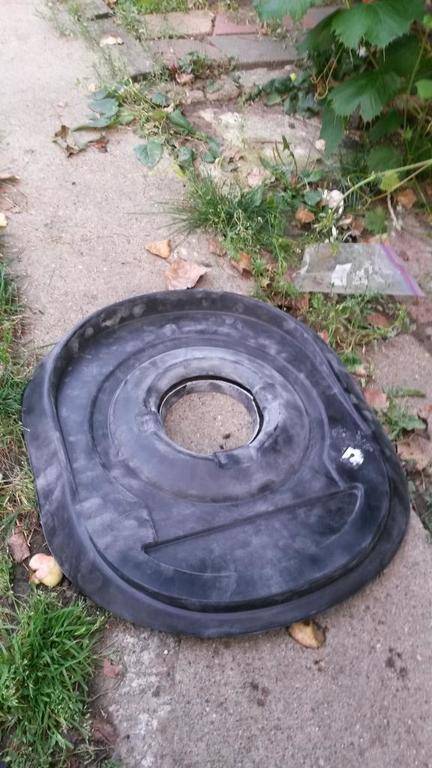

Sorry for the long wait guys, I have 5 things on the go and was waiting for it all to be finished before I post them - here' s one project that I recently finished: A airgrabber on a RPM intake that actually fits under the hood, another guy tried this on roadrunnernest.com where he cut just enough and cheat it slightly but the hood really pressed down on the intake, I wanted something that was a perfect fit, I bought this base from YearOne, its a cheap fiberglass base that you don't have to worry about cutting into it, and it feels significantly lighter compared to the steel OEM base. I may weight it later to see the weight savings...
cut the hole i wanted - wanted to get it as low as possible so I have no issues:
My QFT carb has two screws on the car that were preventing it from going lower, the nuts are just the size i need to putty over

sand, paint, put her on - a perfect fit!!
