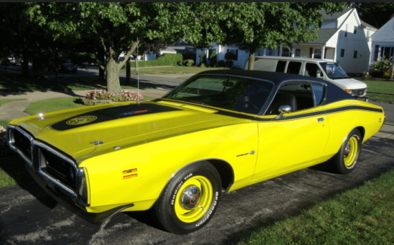

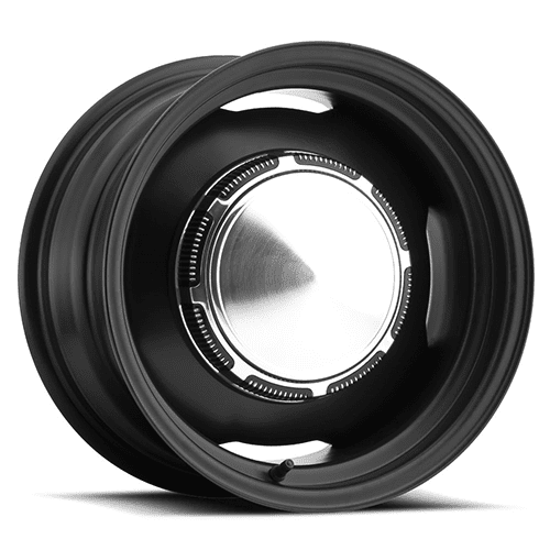

Body colored 15x7 steelies with dog dishes look great.
I had them on my 71 Challenger. But never owned a 71 with Rallye wheels and dark gray center caps like I have now, but they are 14x6 and two of them have damage. I like the Rallye/dark gray combination. Unfortunately, I haven’t been able to find a set of four 15x7 Rallye wheels available to buy, vintage or reproduction..

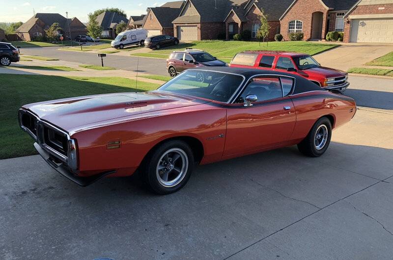

My Bee
15 X 8 Rear 275/60 15
15 X 7 Front 245/60 15
Only thing I don’t like is no one makes a decent 15 X 8 Trim Ring for the rear that fills the gap correctly
