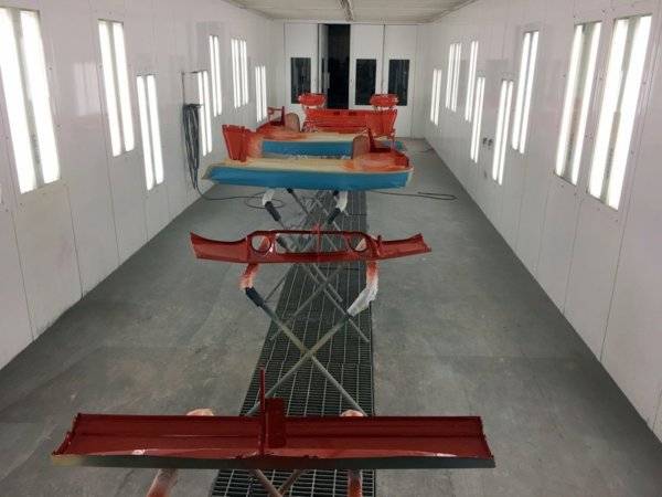

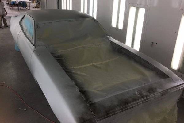

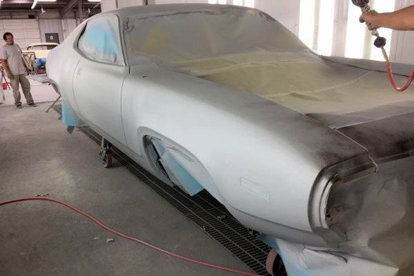

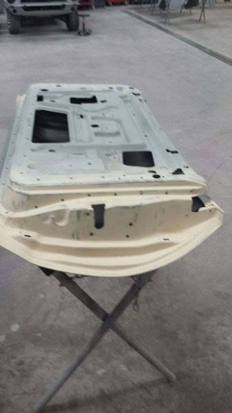

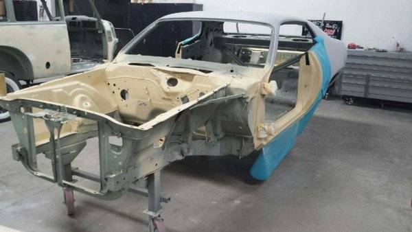

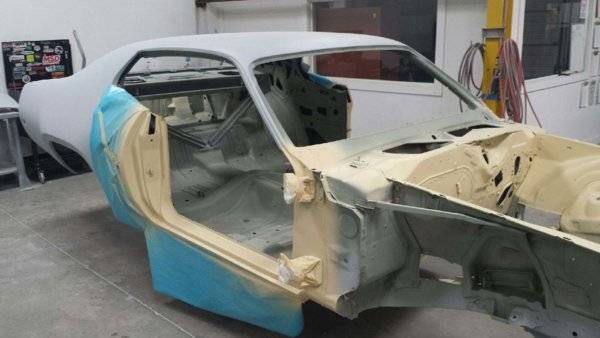

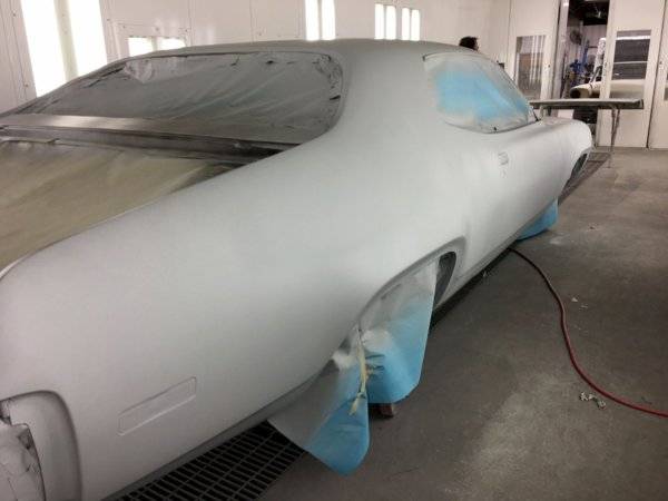

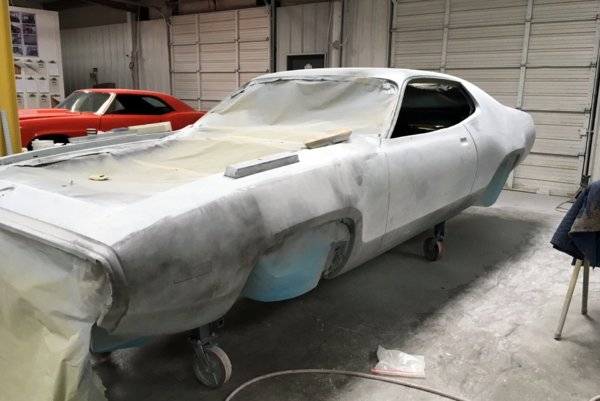

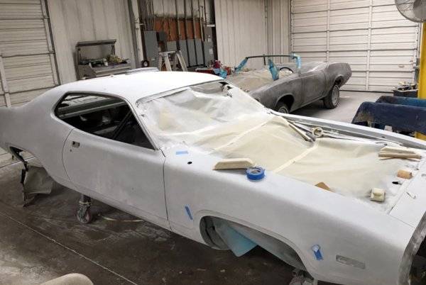

Here are some updated pictures of the bird. Like Justin said, it's getting very close to paint. It's so hard not to want it done now but the wait is well worth it. I just keep thinking about where it would or what kind of condition it would be in if it was still at the previous place:

I was over at Triple F this AM and took a peek at your bird....Man it looks Great!

Ah man, we must have just missed you! We were there around 11:30. All if the jambs will be painted this week. They have done a great job!

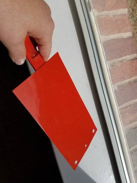

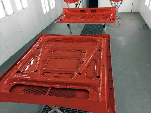

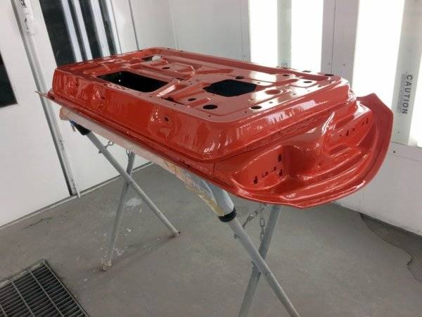

Here is the color it will be painted. I didn't know until this week that Torred has a small amount of metal flake in it. I really like it a lot.

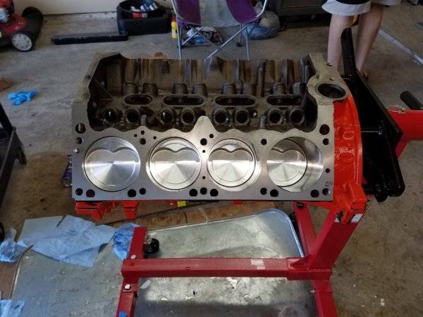

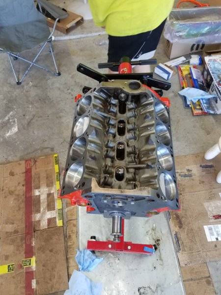

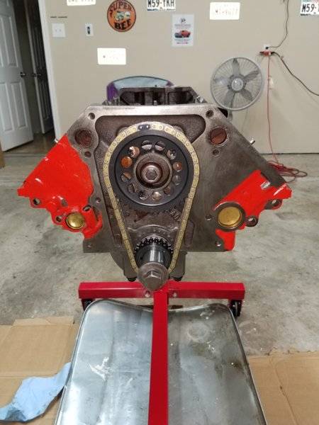

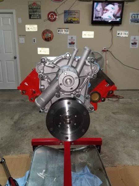

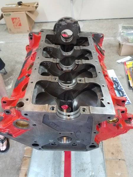

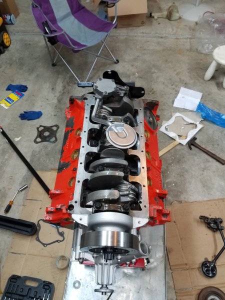

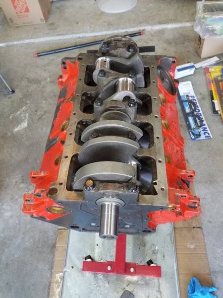

Since I am updating the body pics, I will go ahead and update the engine build as well. My dad came down last weekend and helped me put the short block together. To say it was challenging is an understatement. Everything that could go wrong did go wrong:
First, I put 6 connecting rods on backwards not realizing the chamfers have to face outwards (dumb rookie mistake). So my dad and I painfully took the spiral lock pins out and switched them around. Those little bastards do their job well. Those spiral locks dont like coming out! Thankfully I looked it up before we installed them because my spider sense was saying I was doing it wrong.
Second, we got 2 pistons in and when I went to crank it over, the connecting rod bolts hit the cylinder wall. The new H beams were just slightly to big. I knew I wanted I beams but was talked into the H beams and I had forgotten about the clearance issue from my previous research. So we broke it back down, I taped the engine up and I notched the block. I cleaned up the metal shavings, and put her back together to find out I didn't clear #8 enough so I did all again again.
Third, we go to install the roller cam and it will not seat in the rear cap all the way. We research it and it could be anything from a tight cap to core shift. Probably not the best idea but I over oiled all of the bearings, cap, and cam got it in as far as I could, slightly rotated in the bearings and she popped right in and turned as it should. Was probably risky but I took the chance. If she hadn't turned I would have been up poop creek with out a paddle.
Fast forward to this weekend and I could not get the harmonic balancer to go on (I'm another thread here). I found out that most new balancer are made on smaller side of tolerances while my scat crank is on the larger side. I ended up using a little Emory cloth on the balancer and was able to get it on. Probably not the "right" way but I got er done. I am thinking I am finally out of the woods and BAM, I get the next curve ball. My oil pump won't fit because the ARP main bolts are higher than stock and the one under the pump sits to high. So I research this and find out it is a super common issue with molar small blocks. Most people either shave the bolt down and don't use the washer, mill the main cap, or they just use a factory bolt under the oil pump. I chose the latter because it's the easiest. By the way, it looks like they don't make any oil pumps that will clear this either. That is where I am at right now and tomorrow, hopefully it will be a bit smoother. Thank the Lord I live 5 minutes away from the new Summitt facility. Makes life much easier!
Last but not least, I have great respect for you guys who pioneered the way before the days of the internet. I can not image how hard it was for you to learn the craft with out the resources available online line and the lack of parts availability or locating them. Thank you all for freely sharing your knowledge now and helping a noob like myself. This makes the hobby fun and while I am not well versed, I enjoy sharing my journey with you guys.
Sorry for the novel guys! I hope that this post will help the next guy who is new to building and can use my mistakes so they don't make them.
I am an early bird I was there when they opened and left around 10ish....
Had to BS about cars with Steve before I left....when we get talking it seems to never stop...but thats hobbyists for ya...
Steve asked me about that when I was there and it does have a little metallic in it....One of the best Mopar colors. Especially, for that body style...
Yeah...those new balancers can be tight.....Sometimes you can bake em and they will slide on..
Btw not sure if you need it but I have the oil filter turn down for a small block....

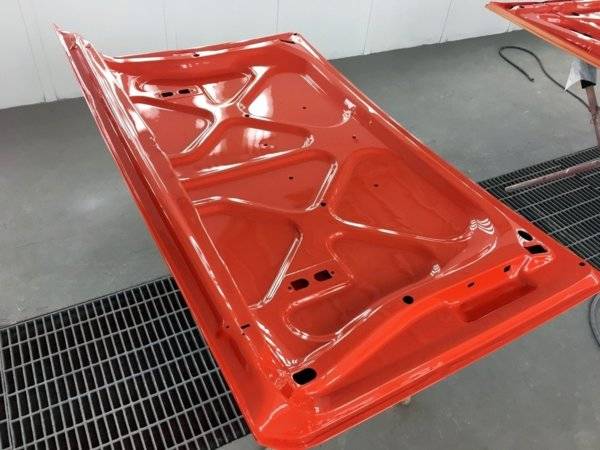

The day is finally here!!! She has some orange paint on her! I have had so many ups and downs through this project and to see paint on her for the first time is just so flippin awesome. I have not had a chance to see it in person yet but will update later this week once I get to the shop.
