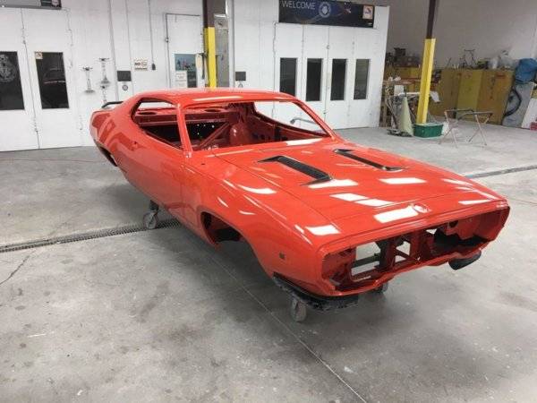

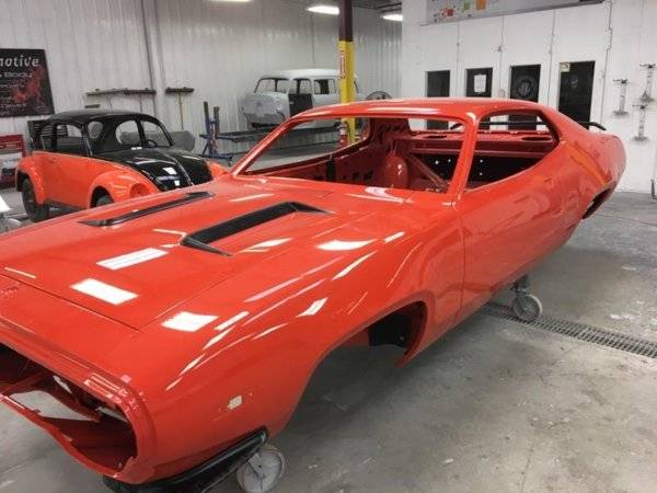

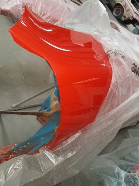

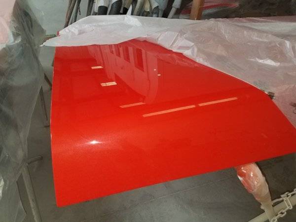

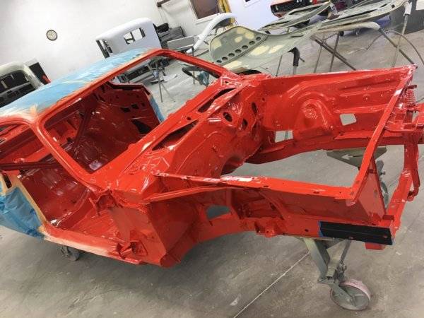

4 full months to the day. They got it July 2nd. Dang quick!

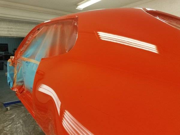

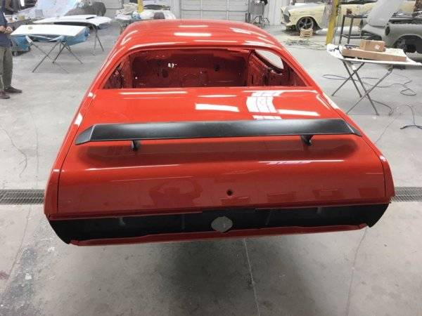

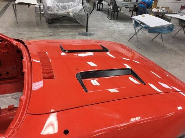

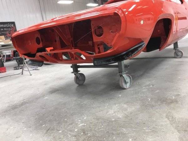

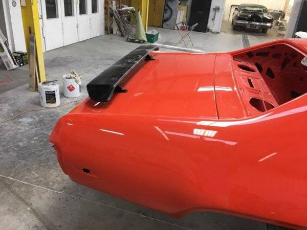

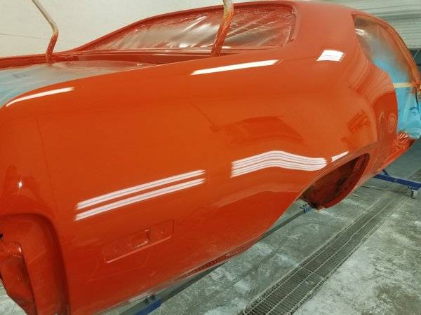

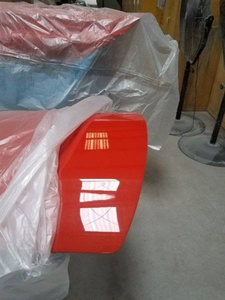

Steve shot me these pictures this morning. It still hasn't sunk in that it's actually at paint now, mainly because I have been fighting issue after issue with the engine build. Still extremely excited though.
View attachment 535057 View attachment 535058
I know what you have been through with this build and I know your in a state of euphoria but man it looks great...
There are only a few shops in the states that can meet or beat committed time frames. That is very commendable for Triple F....

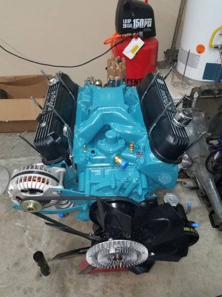

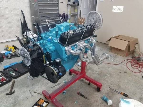

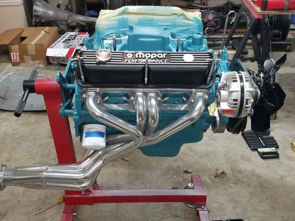

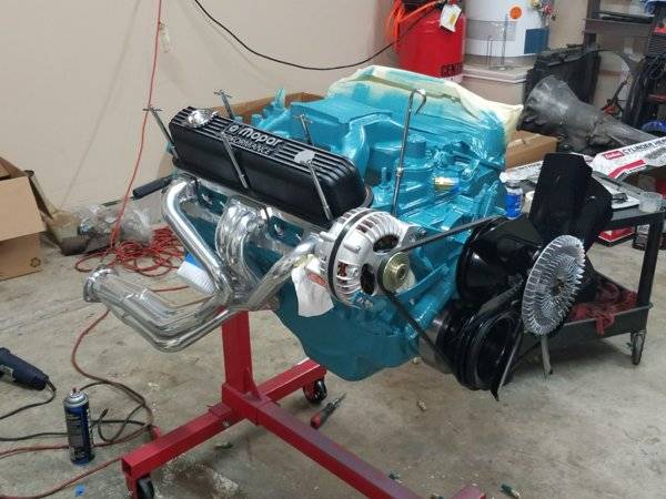

I have been really busy working on the engine... and reworking on the engine.... oh and reworking on the engine due to my rookie mistakes. However, the engine is finally coming together and its pretty close to being ready to go back into the car. I may get the carb this weekend if time allows. Speaking of carbs, I am have not completely decided what size I should get. Do you guys think an 850 holley double pump will be to much for a full roller 416 with slightly worked aluminum heads and a pretty steep cam? I am open to all suggestions!
Most importantly, here are a few pictures of the engine:
View attachment 545458 View attachment 545459

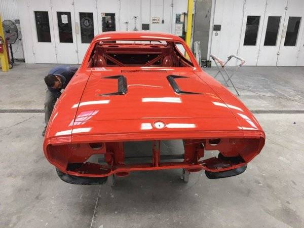

Steve and the team are putting it back together this week and then they will put the glass back in along with decals. Probably will be the first of the year before I get it home due to the holidays. I don't have any pictures of the car back together but here are some teasers in the mean time :)
On another note, I am finally putting the finishing touches to the engine. Finding all of the connectors for the intake and valve covers have proven to be a bit of a challenge but I got it done now. The pcv was surprisingly the hardest thing to track down.
My wife has also gotten in the Christmas spirit and is officially a mopar woman. It's kind of hard to see in the pictures but she made little nativity scenes using mopars and surprised me with them. I loved it of course. And took a couple to work with me. Very creative idea.
It looks to me that the valve covers on your engine are on the wrong sides.
Thanks, I was not sure what side the PCV valve went on and the pictures I saw online looked like the passenger side. I will switch them out tonight when I get home. I wanted the filler hole up front to so this makes it perfect.
Just out of curiosity, would it have hurt the engine if it was on backwards or not work properly?
Thanks again!

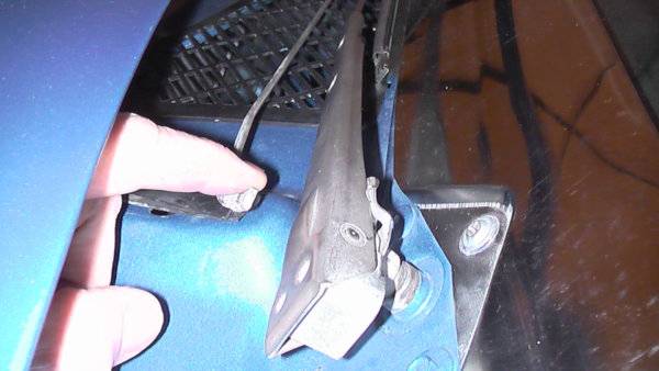

Hey did you ever get the drivers side wiper arm figured out ? I face with the same problem to.Thanks.
Big update! The Car has been reassembled and will soon be ready to come home. It just needs the decals applied and the glass put in and it will be ready for reassembly. It's so hard to believe I am finally to this point. Here are some pictures for your viewing pleasure:
Well i DID,IF YOU GO TO FOR A BODIES only,go to body and trim see my post wiper arm,snake is my use name there clearly you will see.
