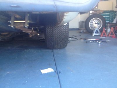

Absolutely Go All The Way Or Go Home:

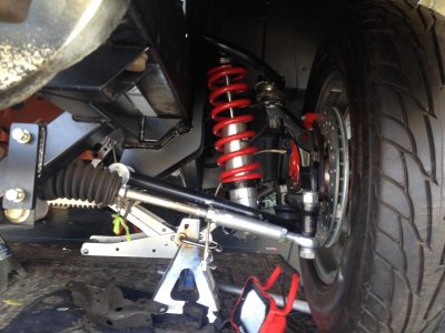

RMS Front Suspension. rack and pinon, coil overs,Tubular upper and lower control arm
Wilwood Brakes

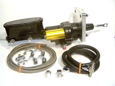

Hydro boost Brake system

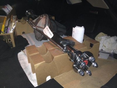

Just Got The Dana 60

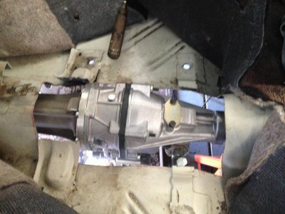

Gear Vendor Over Drive

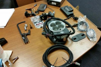

EZ EFI - Soon To Be !
image.jpgimage.jpgimage.jpgimage.jpgimage.jpgimage.jpgimage.jpgMopar Hydroboost.jpg
